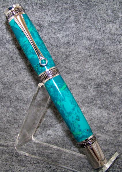

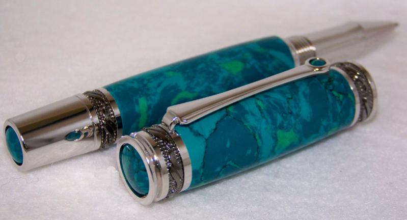

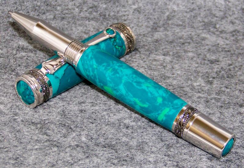

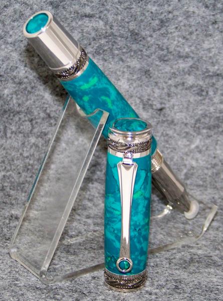

Here is the sequal to that ever so popular Majestic FP I made a couple weeks ago for Hans. I had to see if it wasn't a fluke that I was able to make it in the first place. Well...it was no fluke. This time around I used a much more difficult blank to work with and made it a RB. It's a Chrysocolla TruStone from R&B Crafts. Let me just say that this stuff was a pain to work with!!! I don't have one of those carbide tip tools but man I am getting one SOON. I was able to get all the pieces out of a single blank again, and this time I actually had about 1/4" of blank left (massive compared to the last pen). I was lucky with getting the pimp crystal out this time bc they glued it in crooked so I could get my dental pick under it easily. Dunno what I'll do with the ugly thing but I'll think of something. The end finial was a bit harder this time around bc they changed how they inlay the accent piece. On this one you can't knock it out with a transfer punch bc it's solid on the inside. Instead I carefully drilled it out till it came loose with no issues. Applied my usual finishing steps of MM to 12000, Buffed with Tripoli and White Diamond, and polished with PlastX. Thanks for looking and any and all comments/critiques/questions appreciated!

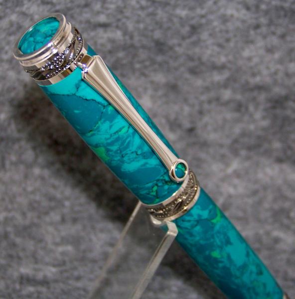

Didn't you just get married? You must have better things to do with your time than make pens. Or maybe not. Anyway, Good job on the trustone. I gotta ask though, how deep are the recesses for the stock finials, and did you have enough material to have made them come up flush on the edges? Or did you inset them a little for a reason?
Nice job, but the inner faces around the finials showing looks a little odd to me.

It looks really good but I too wondered about the recess depth looks slightly deep. I like the classy look to this pen

I'm waiting to see someone else try this out. As far as the recesses go, they are slightly undersized. When trying to get it all out of one blank you really only get 1 chance to do it right. I was trying to not have them bulgy. I think the pictures make them look more recessed than they really are though. Making these mods have started a brainstorm for me and over the next few days I'm gonna try some clip mods out just to see how they look and then incorporate it into a overall pen design. Oh, and for just getting married...my wife does alot of work with horses during the day so I have a good bit of available shop time :wink:
