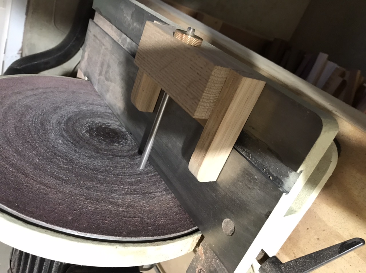

Well I built my own jig to hold the blank square. I used a pen mandrel and I have a set of sleeves that I bought from a Pen State. Here's a few pictures if it. It's important that it is perfectly square in all directions.

Well I didn't say it was hard to setup. I think my pictures prove that my jig is square, my finished pens have no gaps. Sandpaper on a faceplate works well, I stated that as well. No method is foolproof. If you do the faceplate method with a slightly bent punch, you won't get a good result. I was simply explaining how I do it.

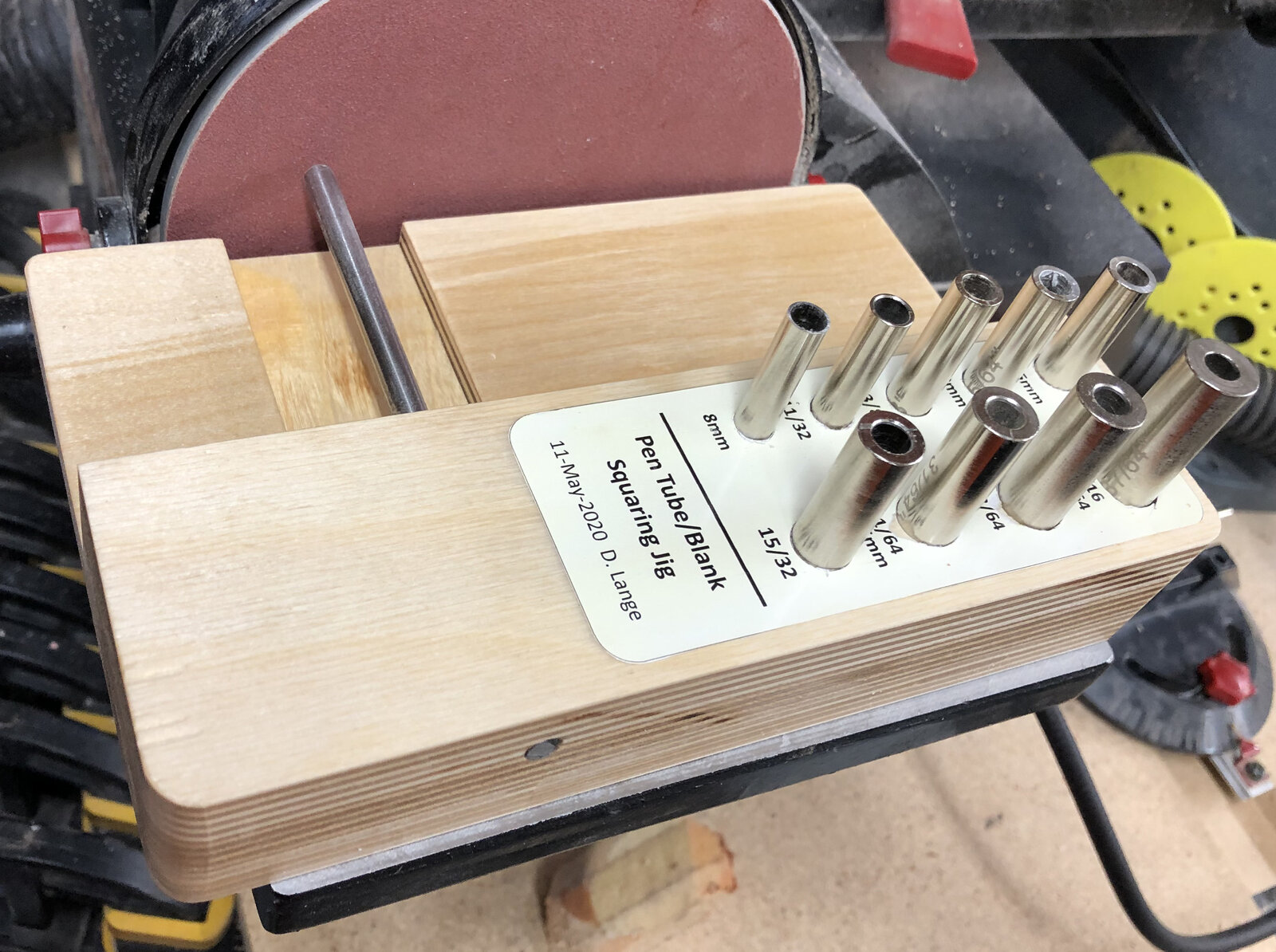

I can't say what is best, but this is what I use and how I got there.
I started out with a standard set of pen mills, similar to the Ultra Shear, then upgraded to one with carbide cutters very similar to the Ultra Shear, with a full set of reamers, one for each size of tube. They taught me a lot - mostly that using a reamer and pen mill was not the best option (for me anyway). No matter how careful I was I occasionally tore up the end grain of a blank with the mill. I suppose it could have been the operator, but I just think that certain woods are just more susceptible to problems when cutting across their end grain.
I already had a Craftsman 6-inch disk / 4-inch belt sander, so I bought a Universal Pen Blank Squaring jig and a full 9-piece set of barrel trimming sleeves from PSI. It worked quite well; however, the miter gauge did not fit as tightly in the miter slot on my sander as I wanted. I'm sure someone has already commented about how important accuracy is when squaring the blank to the tube.
So, my solution was to use the PSI concept (and the ideas from seeing the jig that KenB259 made) and build a jig of my own that would fit tighter and remain square to the sanding disk using the existing miter slot on my sander. The jig is mainly built from a few layers of 1/2-inch Baltic Birch plywood for stability. The shaft is a piece of an old mandrel, however, a good substitute would be a piece of D sized Drill Rod from Grangers (0.246 inches in diameter). I still use the sleeves from PSI with my jig, you can see them stored in holes I drilled in the jig in the photo below.
I keep a small machinists square next to my sander so that I can check the square from the mandrel to the sanding disk frequently. So far I have only had to make adjustments when things get knocked out of square after changing the sanding disk.

Dave maybe my picture but does not look like much clearance under that rod for any thick blanks. Am I seeing things wrong??
egnald
Jun 9, 2017
3,105
Columbus, Nebraska, USA
The camera angle is a little deceptive; however there isn't a tremendous amount of clearance. The largest blank I can use on it is 1.1 inches if left square; however, I cut the corners off of my blanks with a jig at the bandsaw (turning them into octagons instead of squares) before I square them up on the jig, so if I trim the corners off (or start with a round blank), I can get to 1-1/2 inches in diameter. - Dave
