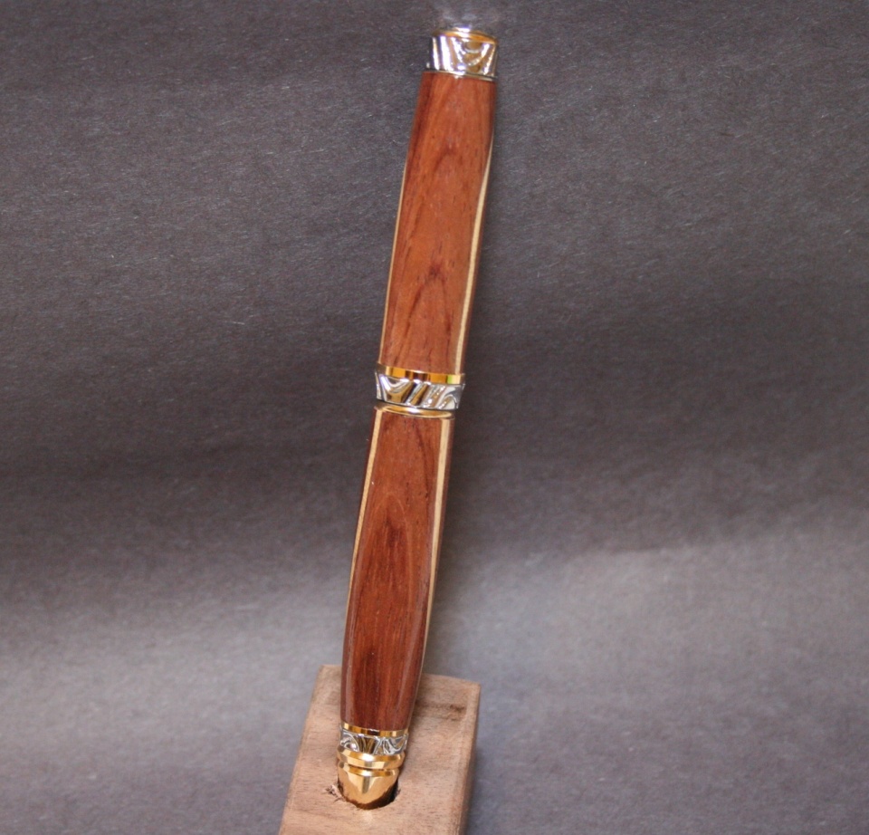

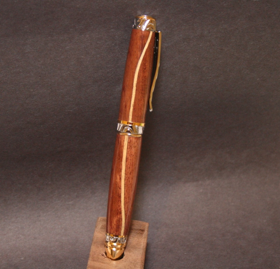

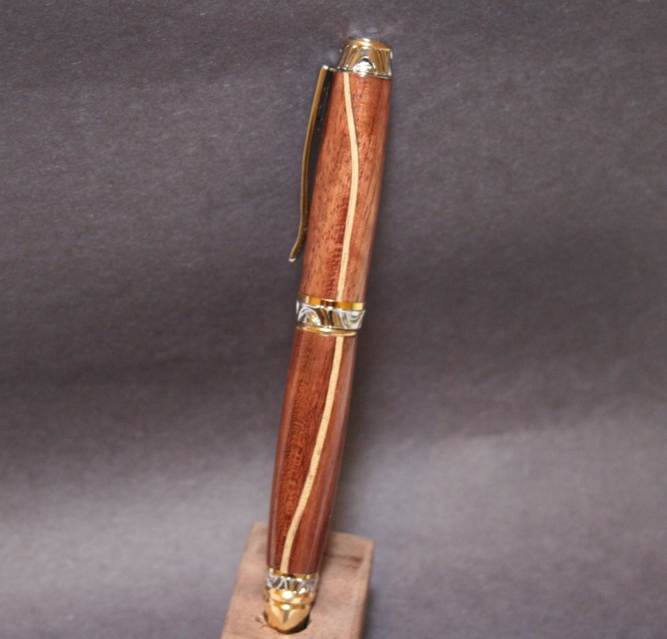

Here is my second attempt at a wavy blank. This time I used Bubinga and Avodire I like the color contrast better then my last wavy blank. The kit is a Wood River Ultra Cigar that Evelyn picked up at Woodcraft while she as out seeing a client. I like the kit really classy. The finish is 6 or 7 coats of WTF, this is the first time I've use WTF and I like the finish it gives. Overall I happy with the way it came out. As always any and all comments are welcome.

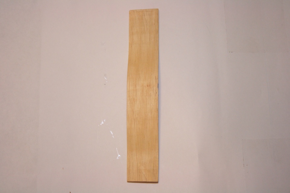

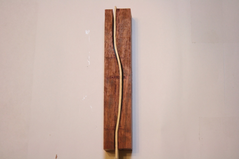

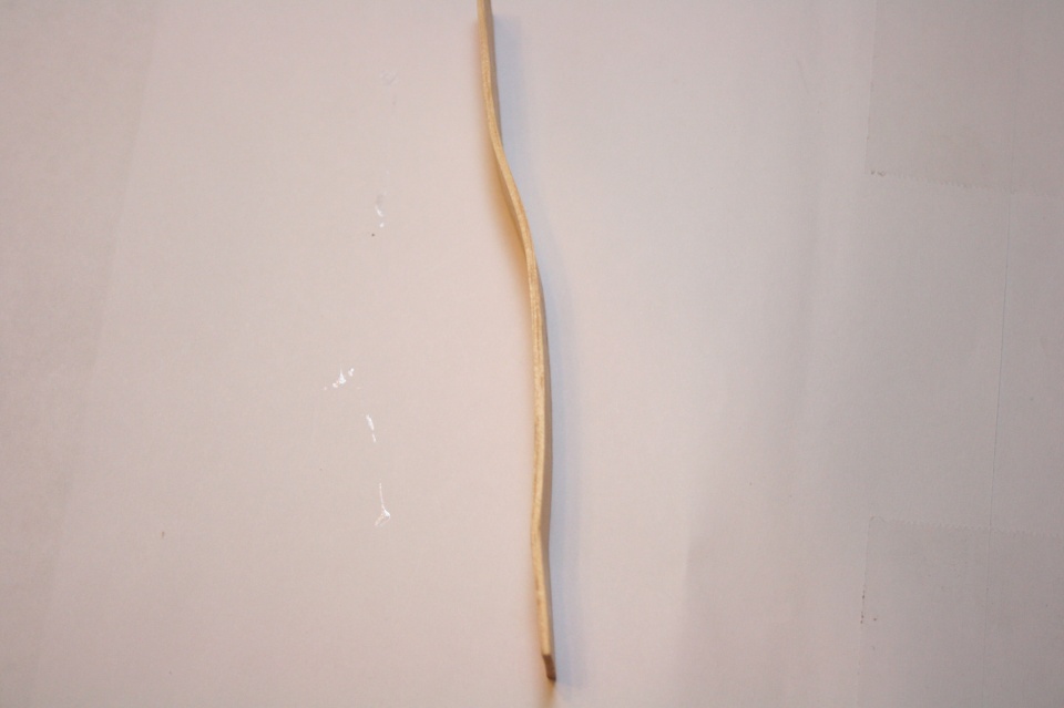

Thanks Steve for you comments. The center strip is about 0.091 I really didn't measure the strip before I cut it just guessed and it was a bit to wide so I have to boil it (about 15 minutes) and clamped it in my vise for 3 days and after that I took it out and let it dry for another day it kept it shape. Here are a few photo's of what it looked like.
