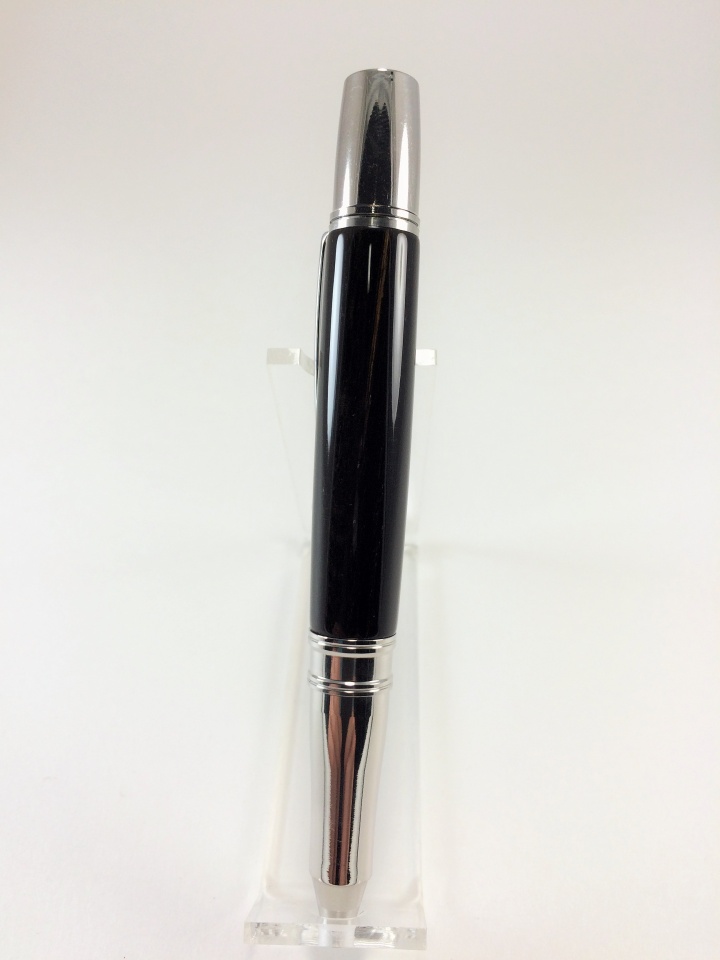

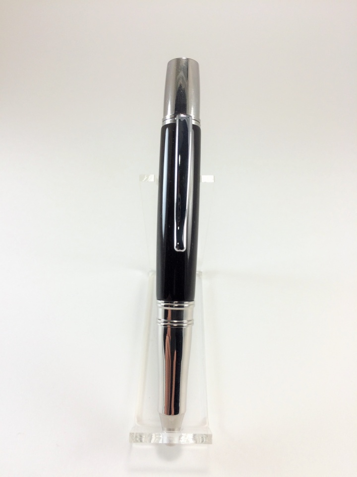

Well, the pen finish came out well, and it turned easily enough. The 8 coats of medium CA hid most of the wood's character. I might as well turned a dark brown or black AA blank. If you look close and have enough light to illuminated Germany's Black Forest, you should able to see some grain.
On to the less-finished finishes:smile:
The pen is a Smittys Pen Works Liberty. I made two - both were/worked flawless/ly.

I have to agree with you on the CA finish giving it a look like AA, but man that finish looks nice Tony! It is a really nice pen, my walnut oil finished may not last as many thousands of years as yours:biggrin:
Nice work!
That's a beautiful finish. I said to only use 5 or 6 coats of CA, Oh wait, that's another thread.:biggrin:
Really though that does look nice and like glass. I had the same thing with ebony, if you look at it close enough and in the right light you can see it's wood. But for all practical purposes, it looks like acrylic.
