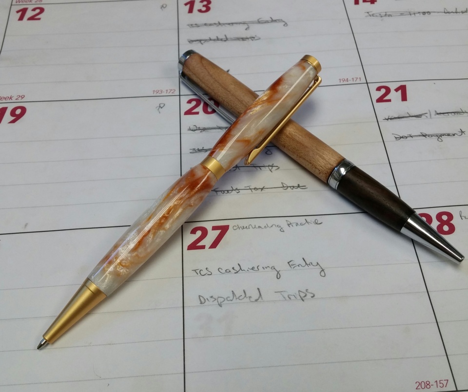

Tying to get a marble look
See more from chartle
chartle

This is my first cast pen trying to replicate marble.
Its PR with micro and macro pearl ex for the white and Aztec gold.
I injected the gold after I poured the white into a horizontal mold. Then put it on a candle warming and let convection currents mix it up.

Looks good.
But, if I may, if you want a marble looks, you will have to dial down the pear ex a lot and try to find something not so reflective. Looks pearly, not rocky. If that makes sense.
Still came out good though, nice job with the swirling.
Yea the white should be mostly white with just a tad of white pearl ex

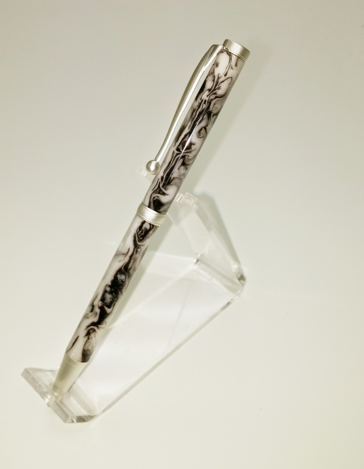

I'll see what my "granite" looks like tonight.
