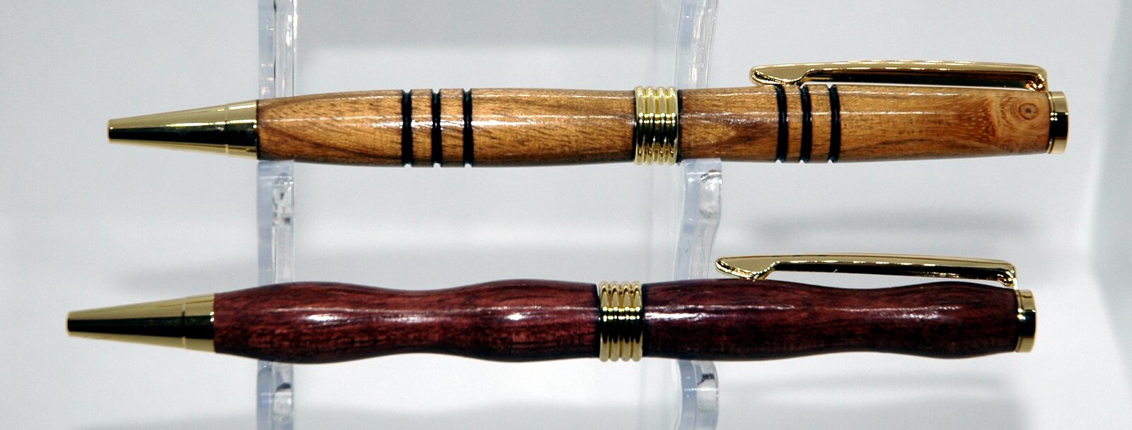

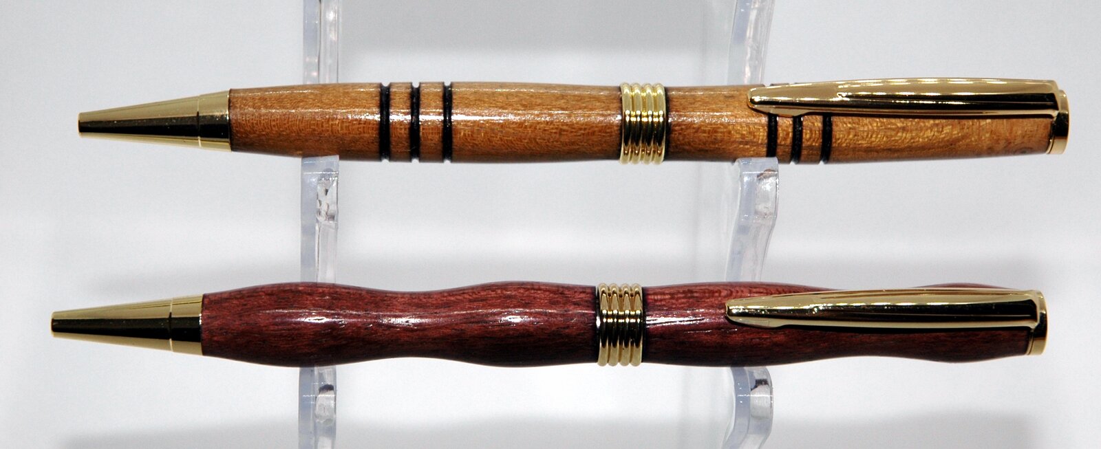

Made these today both Slimlines with the wider centre band. One Purpleheart the other Sycamore.
I used my now standard finish.
1 Sanding Sealer.
2 Friction Polish.
3 Microcrystalline Wax.
Because I used a heatgun to darken the Purplehart I noticed a great improvement in the overhaul finish. A much higher shine from the friction polish, so I warmed up the Sycamore and again a much improved polish.
Hope you like them please comment.
