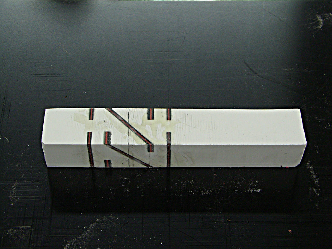

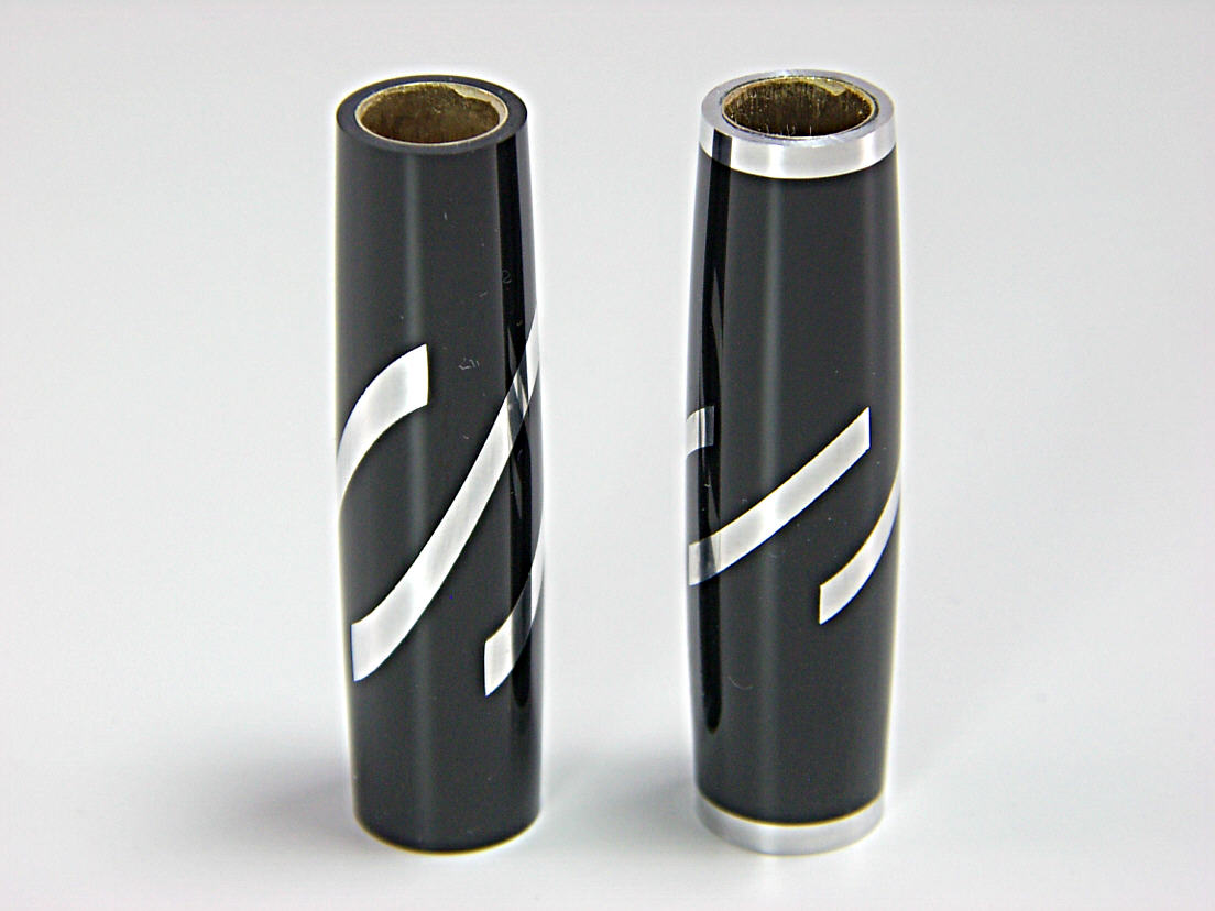

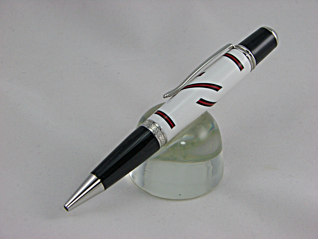

The top one I say looks fine from what we see. The second one is a pattern I am familiar with because I have done a few times over the years. Ye the end bands are a tad different in size and that is correctable. The shape of the barrel is too correctable and yes some kits just scream straight bushing to bushing lines and that kit does. Some times a kit like the sierra line scream follow the lines of the kit and should have a nice sweep to them. The cross hatches I think need to be thinner or less of them in that size blank or skip the end design and spread the hatches out more. I will post a few examples I did. below to give you a better look at what I am saying. But let me say you always learn from your last attempt so keep at it and you will fall in love with segmenting for sure.

Who do you think I stole the idea from?:) Though I hadn't seen the white pen with the 1/3rd segments before. Which I will also be stealing.
An earlier and even less successful attempt on that pattern had, in my opinion, the center bands too thin - the kerf of the blade. I just have to dial in how much to adjust the guide when making the cuts.
I think I'm going to disassemble the vertex and see if I can get the lines and finish a touch cleaner. My OCD just won't let it stand.
