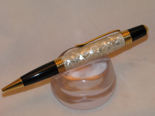

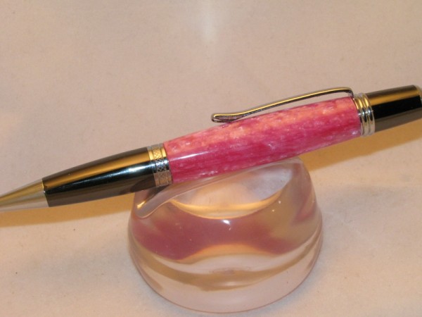

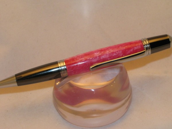

The second pair is a new "substitute for crushed velvet" that we imported. It will never be mistaken for crushed velvet!! But, it is a nice ladies' pen, I think.

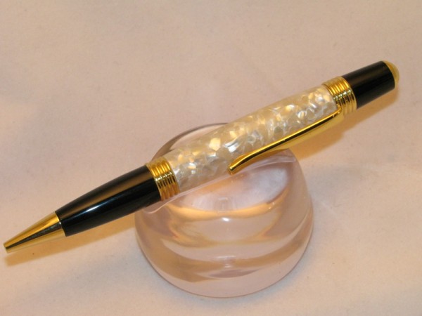

The first pair is from our friend, JohnU. He meticulously has arranged pieces of mother of pearl on the tube, then cast in polyresin. The blank was "pre-tubed", so all I did was turn it. I chose to make it on a diplomat4, which allows a little more room than a standard sierra. The actual OD of the end of the blank is 0.502". At this point I was happy to sand and polish.
All comments, questions, etc are encouraged!!
Thanks for looking!

Second the Mother of Pearl. That looks very tempting.
I've been doing a ton of Divas recently, that would be a great blank to go with the clear crystal version.
Very nice.

Mark,
I'm not familiar with the Diva style.
When doing blanks like this, the "thickness" of the material is critical. Measure the OD of the brass tube and the OD of the hardware it has to "mate" with. If the difference is one hundredth of an inch (0.010") or more, the blank could be made. Now, just convince JohnU that he wants to take an hour or so to make one!! These things are VERY time consuming---Dawn has made a couple designs for me, I understand when John says, "May be more work than they are worth".
At the pen shows, you will see quite a few Mother of Pearl antique pens, so it is not a NEW idea, just a pretty one!!

The Diva is a 3/8" tube. I'll measure the O.D. Thx...
Mark,
This is going to sound picky, I don't mean it that way.
3/8 is the size of the hole, we need the actual OD of the brass. Then the real OD of the mating part (pen part-both--or all four--ends--the smallest one determines the feasibility of the embedded objects).
This is the "technical" aspect of "blank-making". It's also the major reason dichroic glass blanks never really got started--too fat!!
