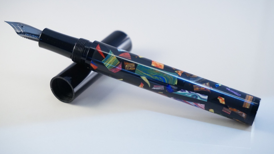

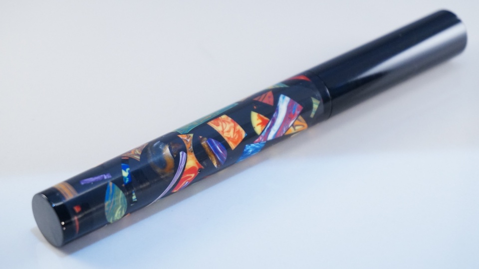

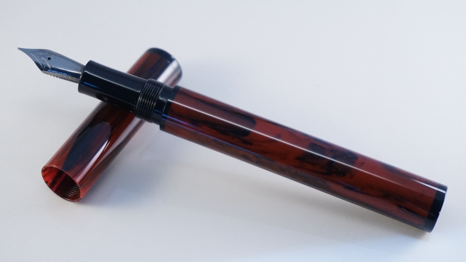

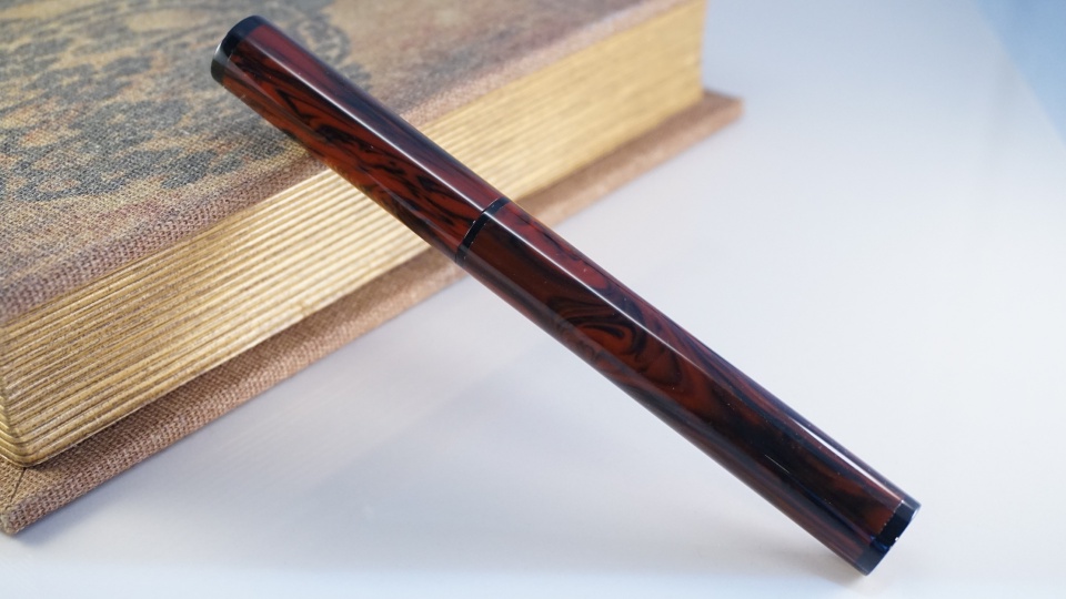

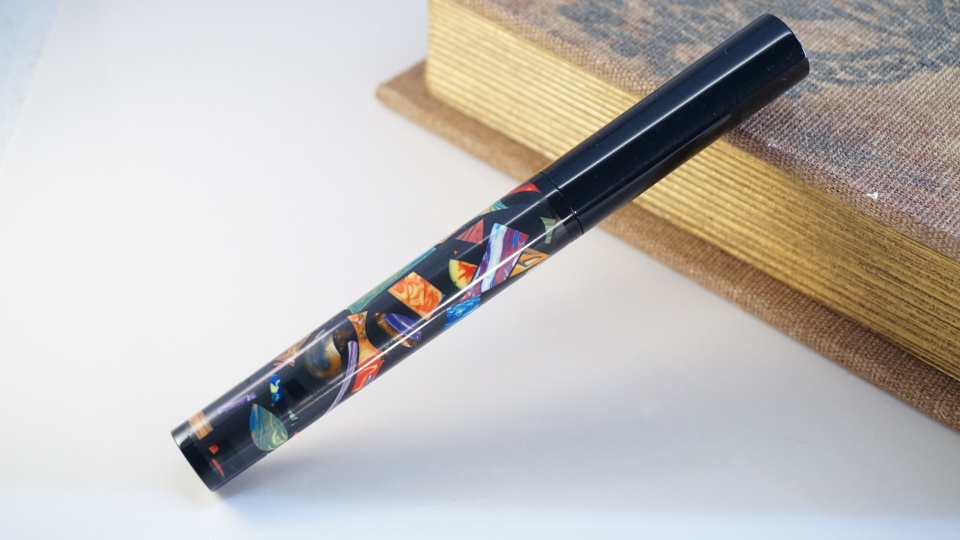

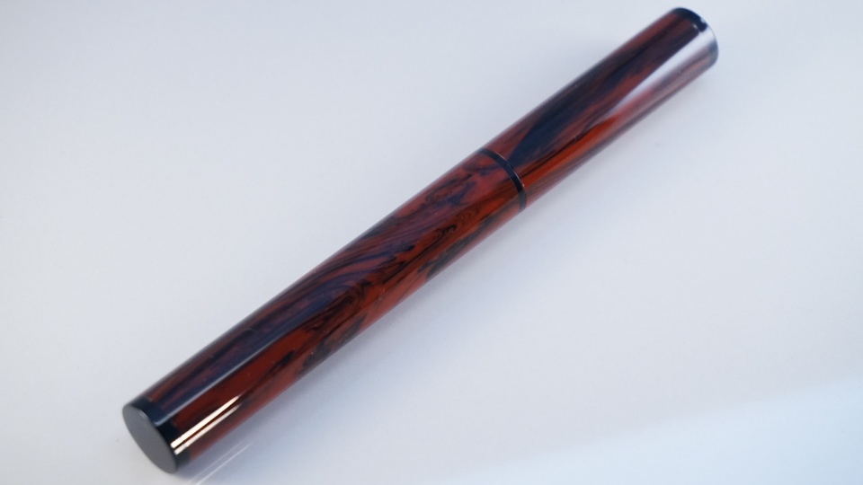

I have two new pens done in the style I have been pretty much exclusively working in lately.
The first is in Alternate Cumberland with black AA end pieces and section. The Nib is a #6 Jowo Ruthenium EF.
The second has been done in Eugene's Matrix in Black also with black AA end pieces and section as well as the cap. I originally made the section for this pen in red AA but I didn't like the color match so I borrowed the section from the Cumberland pen for the photos. Since this pen sold within a couple of hours of my posting it, I guess it gets to keep the black section! That means back to the lathe to recreate the black section for the other pen.
C&C always welcome.

Beautiful pens. Pen Dimensions? Thread sizes used?
Love the matching diameter between the body and cap.
I've been working on a similar design out of stainless steel, aluminum, and brass using 9mm x .75 for the front section and 11mm x .75 for the cap. I'm able to make the pen just under 1/2 inch.
Thank you for the kind words... The Cumberland pen is 15.74mm, in diameter while the black pen is 16.35. Both pens are 152mm long.
Both Pens share the same threading: 14 x .75 x 1 for the cap, 10 x 1 for the section and the standard Jowo threading for the feed.
The black end pieces are ~3mm wide.
The initial size I turn the section to, before shaping, is larger than a half an inch!
Eric
