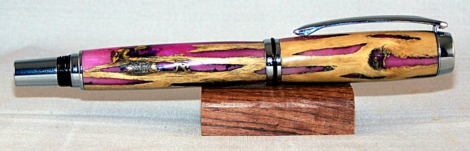

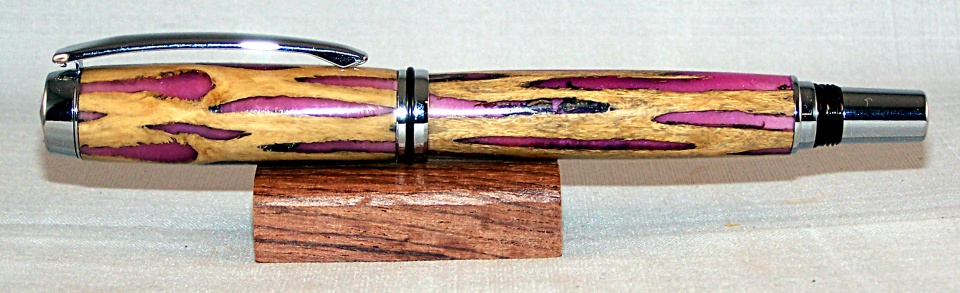

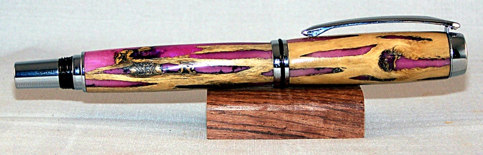

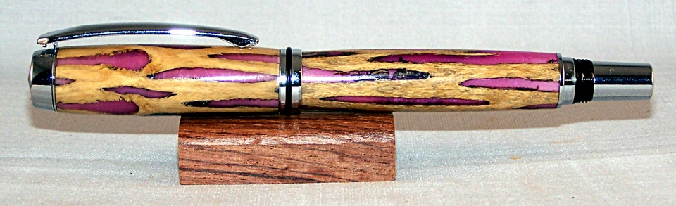

Still haven't found that piece of the corn cob blank, but I did manage to fix the Cholla cactus blanks. Turned out repairing it was pretty easy. It had merely blown out a small section of the acrylic which I was able to fill with some blank sawdust from an ebony blank I had turned long ago (yeah, I save sawdust of various colors for such a time as this!)

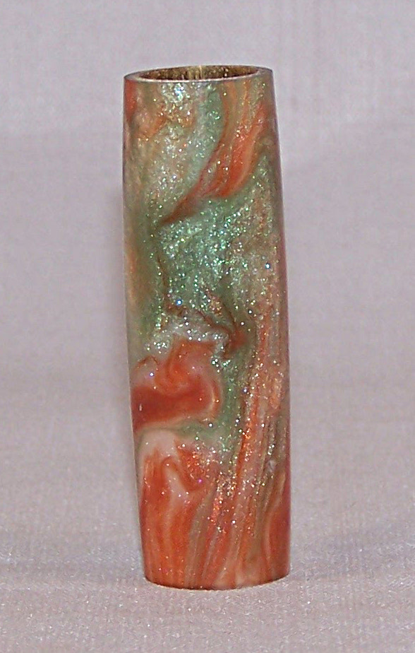

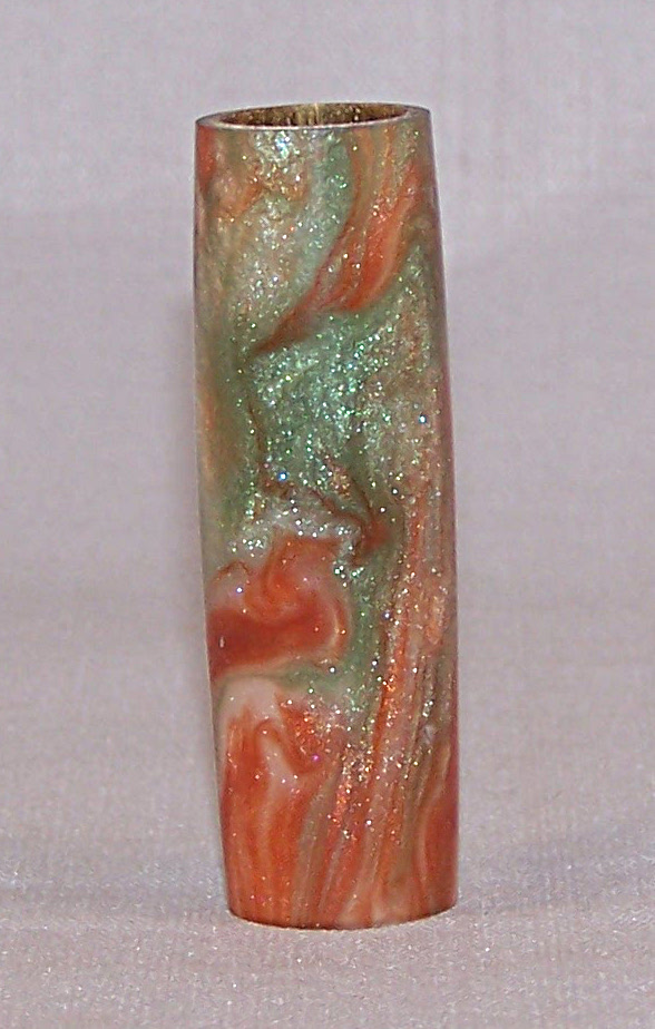

Also, I've included a picture of the other half of the blank I had received from Dan (H2O). I've got a few more which will make some great pens. I've posted a picture of two in the SOYP forum.
Thanks for all the encouragement. Today was definitely a better day in the shop.

Oh wow ... I love the chatoyance in that blank, it's beautiful ... can't say much for orange, but it balances the color in that blank pretty well.
