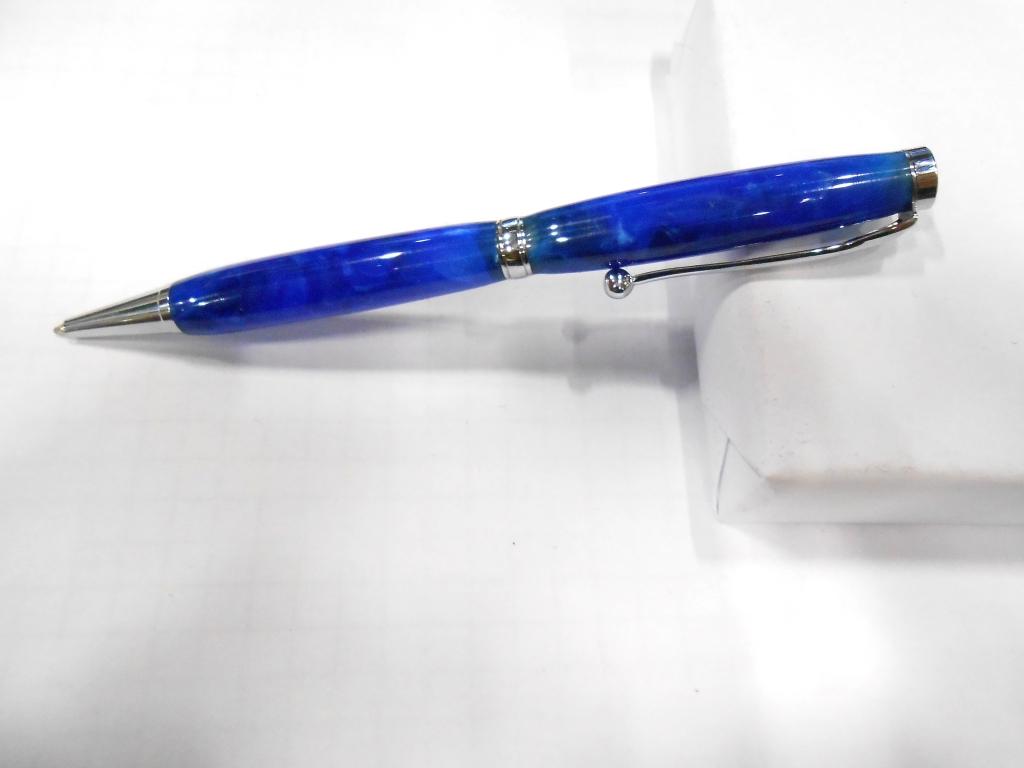

First up is a Chrome slimline wrapped in Sapphire Blue AA from woodturningz. Mixed black Testor's paint in with the epoxy.

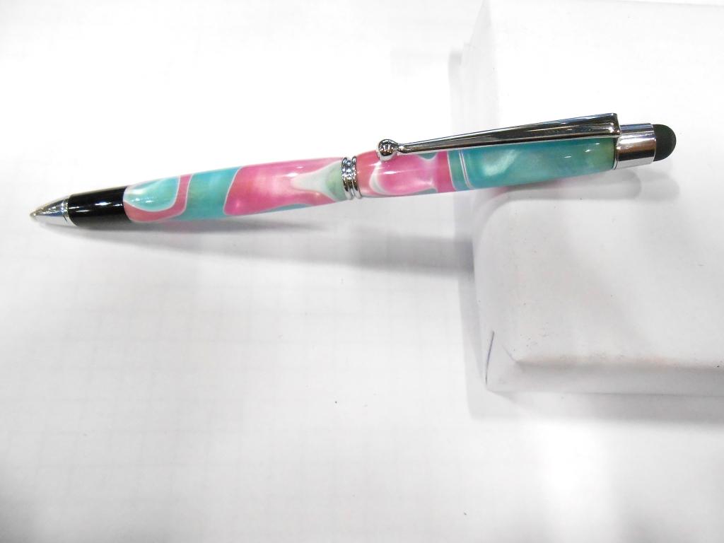

Next up a Chrome Stylus Slimline wrapped in Caribbean Cove AA from woodturningz. Mixed white Testor's paint in with the epoxy.

Both pens are beauties. My favorite the the pastel.
I like the idea of mixing a bit of paint with the epoxy. Did you back paint the drilled holes as well?

Nope no back painting just mixing paint into the epoxy. In my (admittedly limited) experience I get the same results whether I back paint or just tint my epoxy. Although now looking at the pics I do see at least one place that I can't see in person that would have benefited from back painting.

Upper barrel on the blue one at both ends and the stylus end look a bit brassy, but otherwise well done. I've had that happen on pens I reverse painted- once you get lights on it for pictures it really helps you see where to pay more attention next time.

Yep those are the spots that I noticed. I can't see them in person under any lighting situation and the two customers said they can't either which is weird because I didn't use any lighting for the pics just sat them on white paper on my desk at work.
