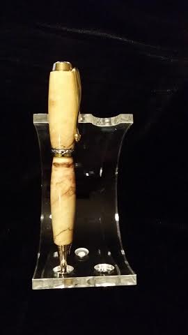

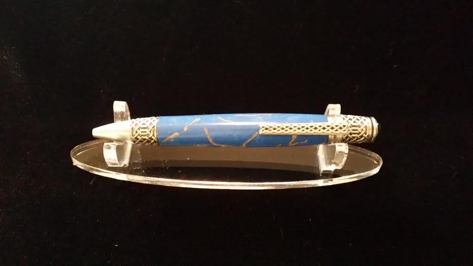

I created these pens yesterday on my new JET 1015VS...wow what a difference....I was using a Craftsman and it was so loud! I can turn at midnight now and not wake the neighbors lol hahahahahaha
I poured my own resin and added acacia leaves for the Celtic as requested by my client.
The Triton Ballpoint is going to be a set consisting of a matching Triton FP. Have not had the chance to make that one yet....it's next.

Hey Michelle look good. I am not a big fan of thick barrels a personal preference. I really like the second one. Would like to get a better look at the first the picture kind of blurry.
These done on your new lathe?
Very nice - the Triton is one of my favorite kits
Any particular type of acacia? The leaves have a nice golden look - did you just let them dry naturally before casting?

Beautiful Blanks. The Timber looks interesting, while the Blue Acacia, looks Spectacular.
Nice Fit and Finish. Like John, I too am not a lover of thick Blanks, but the Customer is always right.
To save my aging eye's could you try to get a little closer with the Photographs please.

You did a great job on the blue pen. What did you use to color the resin? And did you use alumilite or PR?
Can't wait to see the Triton matched with the fountain pen. Do you think the ballpoint version feels a little off balance? I've done some Jr Gent ballpoints. I like the way they look, but they don't feel well balanced to me.
I use alumilite clear with dark blue and white dyes....a couple of drops of each until I reached the desired 'light' blue the client requested.
I love the Triton! It looks good, feels good and overall is a great pen. I will be making the fountain pen this week....

Very nice Michelle. Did you use mold release with the clear Alumilte? Did you place under pressure, and lastly, did you use PVC or similar tubes as molds, or silicone moldes? Thank you!
I am having more success to poly resin, but do like Alumilite. Very nice job!
Ed, I am using the bushings that match the pen component (kit) and I am squaring the ends with a barrel trimmer on my hand held drill....but since going to the JET, I am in the process of doing everything on the lathe....no more drill press or hand held drilling/squaring....
