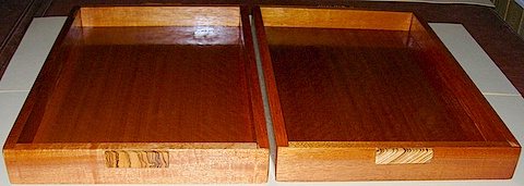

Well, I'm finally done two of the trays I was making for Christmas. They took a lot out of me and wiped me out today. I got some good advice from several here, about finish and I think these trays will do well with any spills. I used spar varnish (outdoor exposure type) for the top 2 coats and treated the bottoms with at least two previous coats of danish oil. One of them even has a layer of sanding sealer on it. That's the one that turned out the best, with less open grain dips in the final finish. I sanded with 1,200 grit paper before the final and 320 (random orbit sander) before the first coat of spar varnish. Thanks for your help, to those who did.
I wanted to do finger joints, but had to settle for what I think is called a lap joint. My first cut was too deep, so there's about a 1/8" on the end. They are made from baltic birch 1/4" plywood, laminated with beeswing Makore' and the sides are Honduras Mahogany, with zebrawood handles. Anyway, they turned out pretty well, for my first ones. Here they are:
Comments and questions are welcome. Next time, I have to sand better, to get off soaked in woodworker's glue. It disallowed some of the finish to darken the wood in small areas. One set of zebrawood handles are end grain, the other is face grain, bias-cut. I wanted to jazz the trays up. These are all natural colors.

Oh, I forgot to mention that they are about 2" X 12" X 20". This was one my best finish jobs, other than pens. I have trouble with bumps, but the 1200 grit sandpaper worked wonders.

Glad to see you got them finished and posted. They must have been a lot of work, but they really turned out nice.
Since you finished the trays (and my order [:D]) give your back a rest and enjoy Christmas. You certainly have earned one!

Very nice looking trays. I'm sure they will be received well and highly cherished.
I once coined a phrase on another forum so I think I'll use it here to...........
Another heirloom is born!

Wow Mudder, that's a great compliment. I just hope they hold up. I really wanted to do finger joints, but didn't have the time to learn. Maybe next year. I still have 3 more to do too. I wish I could show the POW! factor in these pics. My first pics practically blinded the camera and came out as a flash of light. That wood is very chattoyant and the gloss is sharp. I bought it for this purpose almost two years ago. The makore' has more figure than the pic shows (aint it always the case with figure?!).

Well, Here's an interesting outcome. My Mom has been very unemotional, since she had to start taking a medication, 14 years ago. Not so today. When she looked at the tray I had made for her, she couldn't talk, she just broke down in tears. I've only seen her cry twice in all of these years, so this meant a lot to her. She knows how much pain it took to make it and she was speechless. Everyone liked the zebrawood handles best, though my Dad had to point out that they were a bit thin to be able to lift any weight with. I had trouble figuring out how thick to make them. Oh well, my Mom loved it.

Real nice work on the trays for sure. You chose very nice wood also. Now you can take them to the next level and get creative. Just some examples. First finger joints is the easiest joint to master on a table saw. You do not need any fancy setups. You also can splay the sides out just by cutting them on a 15 degree angle. You can put an arch in the ends and this can be cut with a scrollsaw or a bandsaw. You can cut the finger holes out instead of using handles. You can inlay different designs in the bottoms and also inlay around the handle holes. As you can see the sky is the limit and there is really not much more work than what it took to do those. Do a google search for serving trays. Wood magazine had one a few issues ago. Go to DYI web site and you may find plans and examples. Go to a Walmart or any other store that sells things like that and look for examples. You have proven the talent is there so take it to the next level and enjoy. Good luck and again nice job with these.

Thanks. I had originally wanted to make the handles cut-out from the ends, with a raised arch over them. I want to play with veneer/marquetry. I have to buy a smaller blade for my band saw too. I use a 1" 2 tpi carbide (232.5") blade for all of my cutting. I have an unopened pack of sleeves, or whatever they're called for my router, to use in templates too.
Sometimes, I just go for the easy way, but that's not as fun. I have huge sheets of veneer, for doors (37" X 110") and I want to play with it. I'm going to make an end table (corner table over 3' square). Some of my veneer is extremely curly factory stitched cherry. I'd love to make a blackwood inlayed trim.

I always try to think outside the box and that is why I like odd things I guess. Just something to think about on the corner table. Think triangle shape. Looks cool. Be careful of underlayment material used when doing veneer. Any wood that is venered should be veneered on both sides to prevent warping. Good luck and look forward to seeing some more of your work.

Rob, The more I look at them, the better they look. If you really want to challenge your skills, next time you can try to make the frame slope out at an angle, and mitre the corners. Use bisquets &lt;S&gt; to hold everything together. As it is, I like the way you joined the wood. These will be treasured for a long long time. Novice huh? LOL , great job! Oh, and almost everyone has problems with glue squeeze out once in a while. It's one of the reasons I stay away from poly glue.
