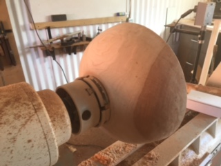

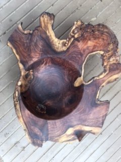

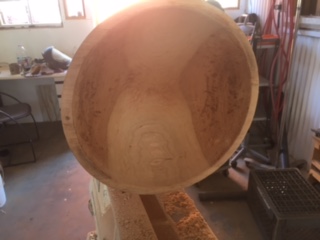

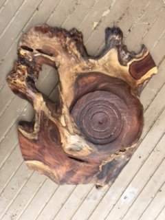

Any way a 13" cherry salad bowl and a large winged bowl made from mesquite root burl.

I'll join all those complimenting the mesquite burl... great piece.
I have a maple burl that I got from a fellow at one of my shows that he wanted me to turn... hesitating starting because not sure of a design, but after seeing you bowl, think I might try something along that line... love the abstract look of it.
How is it finished?
Nice work. Great looking bowls.
I have been using a Oneway 1012 for years and know you will love your OneWay lathe. I wish I had not had to dip into my lathe fund when we built our house so I could have gotten a larger one but this has served me well.
Whoa! That mesquite bowl might be the nicest I've seen. I'd be thrilled to make something half that good. Well done on both counts!
How is it finished?
I used Howard's Feed-N-Wax Wood Polish & Conditioner, The first application was sucked up fast (the root was old and dry), I did 3 applications adding extra to areas that were still dry. let it set for a few days then added a layer of Howard's citrus paste wax. I like the look of natural wood.
