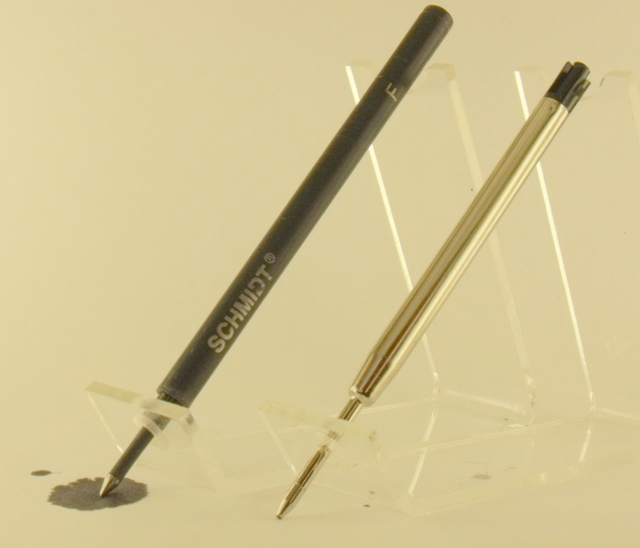

In this thread it was asked if you could get a Rollerball kit with either a Click or Twist mech. I don't think you can, but one of the replies was something I always agreed with until now. That was that a rollerball kit came with a cap to prevent the refill from drying out. It makes sense and there may be some truth in it. But I think that there is a bigger reason. Most of the refills ( Schmidt ) State that their refills are Non Drying and I've had refills laying around my shop without the little caps on them, for ages and they all still work no probs. ( Or at least with a quick scribble on a piece of paper. )
Take a look at the pic with the refills. If the rollerball tip is touching anything, it will syphon itself out. This ink leak was from about 15mins.
It's not the paper background 'sucking' it out either, because I've had new kits where the little protective cap has come off and the plastic bag is full of ink. I believe this is now the primary reason rollerballs have caps. The ink will keep flowing as long as the tip is in contact with something.

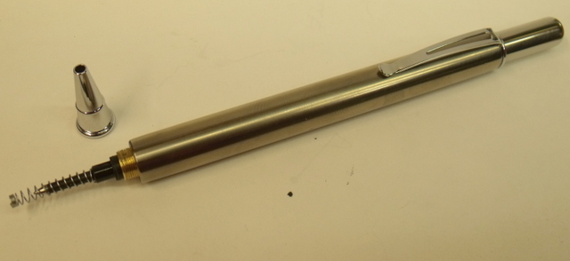

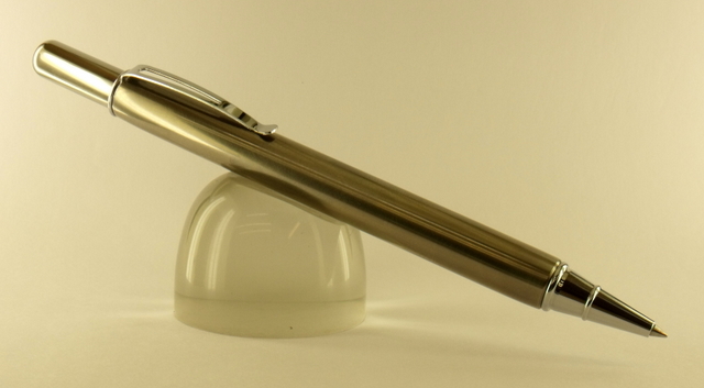

This pen is one I knocked up today. It's a rollerball in a modified kit with a twist finial mech. The kit nib and clip are chrome, the finial cover is stainless steel and the blank is titanium.
I'll keep this one in my truck to give it a hard life and hopefully I won't forget to retract the refill. :rolleyes:

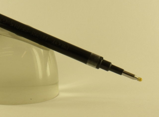

I just had a quick try with a G2 refill. With just it's own weight, it didn't leak. I now have it in the same pen with the weight of the pen on the tip. I'll post a pic later. My new G2 refill did have the tiny protective 'ball' on that you need to crack off.

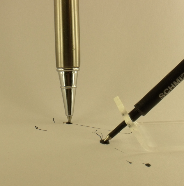

Ok, with the G2 resting at the same angle as the rollerball, it didn't make a mark. Here's a pic of it in the pen resting directly down on the tip and after about 8 - 10 mins. A small matchhead size smudge and nowhere near that of the RB. But I still wouldn't like it in my shirt pocket!!:rolleyes::biggrin:
Also a pic of the G2 little plastic protective ball.

Secondly, I've been making both click and twist roller ball pens for over a year now. Your suspicions are spot on. The Pilot G2 refills work just fine. The Schmidt 5888 work fine too, EXCEPT, as you stated if the tip touches anything the ink WILL IN FACT siphon out.
