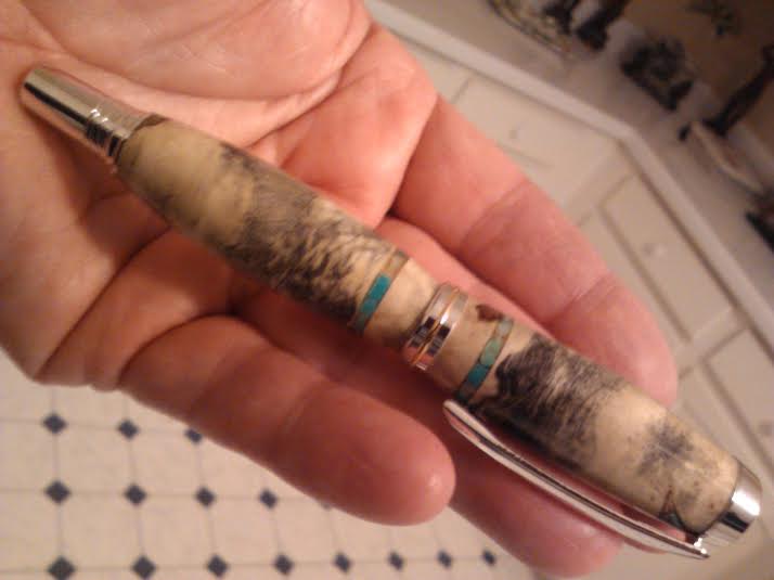

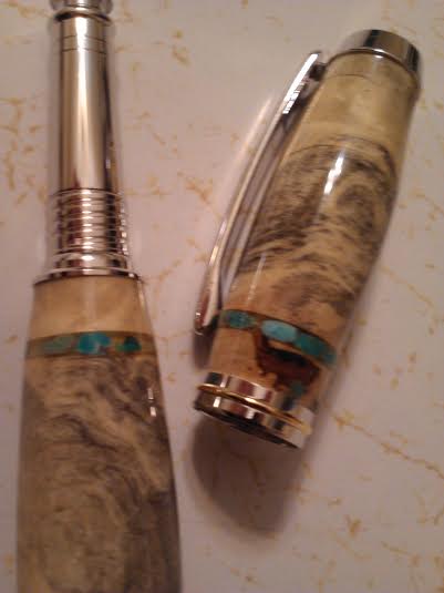

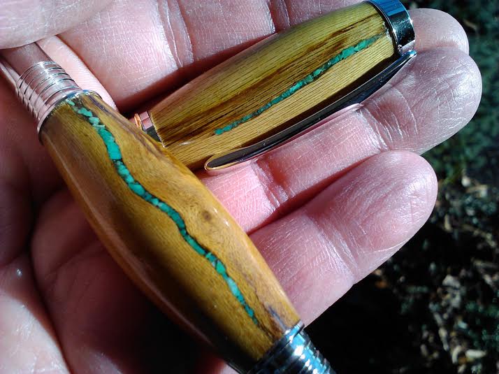

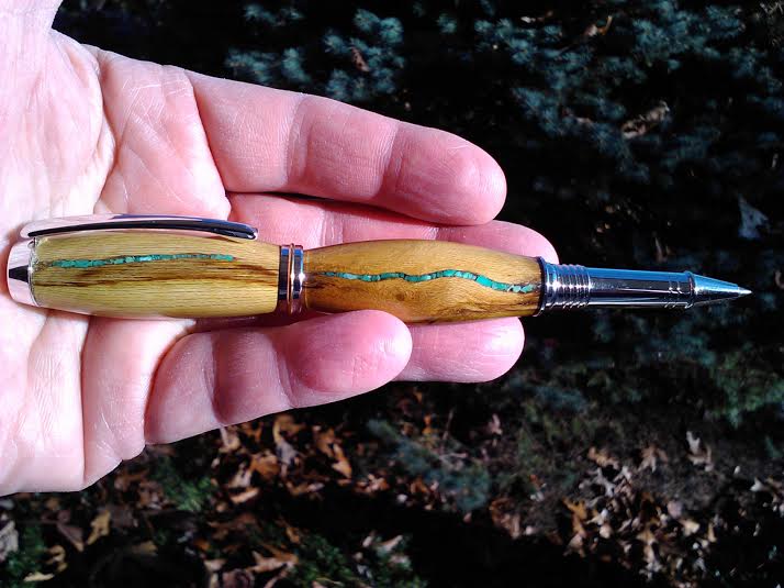

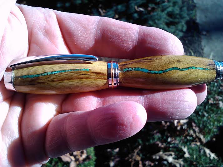

I tried something new (for me) last week. I imbedded some turquoise stones into a crack in my pen body on one pen, then I got an idea about imbedding them into self-made openings on the pen body. I think they came out ok.
Here's my question: Has anyone ever tried to create an entire pen body using nothing but these small turquoise stones glued one on top of the other? I imagine I could glue (CA) each stone to the brass tube, then sand it into shape while spinning on the lathe. I imagine this process would take a good amount of time to accomplish, but it might produce a unique pen.
Any thoughts?

Nice Job Drat. I've never done a full pen body but have done close to 50%.. I generally will batch my inlay pens up so I do at least 10 at a time.... I also like using Inlace over stone and CA glue... But I do both.... With inlace you will have to allow it to cure overnight but I give it a full 24hours if not more...
Good Luck!
Rick
I think it looks really nice. I don't see why you couldn't do a whole pen out of the stones. may take a bit to get the right amount but with practice you may have your niche
Here is a little tutorial I did on filling a BIG hole with turquoise.
http://www.penturners.org/forum/f14/turquoise-fill-trashwood-blank-68082/
It might give you some tips.
I was just a beginner when I made the tutorial, so it certainly doesn't require any special tools or techniques. The only thing I would do differently now, is I would use a carbide cutter instead of sandpaper to shape it.

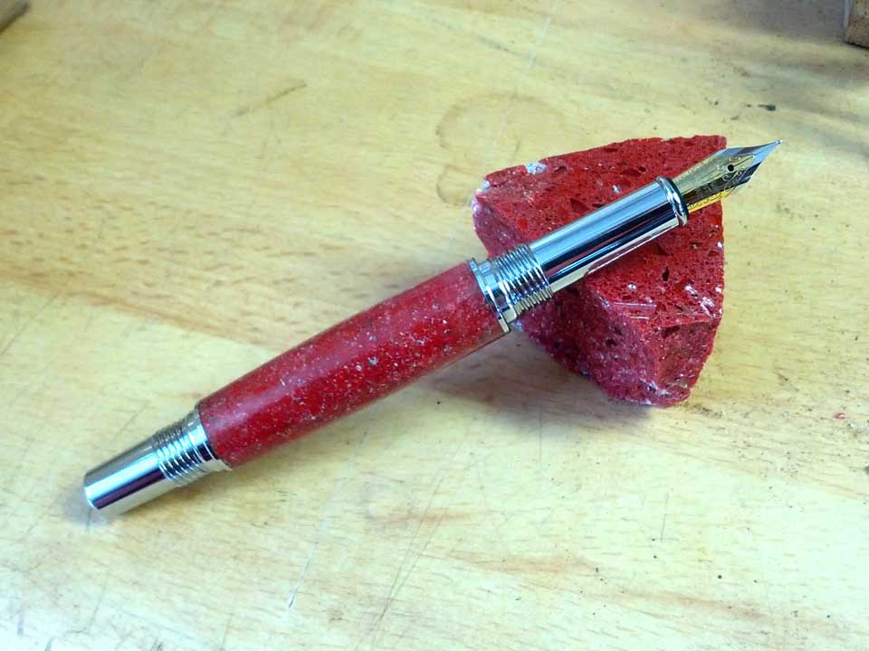

I was so excited a few months back about making my first Truestone pen and I was telling my in-laws about the blank saying that it is 85% stone and 15% resin. Something was lost in the translation and they only heard the "stone" part. A few days later there was a knock on the door and my father-in-law was dumping about 600 pounds of stone counter top left-overs on my driveway. "That should give you something to work with" he said...
I broke off a piece of a red quartz slab, pounded it down into almost dust and then CA glued drop by drop, sprinkle by sprinkle onto a pen tube. This is a picture of the finished barrel after it had been sanded and polished and then pressed together onto a Triton. You don't see the finished pen because someone grabbed it out of my hand and wouldn't give it back before I had taken her "glam" shots. Hence the poor cell phone pic attached.
I have since done a few in grey quartz but still have about 599.99 pounds of counter top left over if anyone is interested...
Mike

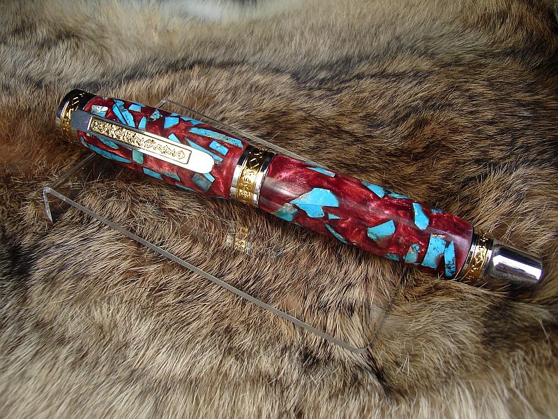

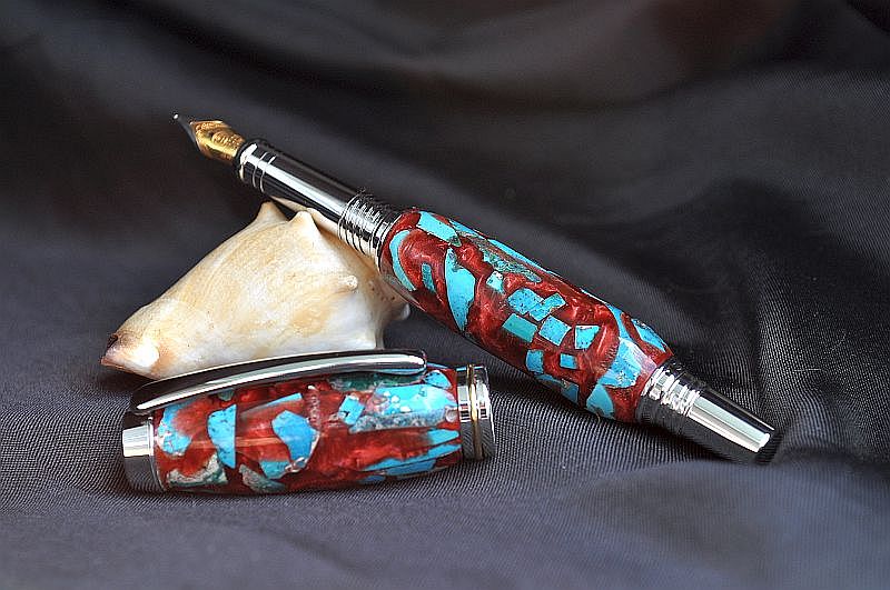

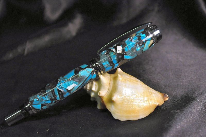

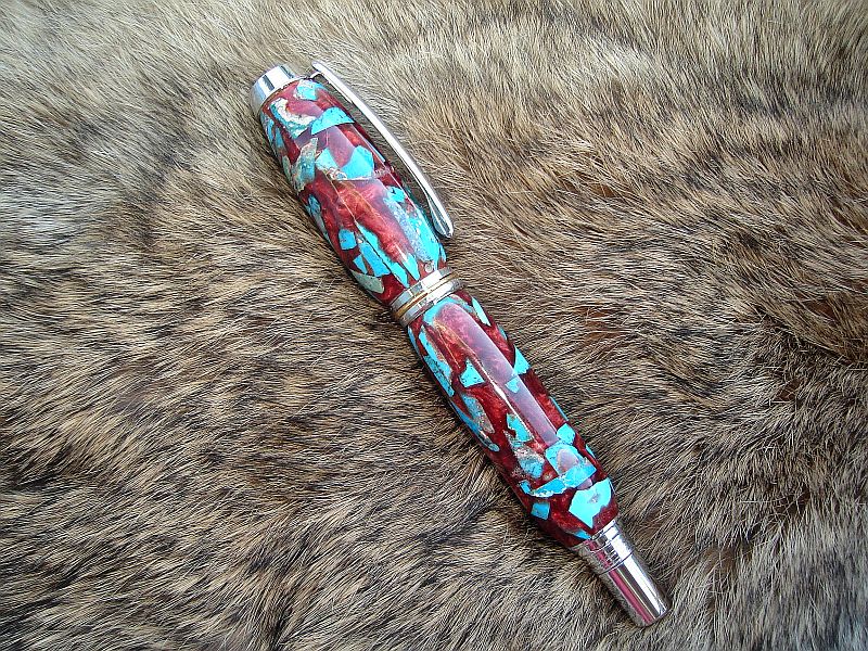

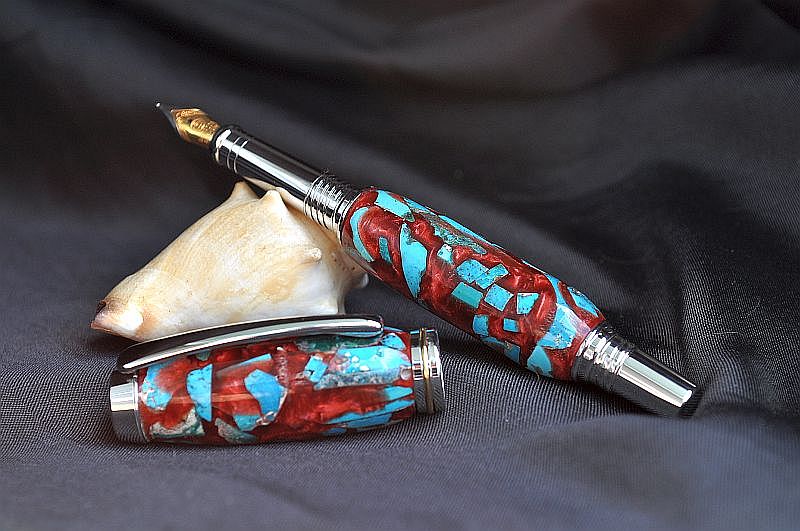

I do them all the time. Popular on deer antler as well
