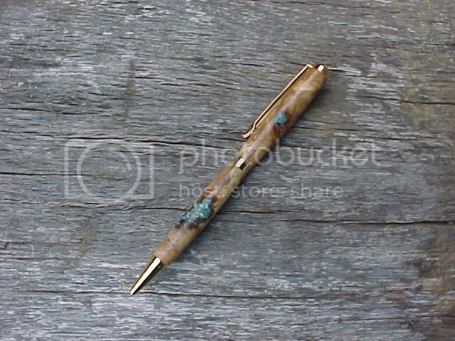

hello all,
i put this together last saturday, and boy did it give me a head ache. the wood is olive burl from the root side of the tree.
the voids are from dirt where the root grew around something.
i used 5 min epoxy to set the stone this is the first time i've tried to inlay a pen
laurie

Laurie, that looks great! A tighter-cropped pic will let us see more of the pen. Also, try adding a [ br] (without the spaces) after the [ /img ] tag so your text comes up on the next line.

Originally posted by Ron in Drums PA
<br />Looks Good Laurie, I like the turquoise.
Did you ever try filling voids when coffee grinds? Looks like bark.
Ron
Please share your procedure for filling voids with coffee grounds. Sounds interesting. Thanks.[:D]

It's pretty easy.
Take dry coffee grinds, fresh or used.
Pack the void with the grinds and apply a liberal dose of thin CA glue.
When dry turn as normal.
Of course only the best coffee should be used!!![:D]

wow everyone, thanks for all your compliments. this is the first picture i've put up here. i'll get better with time. as with my turning. how did i do it. the void was natural. this was a root ball and the dark bark hole was just there. as i turned the pen tube down the bark fell out as wanted. i use a 2 part, 5 min epoxy.

This motivates me to try turquiose on my next pen. I have a spalted blank that has the additional character of small worm holes throughout. I am going to open some of the voids out and stick turq. in the holes.

Nice job. Did you crush the turquoise or by it that way. I have tried a few pens like this and crushed it myself using a hammer. It is a little tricky but works and is cheaper than buying the crushed stone.

fshenkin, i bought this from wood turner catalog. not cheap but you don't need much. if i had larger stones i too would crush it. this is just easier. i've bought beads (small stones with holes) and have crushed them. and found that cheaper but too much trouble.
