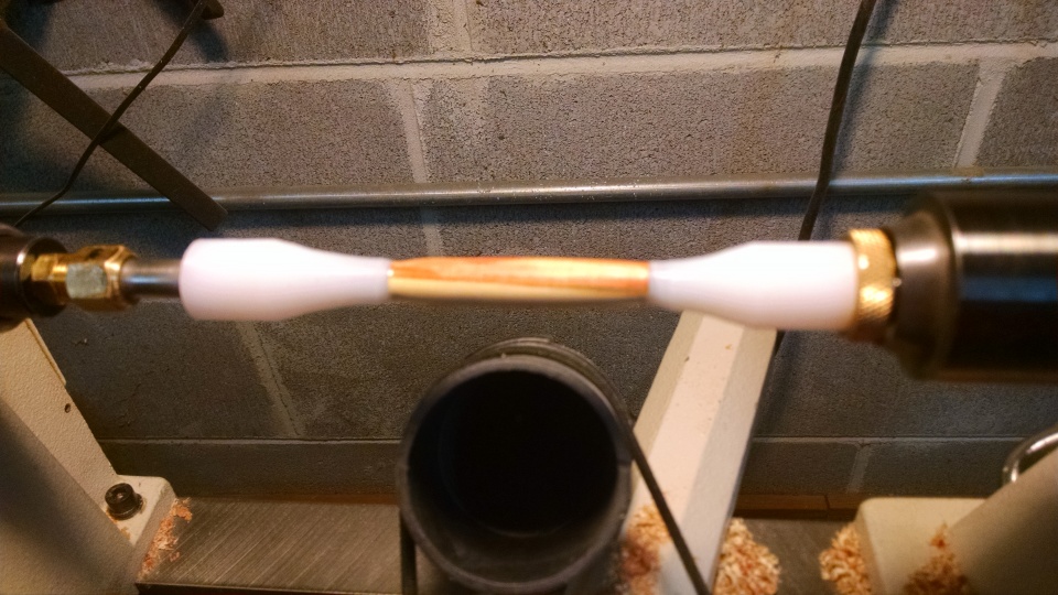

I was at the Turning for the Troops at our local Woodcraft store. A friend works there and I inquired about a 60 degree live center. He replied that he would like to sell one but took me back to the class area. What he showed my was an eyeopener and so simple a caveman could do it. The photo shows what was on a lathe. Two pieces of nylon or HDPE drilled and turned down as a substitute bushing. With calipers, I can turn down to the needed diameter with allowance for sanding. Even if you hit the plastic (general catch-all term here), no harm done. In fact, you can turn the blank and plastic together to get the desired diameter. Going to try to add a photo for you. Here goes!
Sorry for the quality- took with my cell phone.
