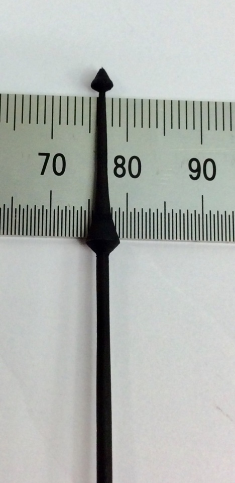

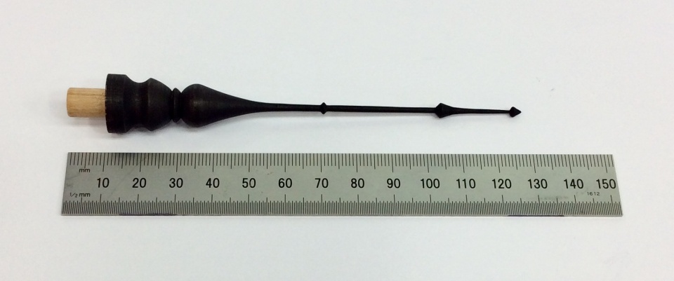

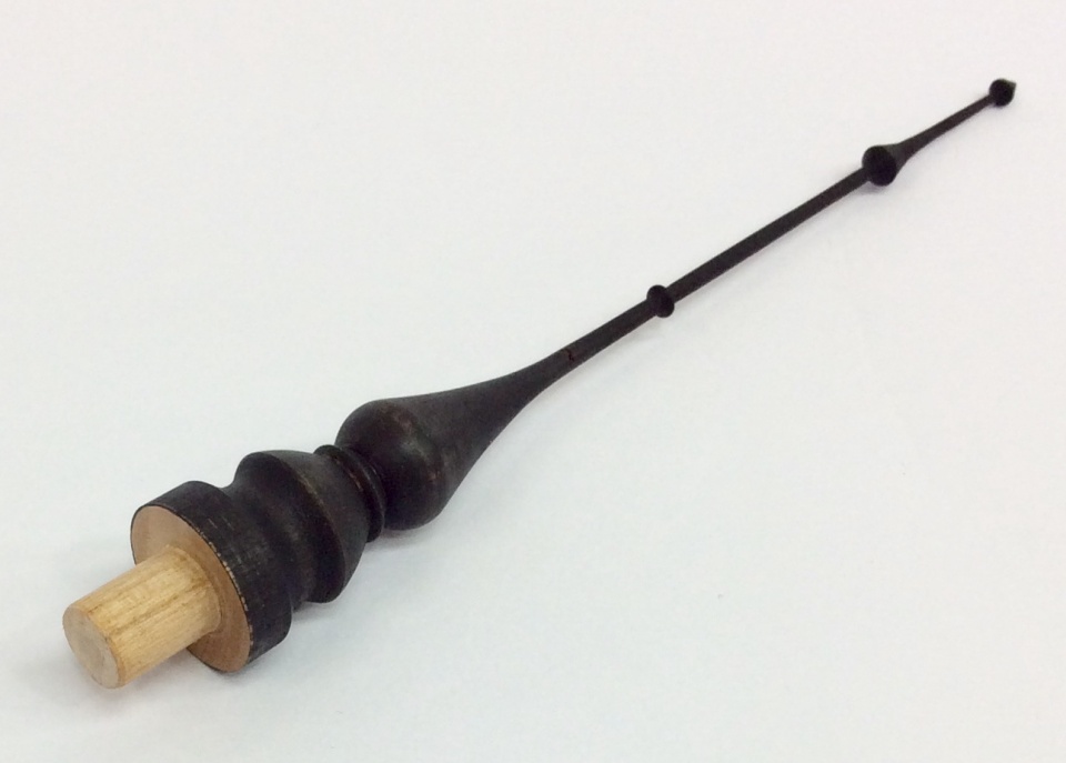

Finesse is the key word today! I decided to go for a very thin finial....no project in mind but practice delicate turning and see what I get.
So, here is the result.....a cherry finial ebonized with India Ink which raised the grain....back on the lathe for a light 600G sanding and a quick spray of Satin lacquer. I did not recoat with the ink as I wanted a little of the grain to show through. Length: about 5" including tenon. Smallest diameter: 1mm

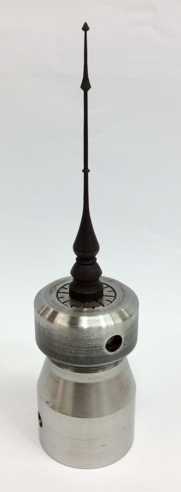

I like the collect chuck for turning the finial
I used a 3/4" collet for all the turning and then the smaller collet to hold the finial after the Ink raised the grain and I needed to resand.

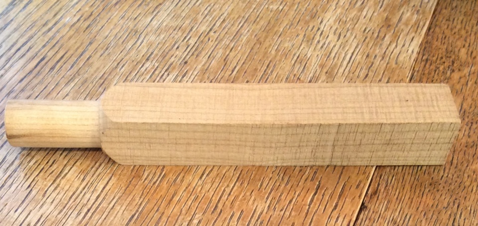

Original blank was 7/8" stock x about 7".

To make it work also you need to watch the grain of the wood, in this case your last post shows the grain Horizontal with the blank.

Dieseldoc, On closer inspection, I realize my quick pic showed the side of the blank with bandsaw marks which can look like it being a crossgrain blank. The grain is in spindle orientation...parallel with the bed.
I would not attempt to turn something like this cross grain. I am sure it wouldn't stay together.
