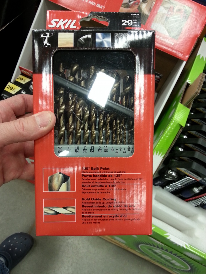

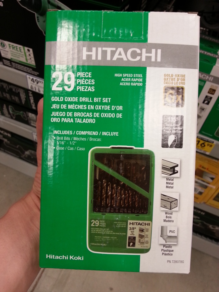

Drill Bits and Driil Doctor (and True - Stone)
I am committed to buying the better quality bits (even though many are enjoying success with the less expensive varieties).
I visited Lowes this morning, and these were on sale. I am not suggesting that they are a substitute for bits that cost several dollars each, but I thought some may want to be made aware of this unadvertised sale. I am pretty sure both come with a metal storage box.
  • Skill, 29- piece gold oxide, split tip 135 degree was $30, now $20
  • Hitachi, labeled the same as above, was $35, now $17
Again, just making all aware of the "sale"
Best to all. Enjoy the this day.
Tony
