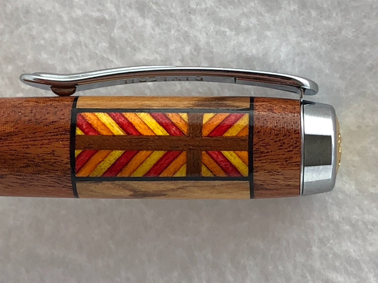

I used spectraply alot - mostly for small segmenting.
Sharp tools in my experience, but fine. 👍 There may be a different 'feel' for different layers (soft wood, hard wood, soft, hard), so the final result may have slight lower/higher levels. In my experience this was easily corrected in the initial sanding technique (Lathe running; left, right, left right. Just a few passes and all is level). Also - finishes may be absorbed differently with the different layers - maybe not a concern? Have fun!
