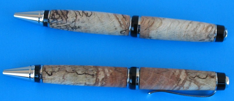

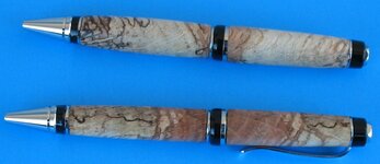

I just recently made two Maj Jr's for friends of mine from a red oak tree they had to cut down near there house. Its pretty corse wood so periodically during turning (sharp tools) I soaked with thin CA. I finished with CA also. It took a bunch of coats but they came out nice and smooth. Hope this helps..
Sorry for the poor pics... not one of my strong points

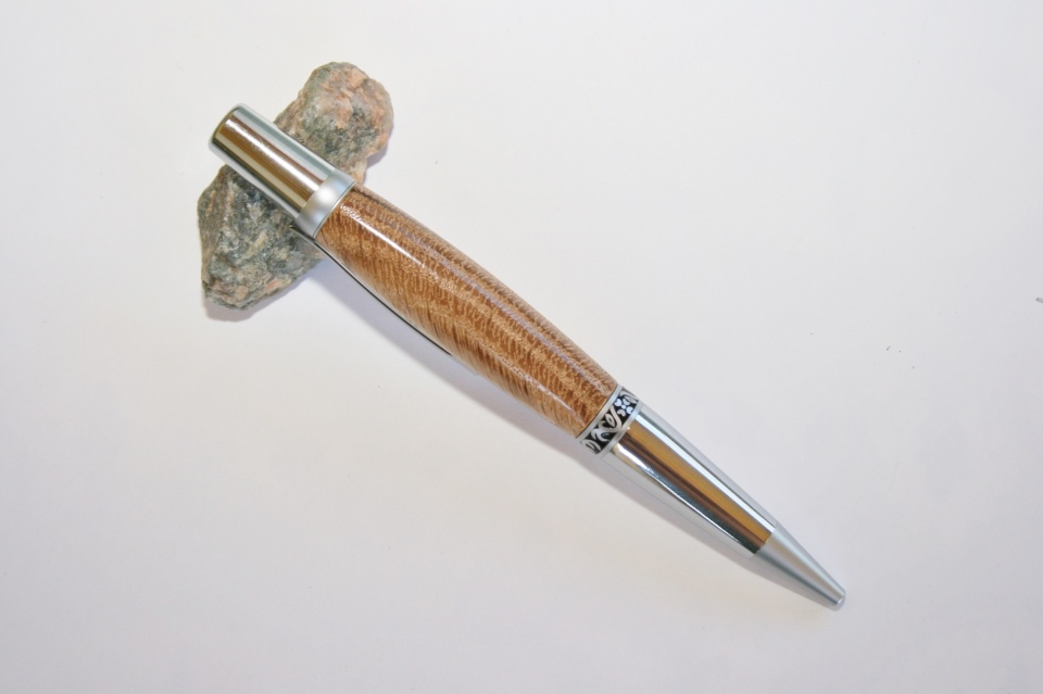

I turned a pen out of cross-cut plain plain old red oak that I got from one of the big box stores years ago. It does not look like plain oak. I've gotten several comments like "now this feels like a wooden pen" about it.

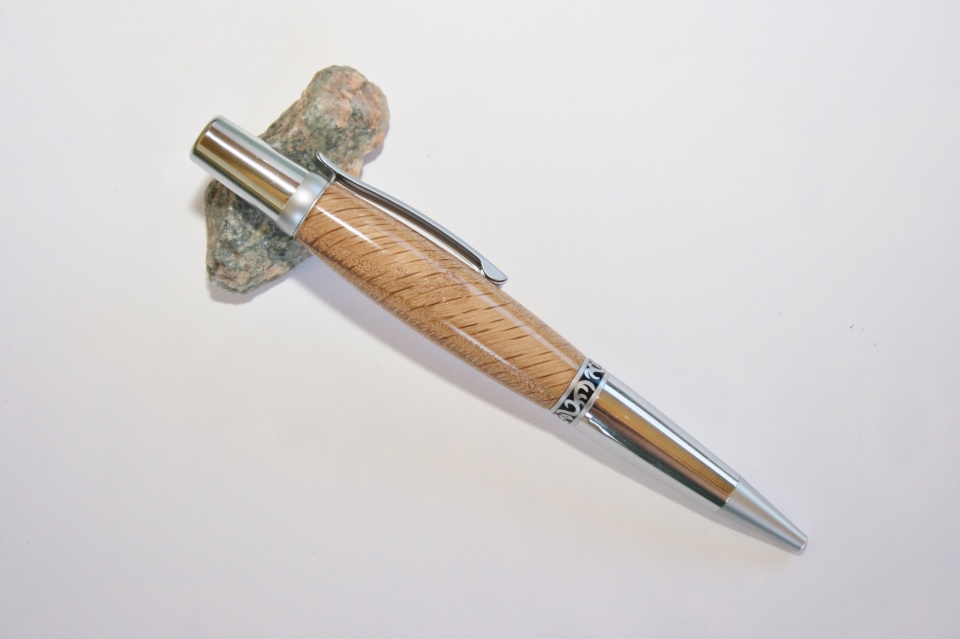

Here is my Red Oak Blank, I took a 3/4" X 3" board and cut a blank at a 45 deg. angle it came out really nice. It going to my brother's wife.
