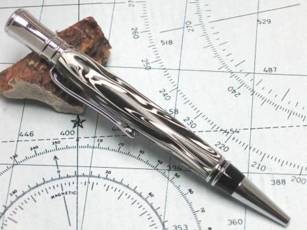

I`ve only done a very few polymer clays, but I turned them all. I agree with the light touch and very sharp tools. Here`s one of my first.
