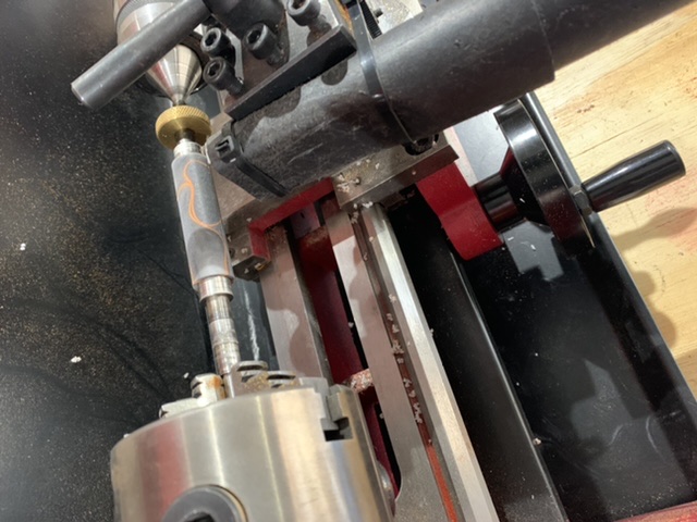

+1 for shopvac, photo of my setup, no issues with strands, all go in vacuum cleaner and lathe stays clean as well.
