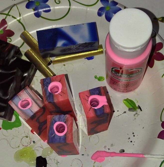

What kind of paint do you use for this? And what hole are you referring to painting? For a multi-colored blank, what color am I trying to match?

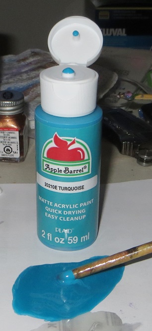

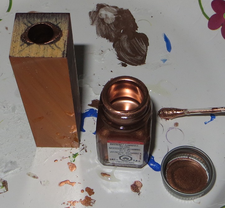

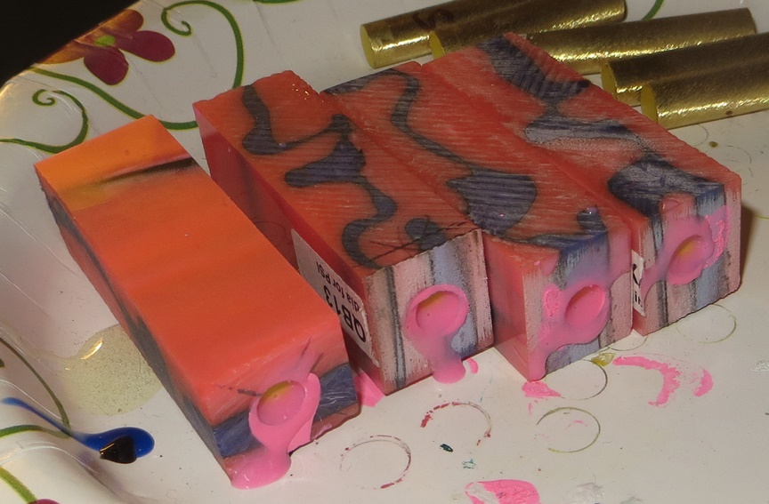

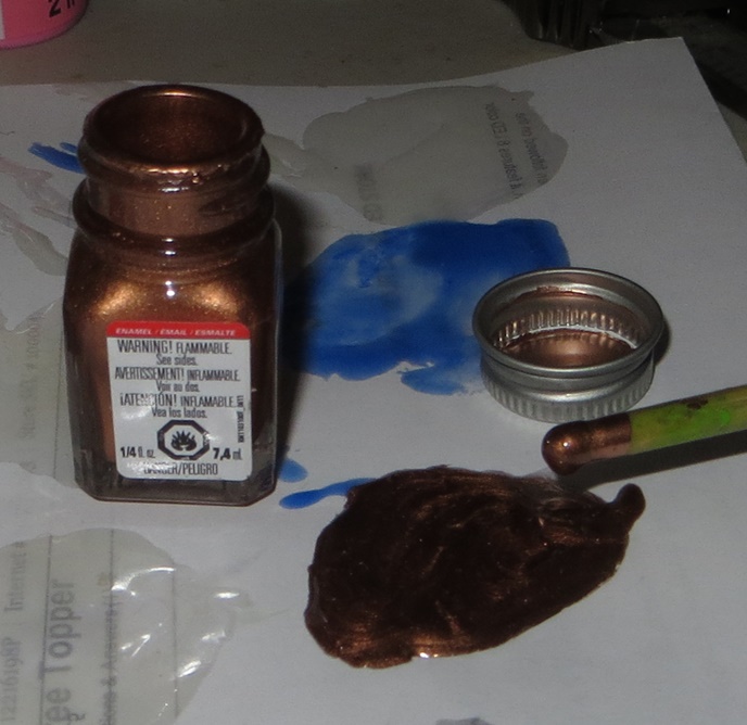

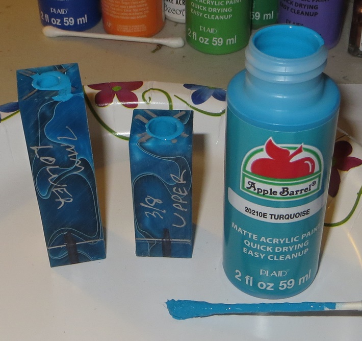

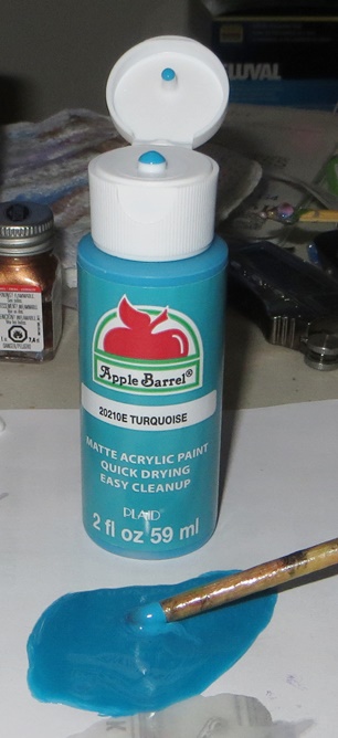

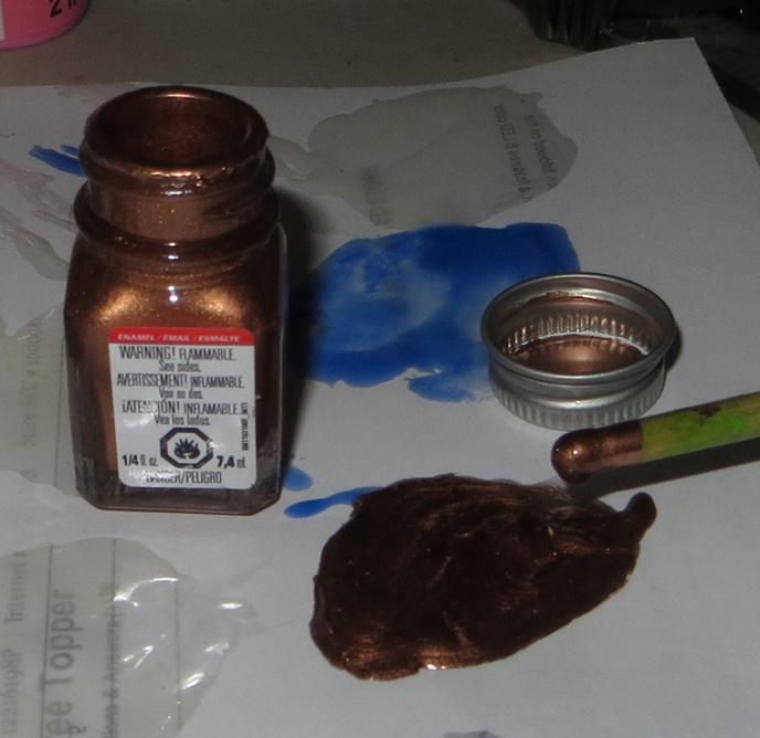

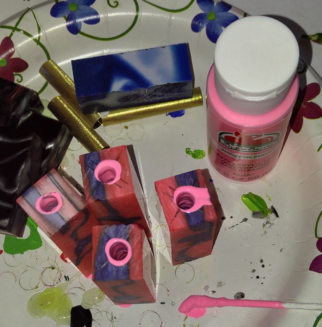

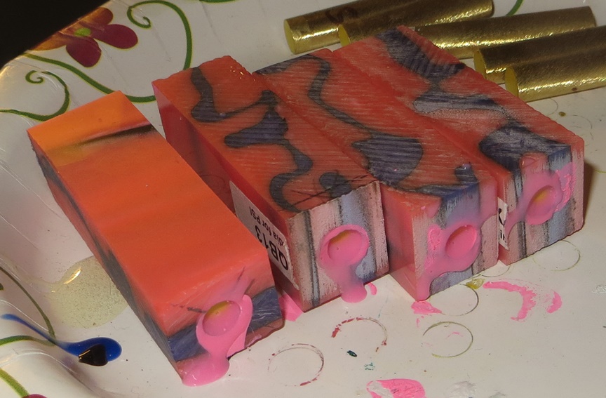

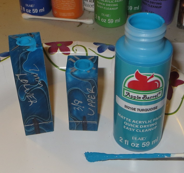

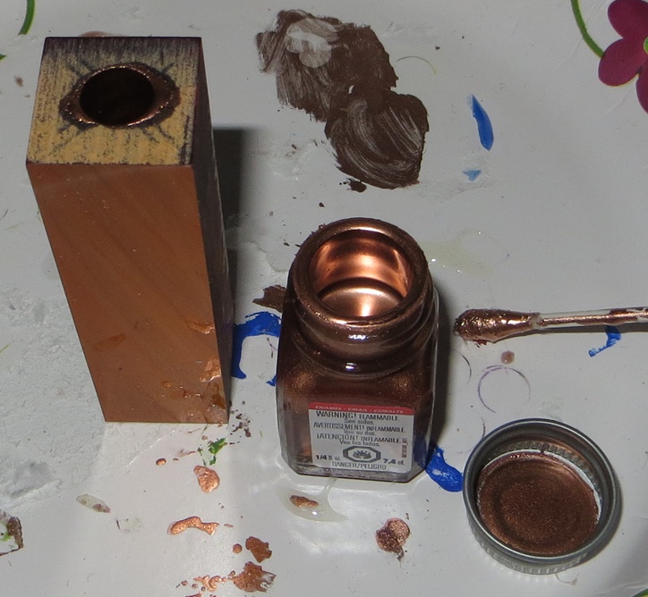

I use acrylic craft paint from WalMart or Michael's. It's 50 cents a bottle at WalMart, and comes in many different colors. I generally try to match the dominant color in the blank. I use a Q-Tip to apply it to the inside of the holes. I leave the blanks standing upright while the paint dries. So far, I haven't had a problem with the tube fitting into the painted holes. I don't paint the tube, but do use the same paint to color the epoxy. Just a drop is all it takes. I've used Testor's enamel paint, but it's more expensive and the acrylic paint seems to work just as well. I've tried just painting the tubes, but you can still see the epoxy through polished translucent blanks.
