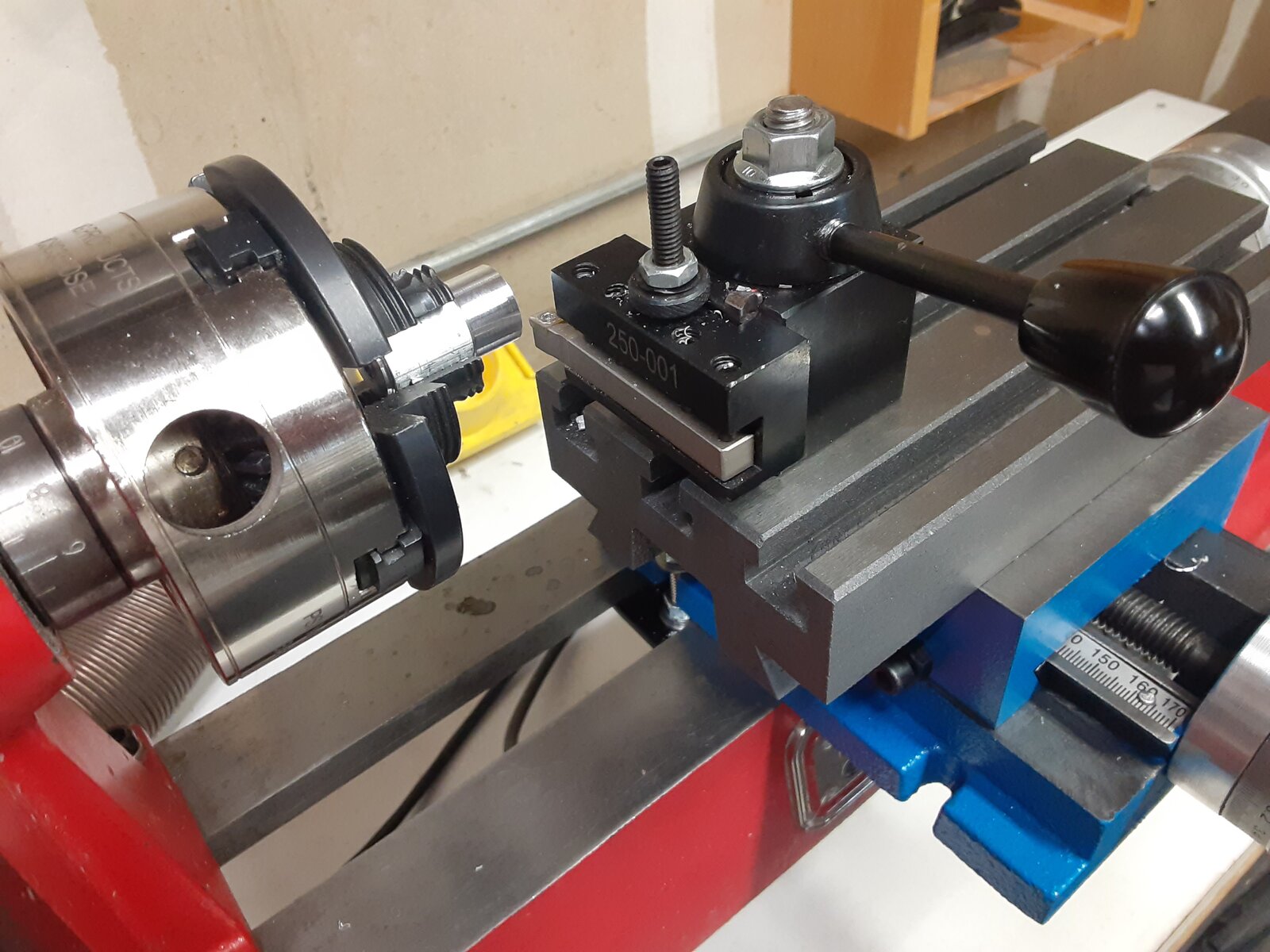

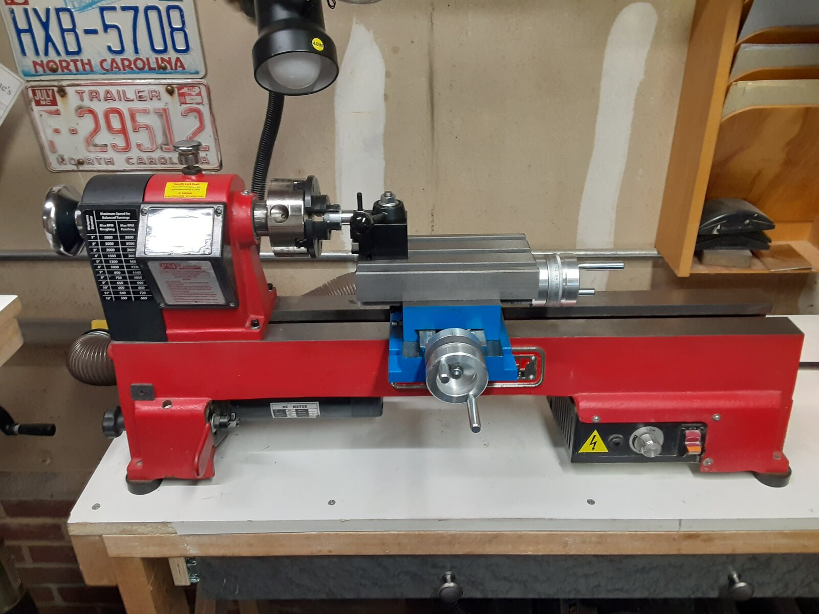

i turn a lot of metal on my turncrafter. added a cross slide and quick change tool post.
View attachment 381844View attachment 381845
Years ago I bought one of those for my Jet. Have never set it up but it was a thought because I was always watching my buddy SkipRat do his thing and some of the turnings he did always amazed me. I still want to circle back to some of his pens and try to duplicate them in honor. What was always great he would show a ton of photos and details of what he did so just need to pull those up again and study. I miss that guy here.
