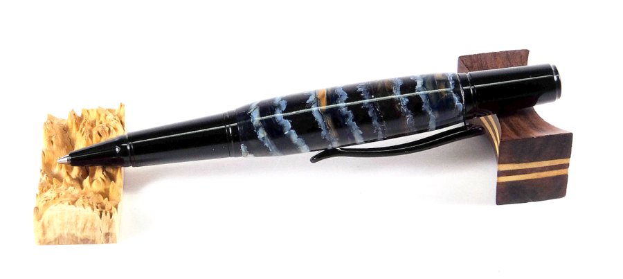

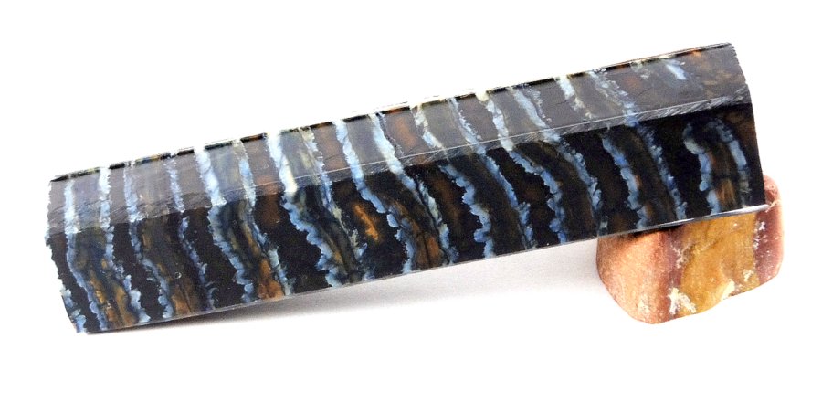

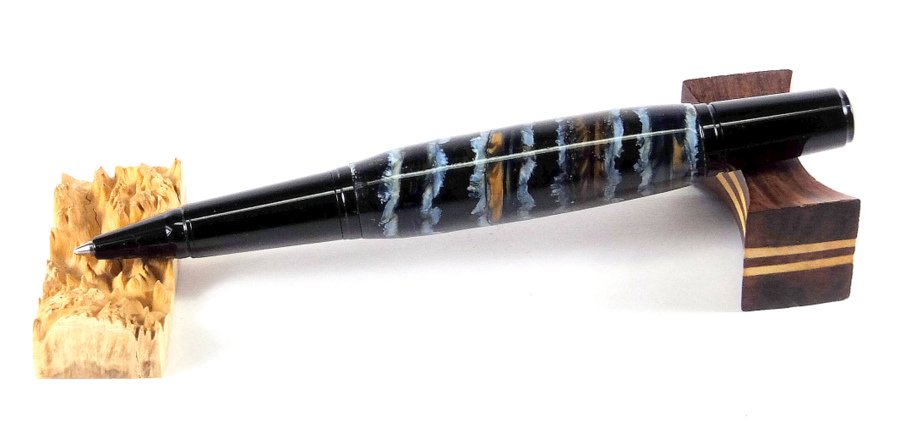

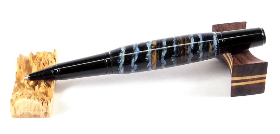

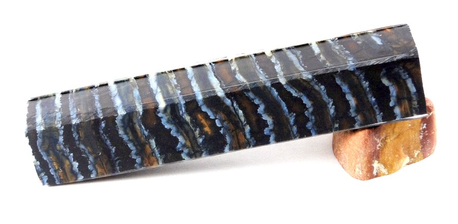

Recently I showed my Wooly Mammoth Tooth Pen on this forum if you can stand repitition here it is------

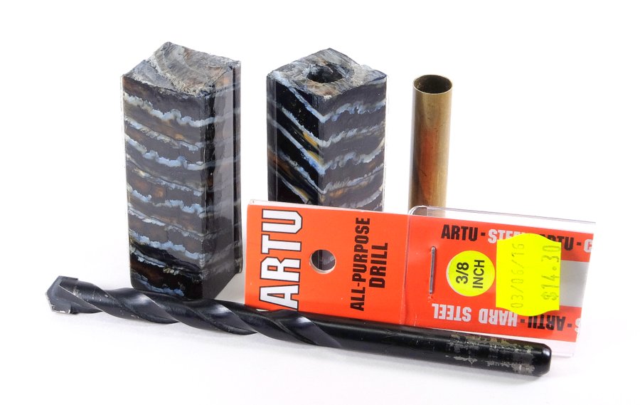

First I cut the tooth using a 4 inch bandsaw,clean as a whistle.
Bought this ARTU drill bit the nearest to size (look them up on Google) available in America.
THen drilled to the needed size with a conventional drill.
I fully recommend squaring the blank,I use a 12 inch sanding disk with punches to size.
Using a 4 way 2 degree 15 mm square Carbide cutter.
It took me 3 1/2 hrs to turn but I am making a machine by adaption to do the next one.
My blank had a Cobolt Blue colour because it was found in Cobalt Country.
Good luck, great care and have fun.
Peter.

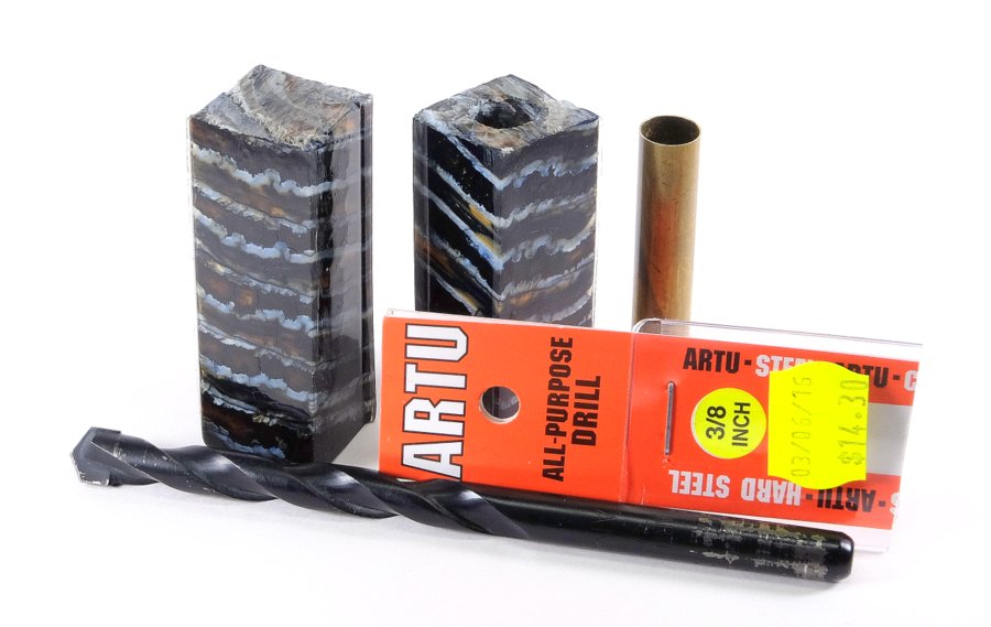

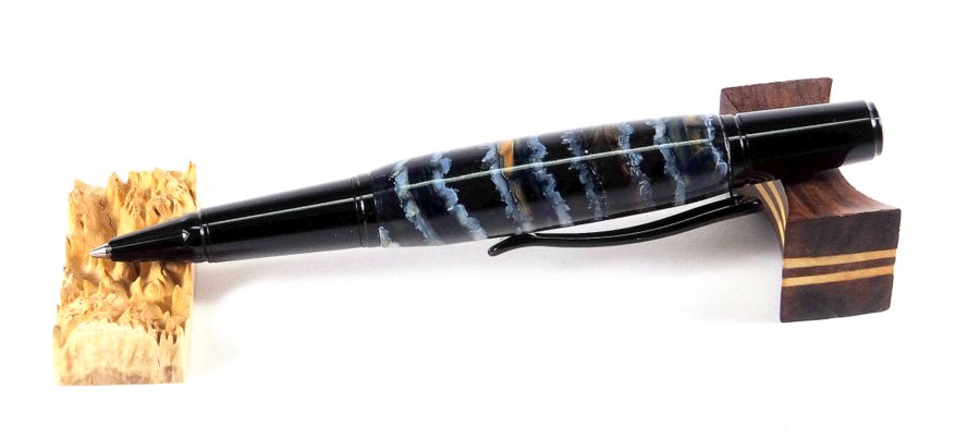

Peter.
Peter, was your blank stabilized? How did you keep it cool while drilling and turning?
Beautiful pen!
Danny
Sent from my iPad using Penturners.org mobile app
Drilling no probs using the nearest sized Artu drill then conventional drill to size. I used as shown the Carburundum ,one 4 way cutter it took hrs of turning. There are bands of glass that slow the process somewhat. As the 4 way cutters blunted they were removed and placed flat down on a diamond file. I chose to have this shape as it is precious material.
Available via Internet in Canada from Russia sources. I gave the other half of the blank to my mate Pierre who lives in Paris France. It was a great experience.
Peter.
