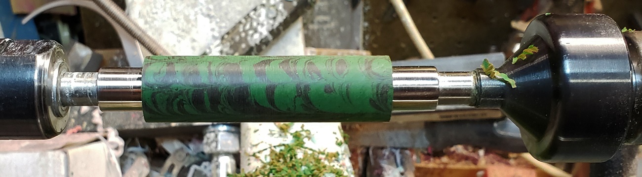

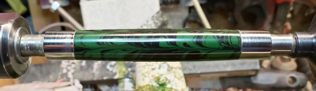

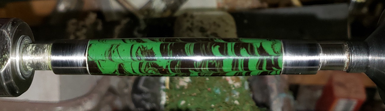

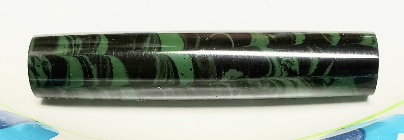

I'll be turning my first Ebonite today. I got the blank from PSI. Any tips or tricks for finishing it? Should I just use my normal acrylic finishing regimen?

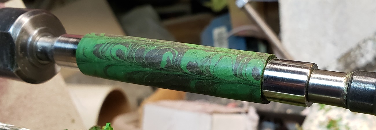

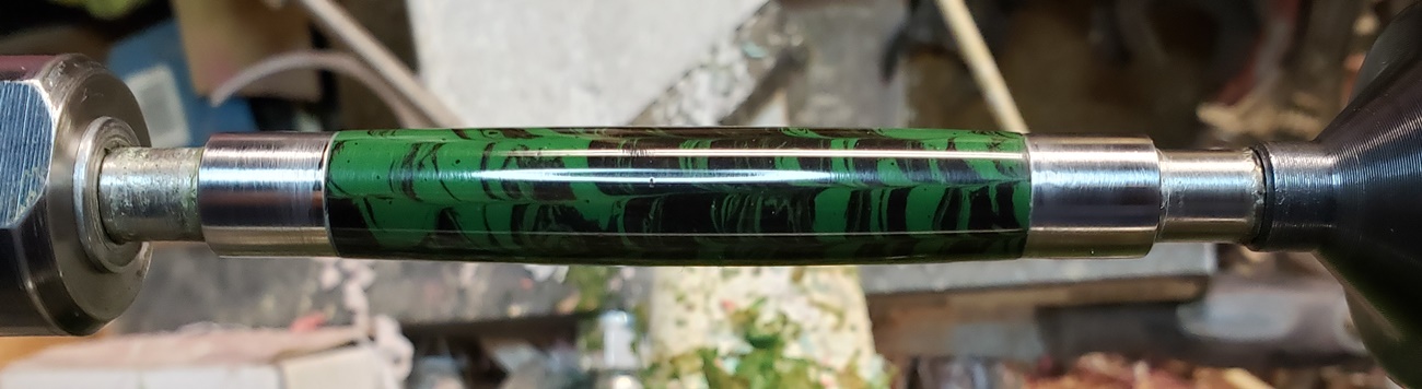

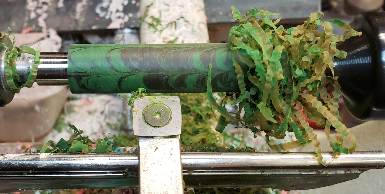

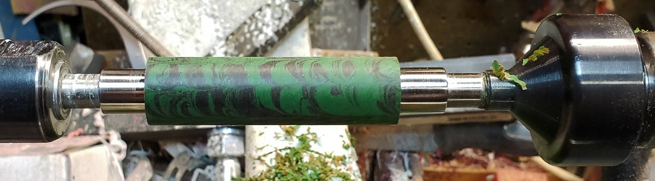

Well, I've found that carbide cuts it much better than my HSS chisels. But the more I turn it, the less I like it. I'll finish it, though, and see how it looks.

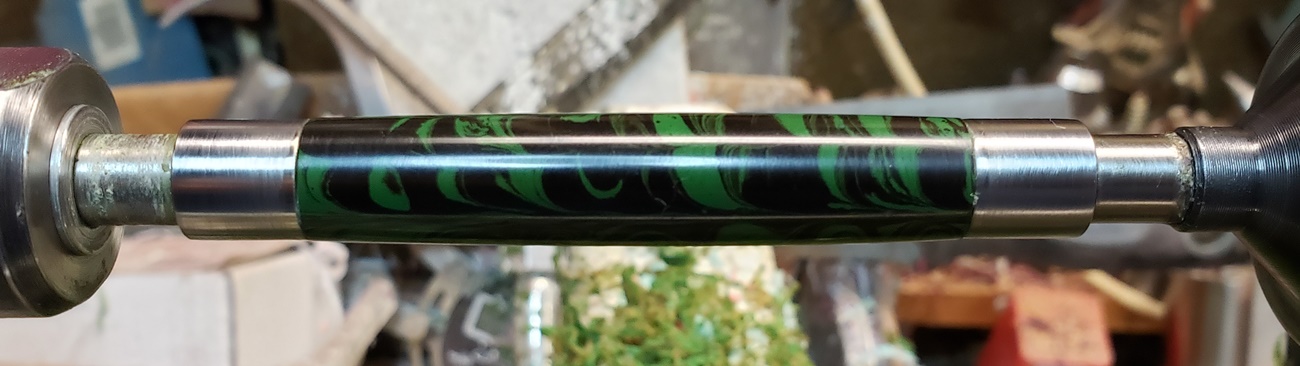

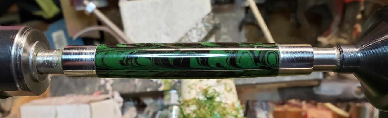

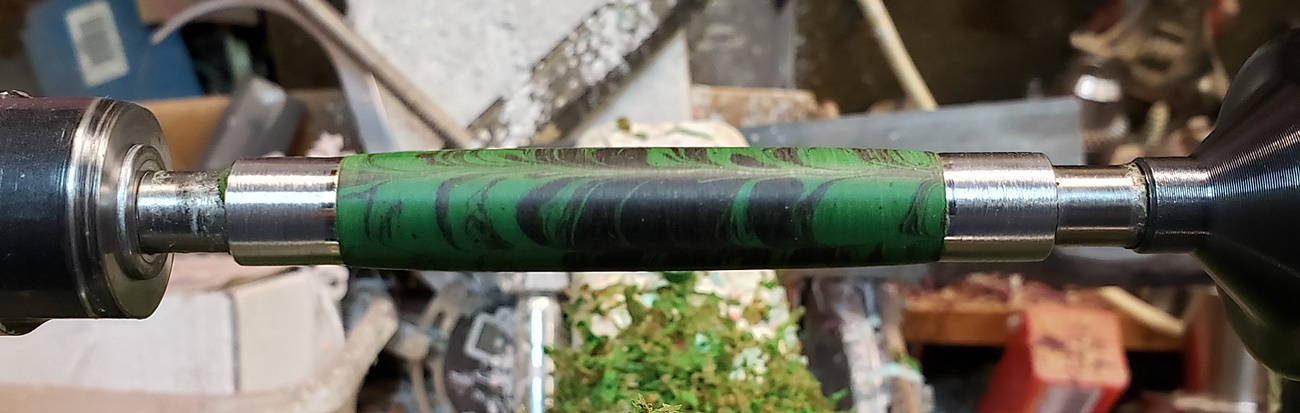

Man this stuff stinks. It's chattering a bit, too. Don't know why. Overall, I'd say I'm not impressed with Ebonite.

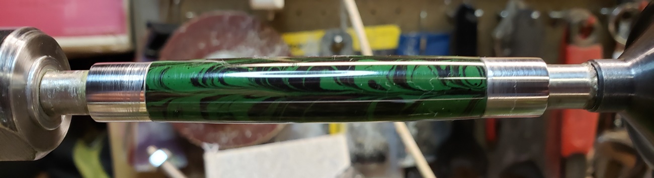

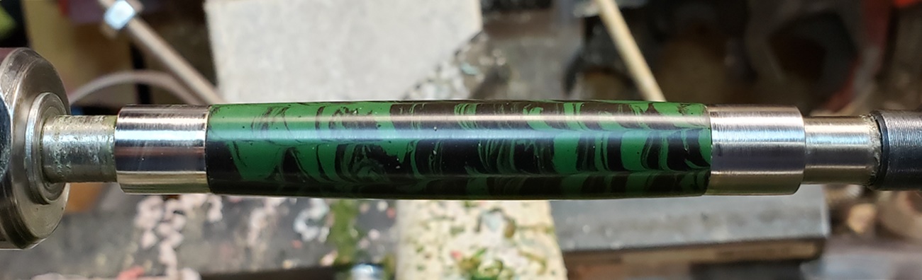

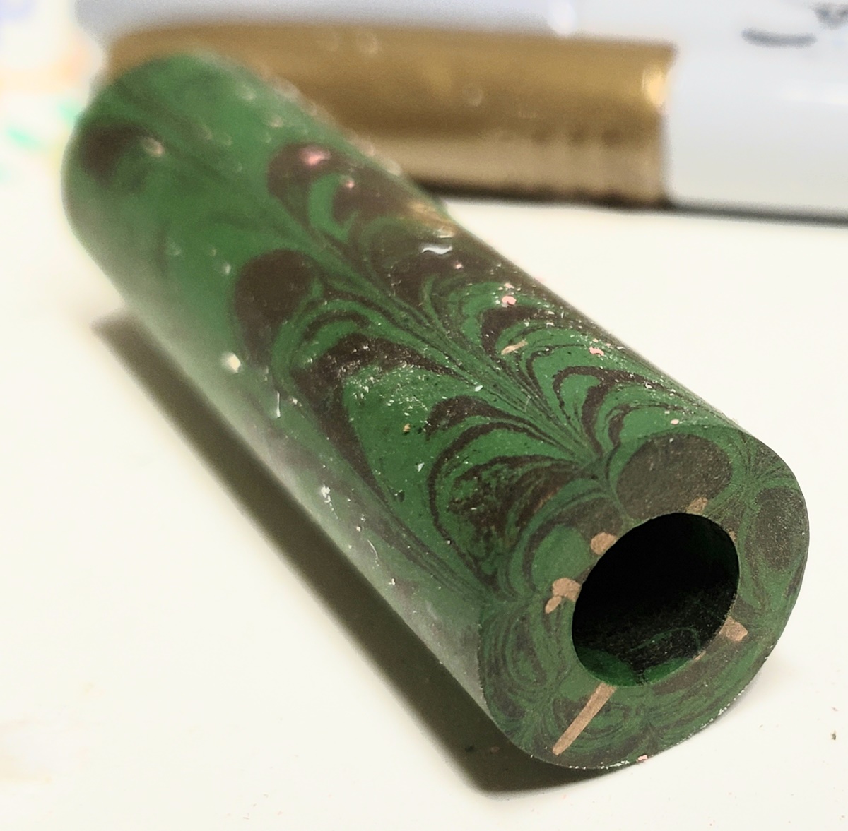

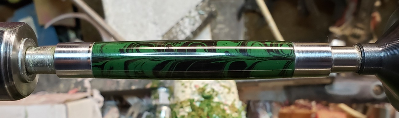

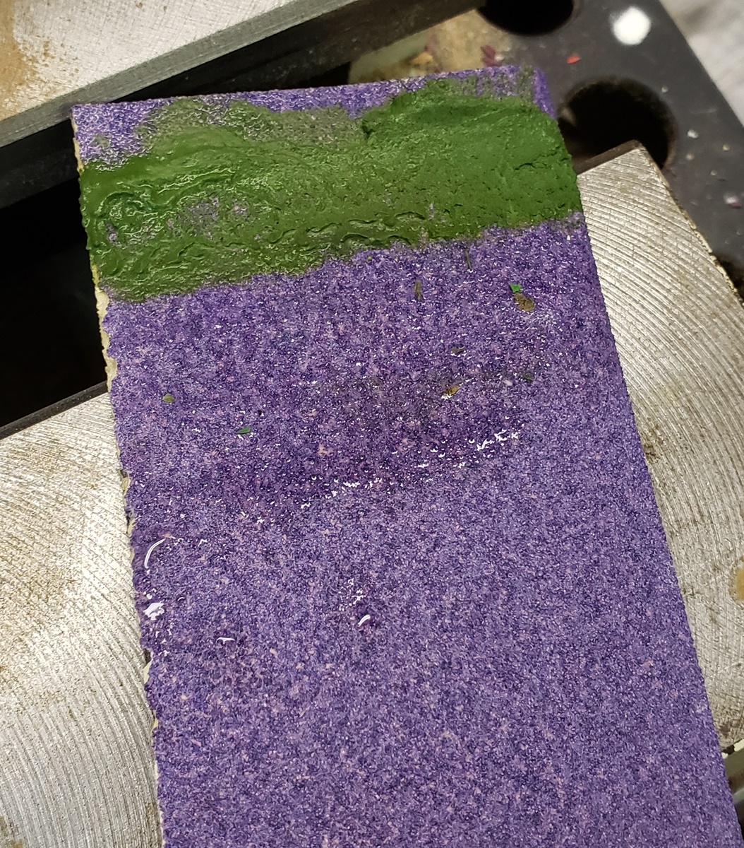

Well, it polished up pretty good with my usual procedure, but not quite as good as most acrylics. I think it's ugly, but my sister likes it, so I'll probably assemble the pen with it.
I wet sanded with 100 grit, then 220-600 grits. Then the three grades of Dr. Kirk's, and finally PlastX.

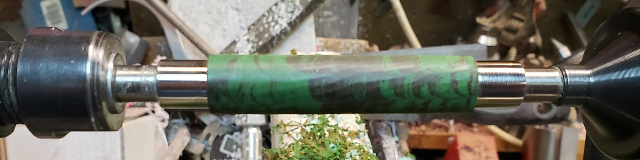

Just for fun, I ran it through all nine grades of Micro Mesh, then polished it again with PlastX. I don't see a difference. There are still visible micro scratches if you look close in bright light. Still, it polished better than I expected for an old bowling ball.
