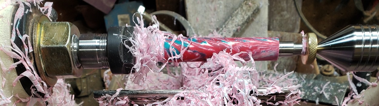

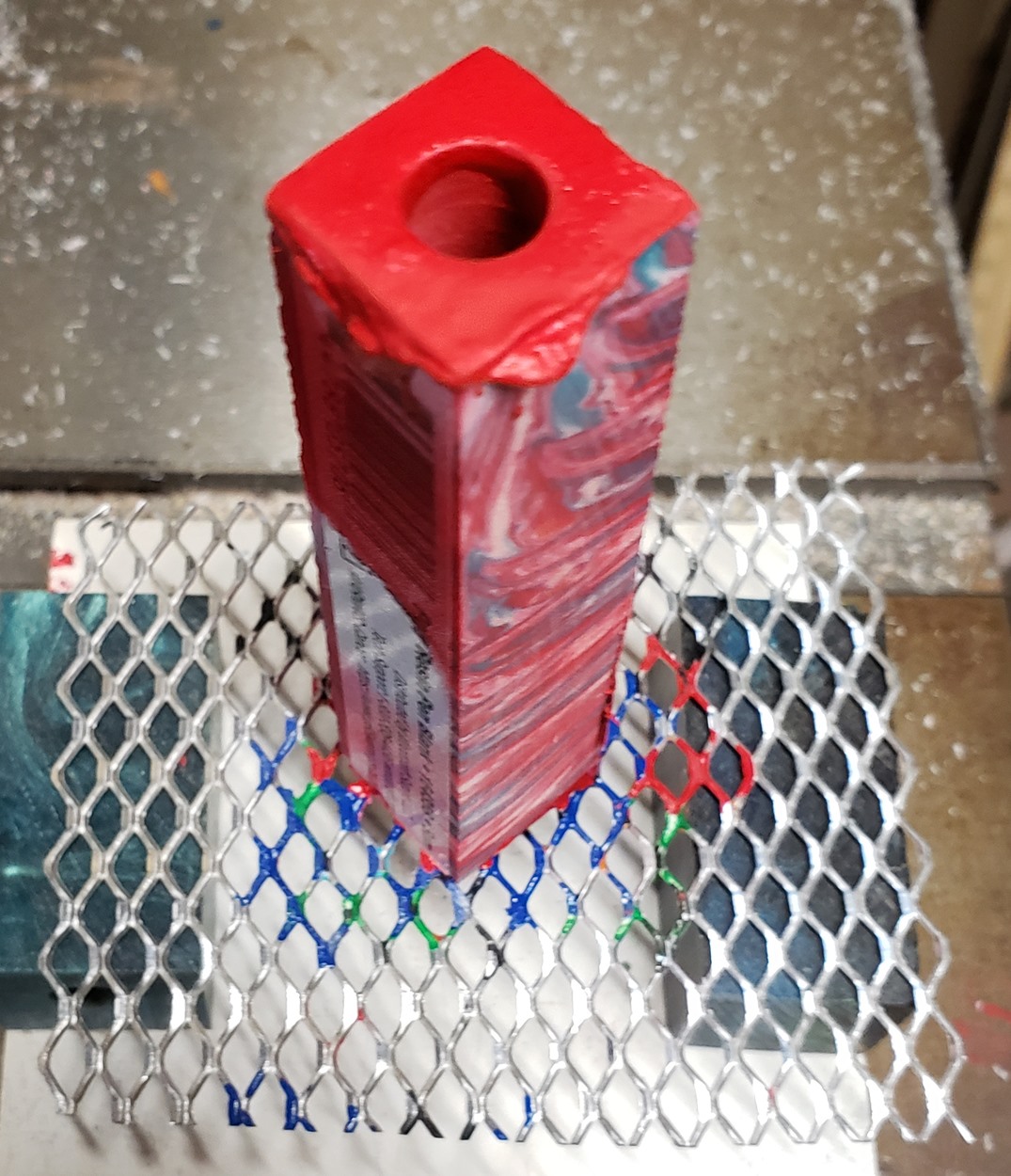

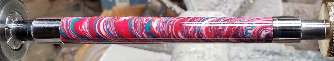

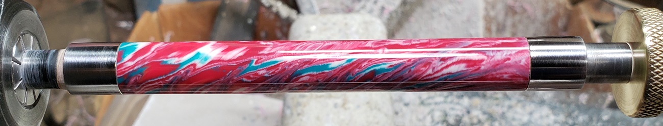

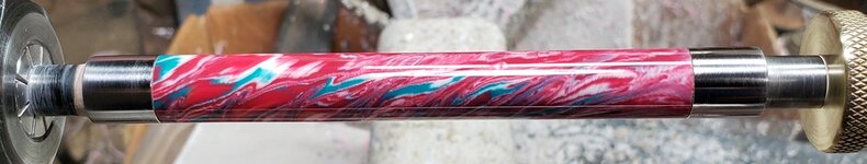

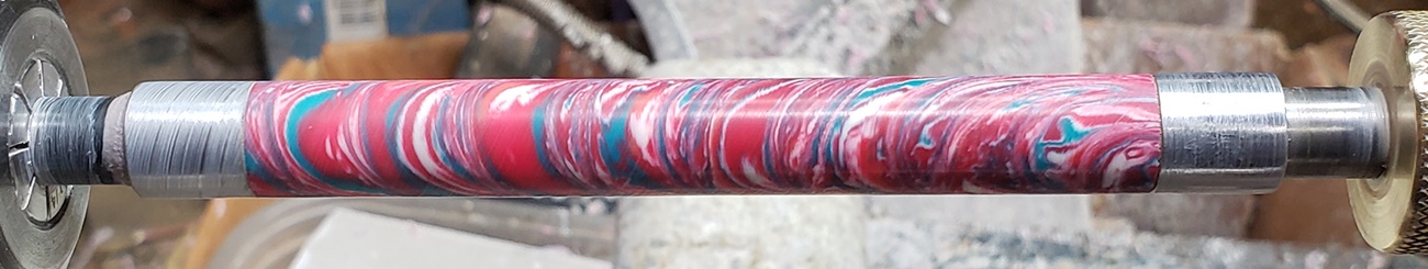

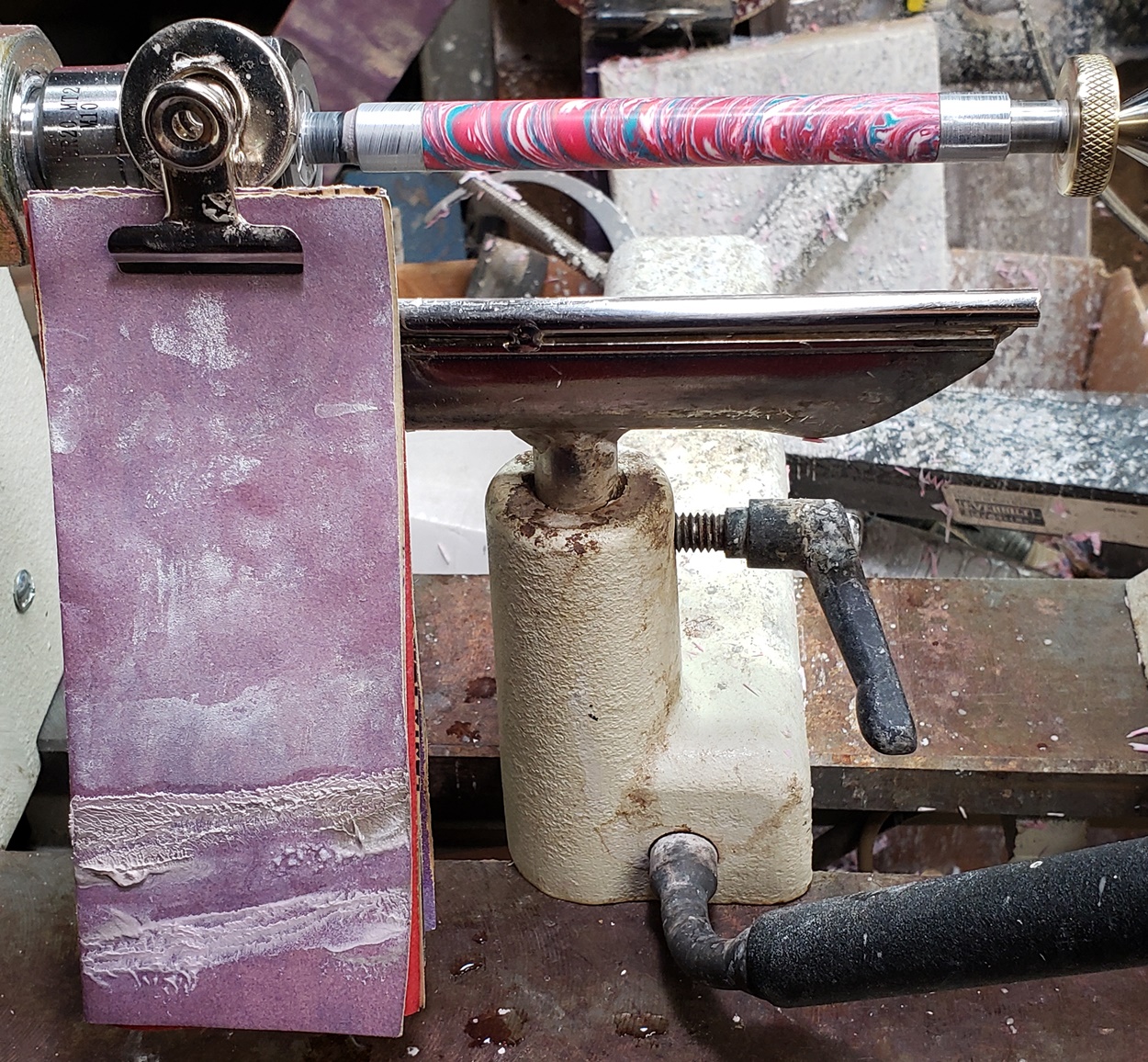

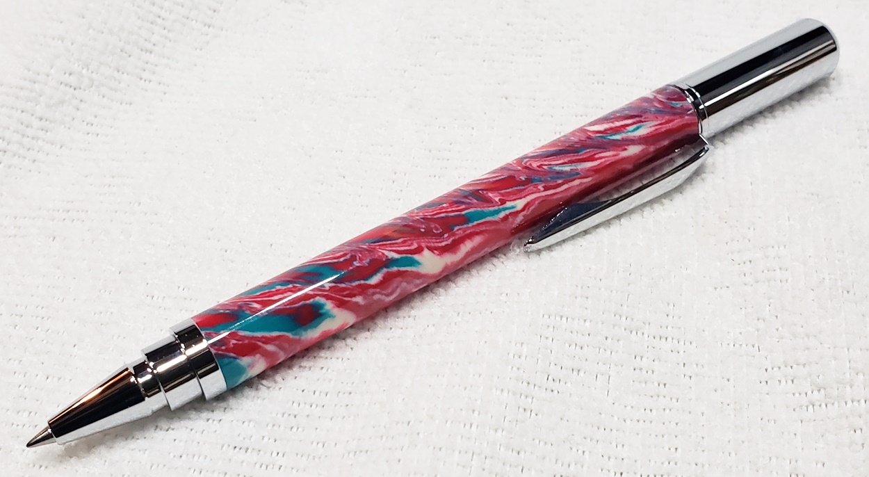

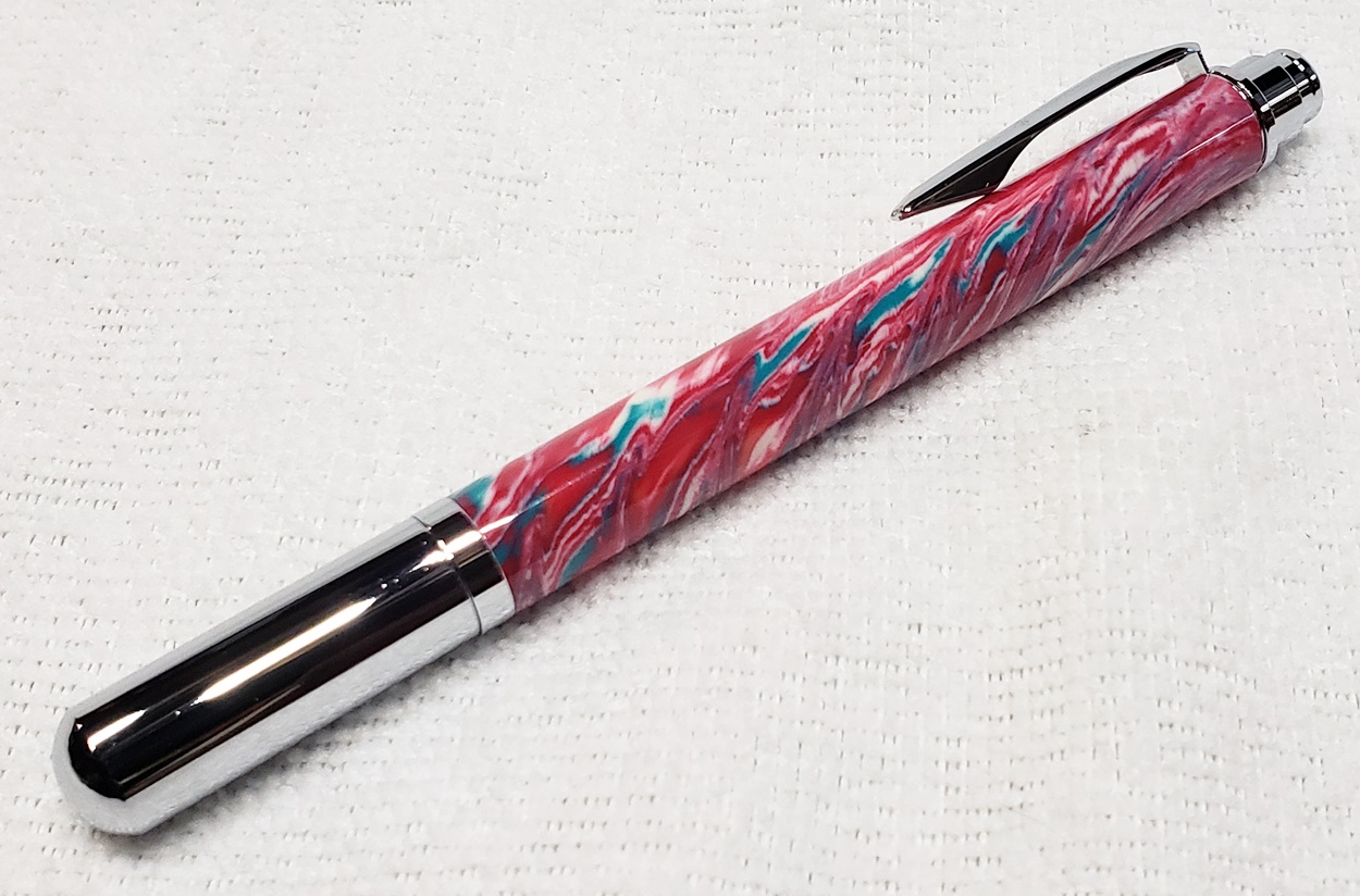

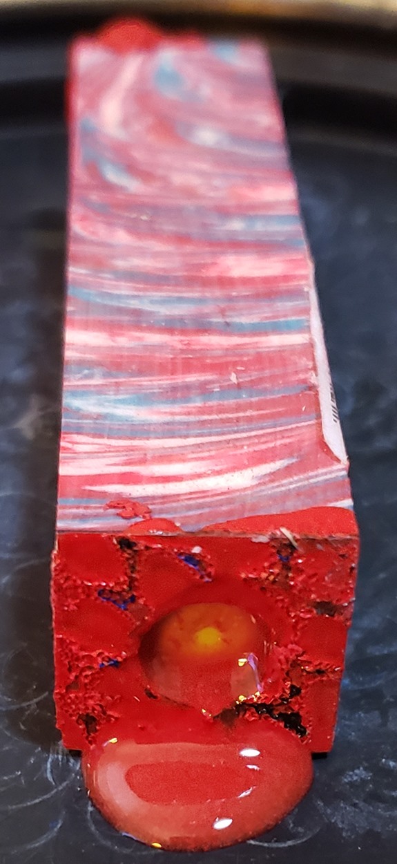

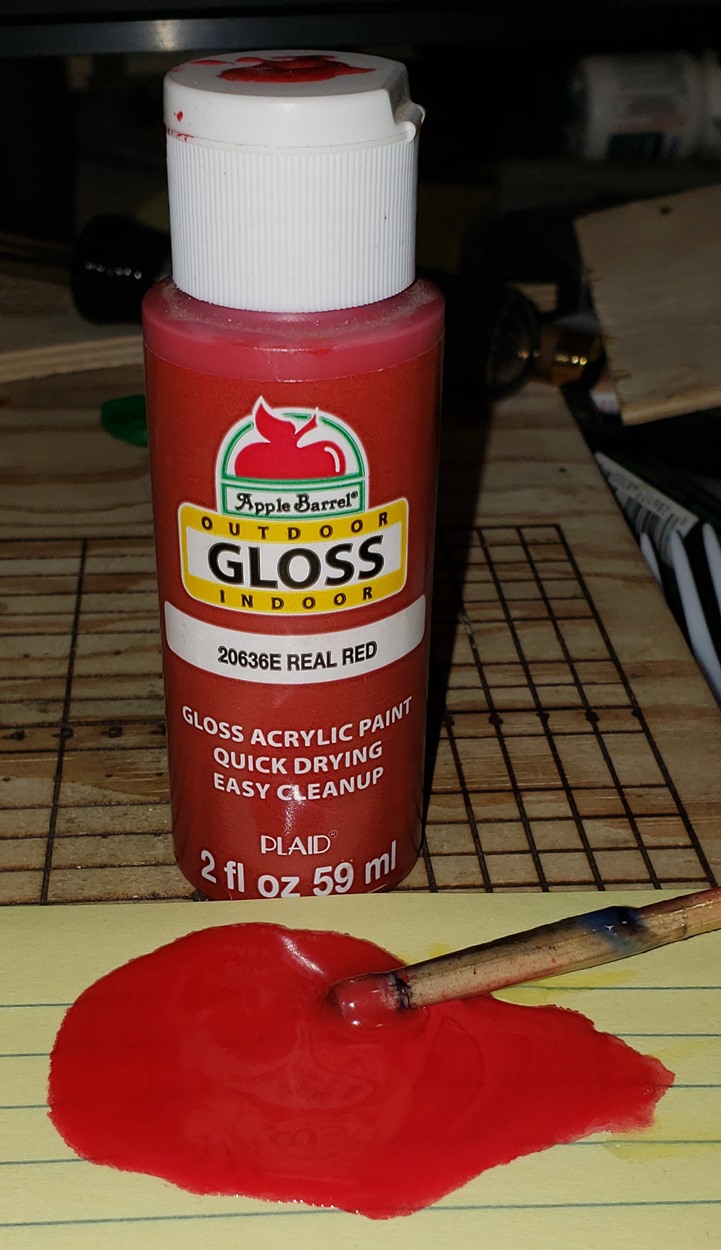

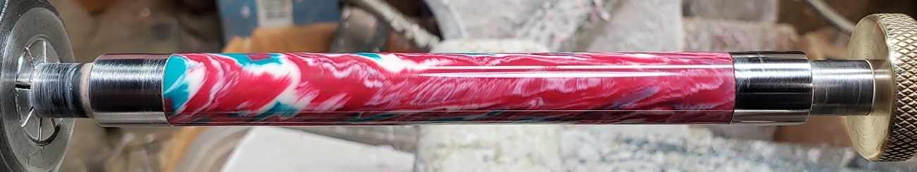

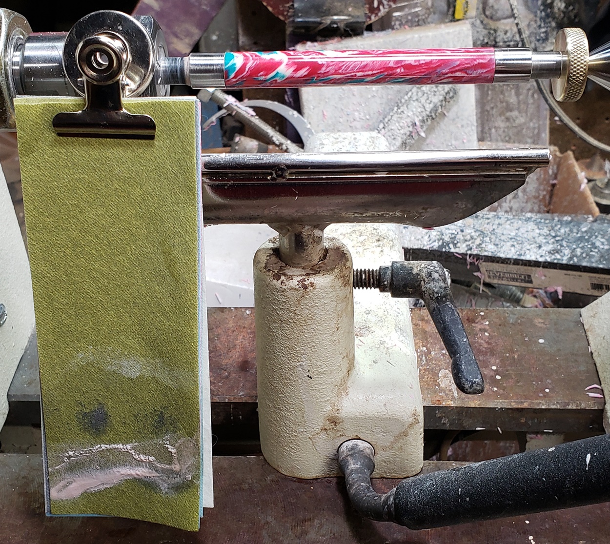

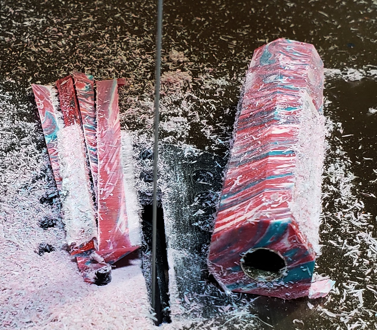

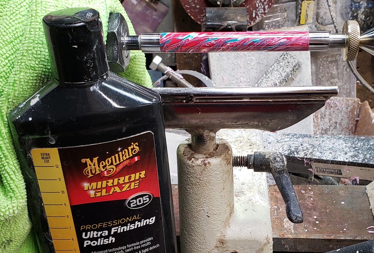

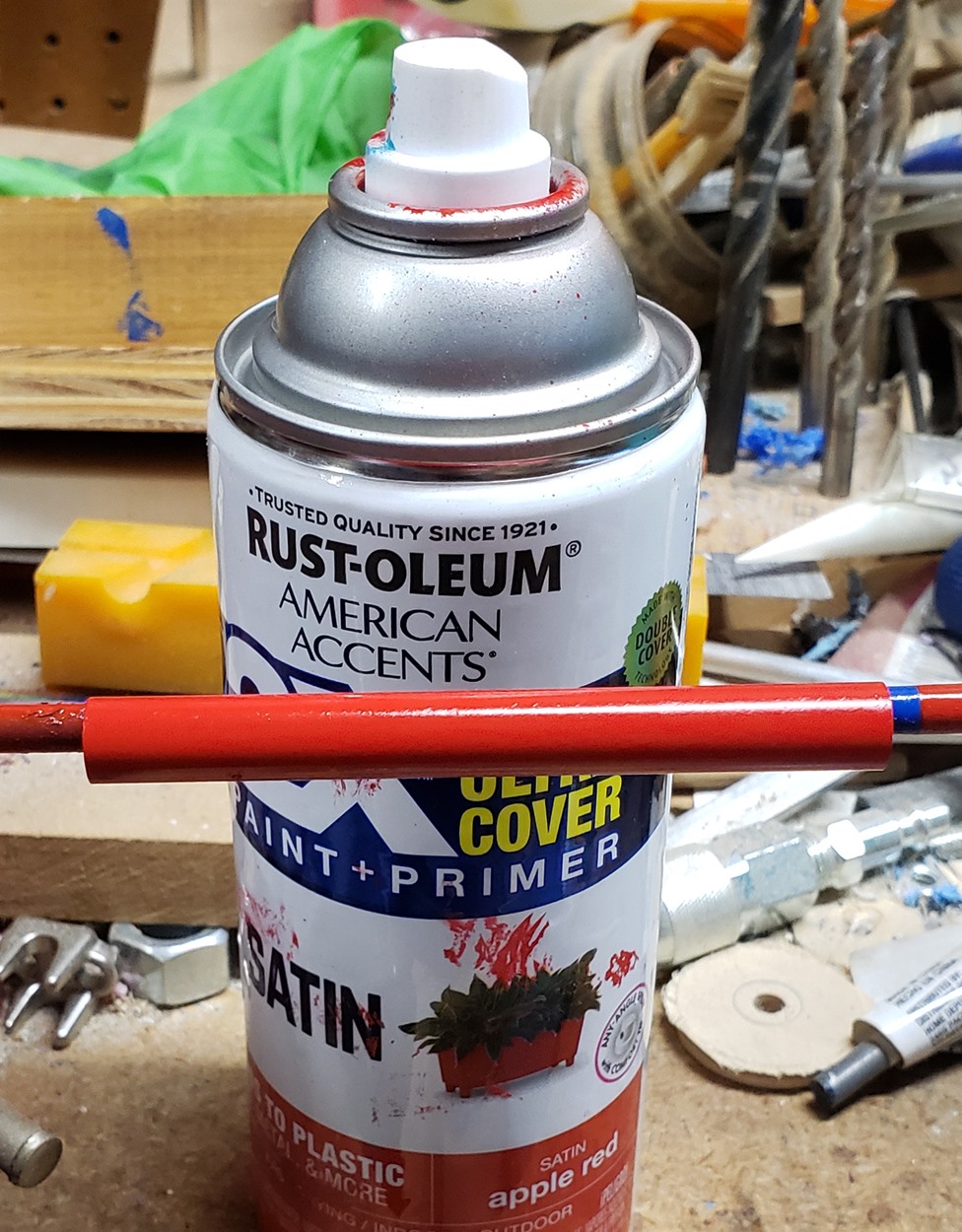

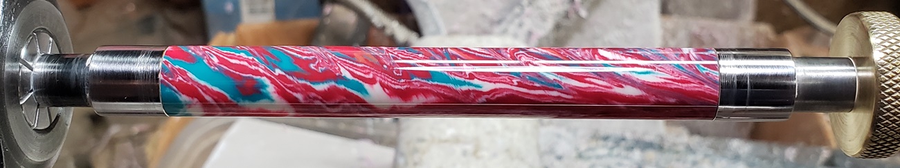

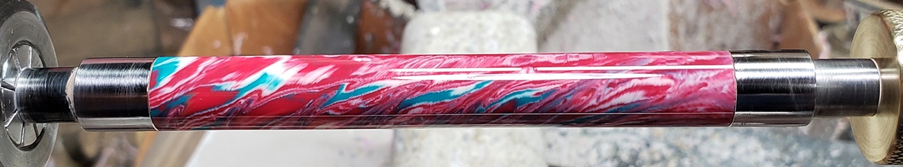

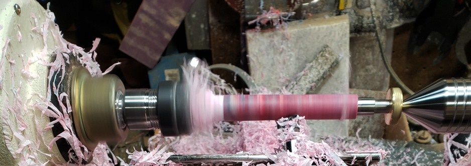

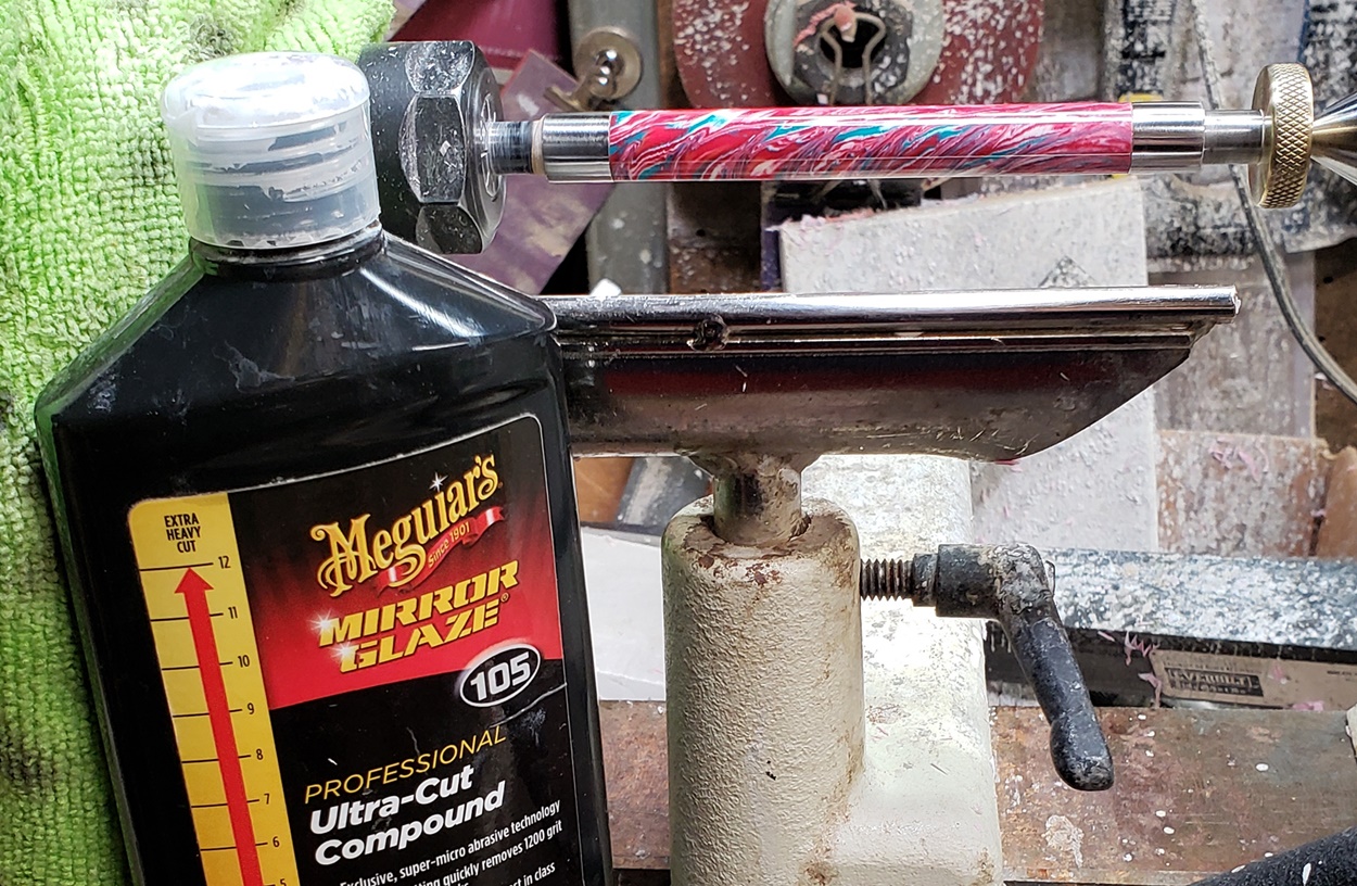

I have turned poly resin blanks from Woodcraft. I'm assuming poly is short for polyester. I found them to be more brittle than some acrylics, but not as brittle as inlace acrylester. I turn and finish them the same as any other acrylic blank. Paint the blank and tube, and color the epoxy. Trim the corners before roughing. Carbide chisel held at an angle to get a shearing cut. My usual polishing regimen: wet sandpaper; 3M Zona polishing paper, all six grades; Meguiar's 105 and 205 liquid polishes applied with a microfiber towel. They all turned out great.
