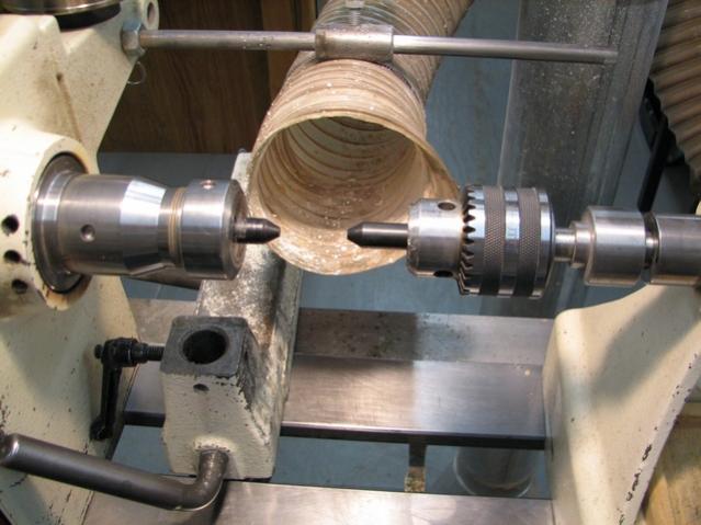

I make my own centers out of Delrin.
I use a revolving drill chuck in the tailstock.
It really works great, the Delrin grips better than metal and the glue comes right off.:wink:

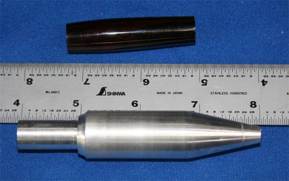

Hey fellows: IF you have bushings made for a mandrel, it does NOT matter what the degree of angle of the LC or DC you use!
Below: Definitely not 60°. I made my first Dead Center well over 2 years ago.
If you use JohnnyCNC's bushings, they do require the 60° centers.
But normal bushings made for mandrels do not. Even stating that, I do not recommend the normal bushings as they are not made anywhere near the tolerances that John's are.
