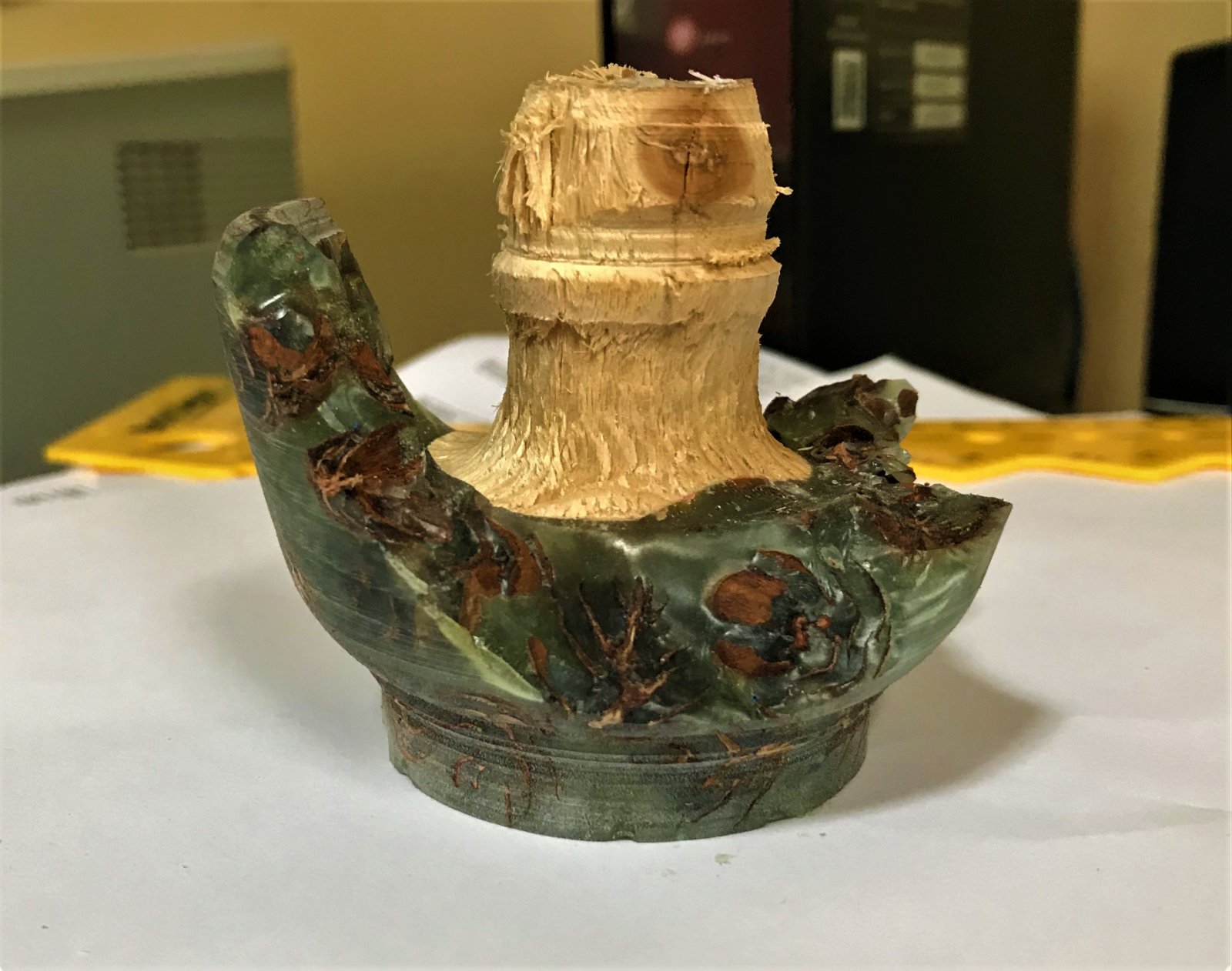

So, here's why you always undercut your tenon, even when you're using serrated jaws. I just assumed the resin would give enough "bite" to hold it and I got careless. It was going to be such a beautiful pine cone and resin bowl... I wonder what I can do with this chuck?

Gary, it is very unfortunate failure, but fortunately you didn't injure yourself when it happened. As for the piece that is left, either throw it out, or place it somewhere for a reminder of it happening.

Learning what not to do without bleeding is often more valuable than completing another bowl. All that read this post will be reminded of a 101 lesson, a proper tenon is always mandatory. Thanks for the refresher.
Perhaps a pen blank out of the bottom?
Unfortunately, I have a core of wood all the way down to the bottom (to save resin) that gets turned out. And I only used a pieced of 2x4, so nothing interesting. Maybe I'll just break the pieces up and throw them into my next bowl cast.
Gary
My preferred tenon and jaws are Dovetail....especially on resin.
Yeah, I'm still learning the subtleties of turning resin bowls. I had just assumed that my serrated jaw chuck would hold the resin well. And it did, right up until it didn't. I have another one to turn today, I'm going to use the dovetail jaws on it.

In addition to using dovetail jaws, it appears that the bowl curves all the way to the tenon. This doesn't give the top of the jaws a proper place to sit against your piece. You need a flat surface so the top of the jaws fully sit against the bottom of the piece. there shouldn't be any gap between the top of the jaws and your piece.
It's also hard to tell how big the tenon is. Did it bottom out in the chuck (it shouldn't ). Did the jaws close enough, to the almost fully closed position as they should?
...........And I only used a pieced of 2x4, so nothing interesting. Gary
- I don't think a pc of pine, esp an old 2x4 would be my first choice for the core. Think I would have used a pc of hardwood instead. Looks to me like the chuck was trying to do its job but the soft wood just turned in the chuck and splintered. ?
The tenon didn't bottom on the chuck, I knew enough to not do that. The jaws closed almost fully like they should have. But I didn't have the top face of the jaws rest on a flat on the bottom like you said. That said, from now on I'm going to do these resin bowls in my dovetail jaws, not the straight serrated one.
- ebill
I've experimented with these a bit. On some, I used a hardwood core all the way to the bottom. On this one, I actually built the bottom up with the mini pine cones, and set the pine core on top. The tenon held, it was when I was turning out the core that the blank let loose from the chuck, that's why the pine looks splintered. I've also done a few where I make a circle out of 5/8 pine and put it in the bottom of the cup I'm casting in. This piece essentially becomes the tenon. I'm having better luck with that method.

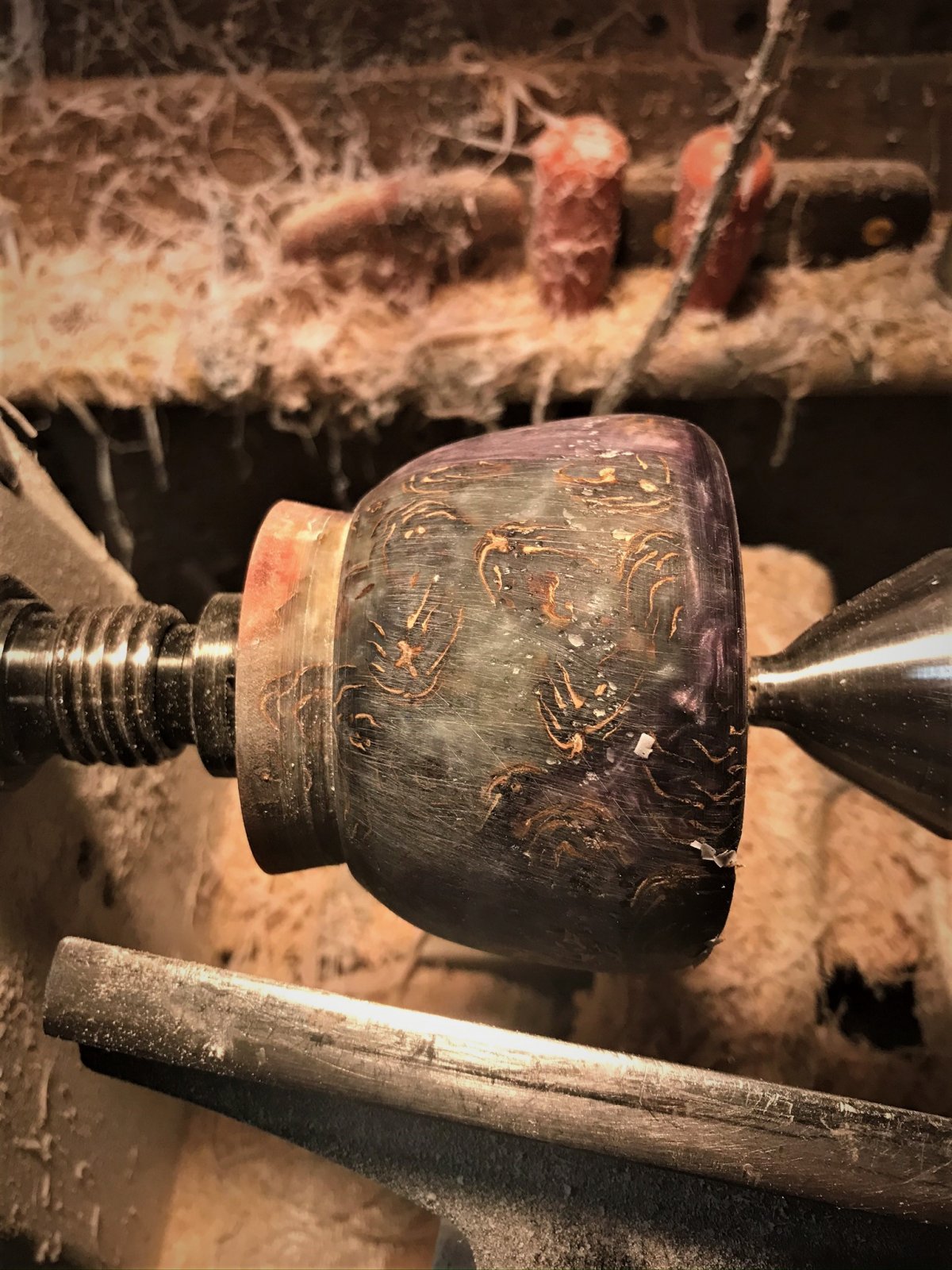

So, I took the remaining piece (shown in the first photo) and recast it. I knew I wouldn't match the color very well, so I contrasted it with a more purple look. Here it is so far, it doesn't look too bad.
