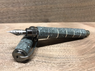

The only issue I have experienced with Corian was during assembly. It cracked when pressing the cap together on a graduate. Luckily the pen was segmented and I just removed the cracked section. I sanded the brass tube for less tight fit and used a drop if CA to ensure it wouldn't come apart. I've been using it for awhile now, no issues. Cheers.
