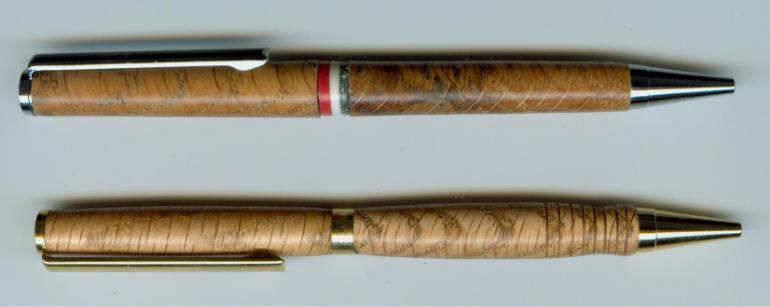

Hugo here is a couple of oak pens i made with a bias cut i am not sure of the exact angle cause i cut these ones freehand on the bandsaw i think it is somewhere in the neighborhood of 45 deg. tho. hope this helps. Bud

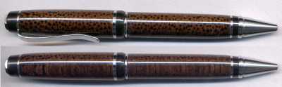

AS you have found out,the difference can be likened to the difference between a regular table top and a butcher block table.
I love the look.
Because you get "end grain" twice in a revolution of the pen you get the chatoylence of the grain.
Once finished and polished it's gorgeous.
I have two rollerballs and a coconut palm in my album here(I hope):
http://www.penturners.org/forum/photo_album_view.asp?cname=Main+Album&mid=402&cid=423&page=2
The roller balls were turned out of Bocote whis is a beautiful wood to begin with.
As you gan see the grain on the rollerballs looks tike a tiger "eye"
