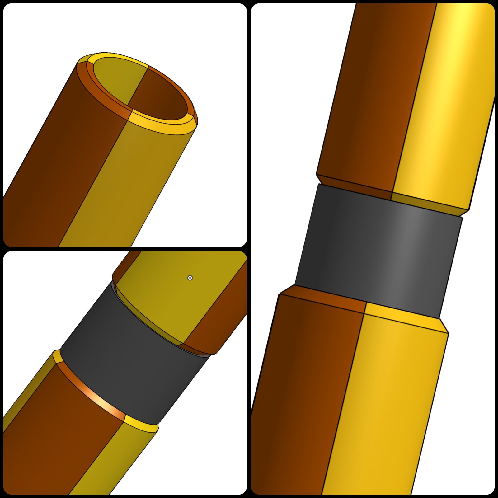

I had the same problem in the past. I just now just turn them a bit bigger than bushings. Also,its good to use non-metalic bushings for sanding, to prevent metal dust gettin into the wood pores. I made a "card sander" which is simply a card size cut of paper box with 400 grit sandpaper glued on both sides, and I use it to make a small filet on both ends of finished pieces. It may sound funny,but that filet makes wonders,give it a try:)
sounds interesting, can you share a photo?
Im not geting back to my workshop until saturday, but I made you a little drawing to explain:) Note the different diameter of wooden parts
