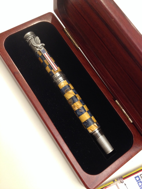

I have found that the dust caused by sanding may get "ground" into surrounding materials. I really notice this when I use aluminum with my segments, the fine gray dust will change the color of light wood. I've discovered a few tips along the way. Tape off sections you don't want affected. Sand in segments, don't go back and forth across color boundaries. I also have found light coats of CA will seal the surface and it won't discolor. IMG_2321.JPG
I noticed when I was finishing this pen, the blue dyed box elder dust from sanding caused the yellow box elder to turn gray. But once I added a thin coat of CA to seal both woods, I got clean results.
Hope that helps, post some pictures so we can see what you experiencing.

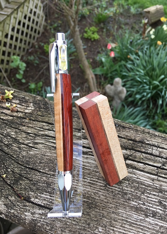

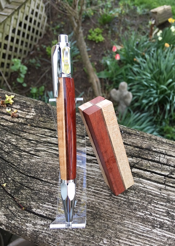

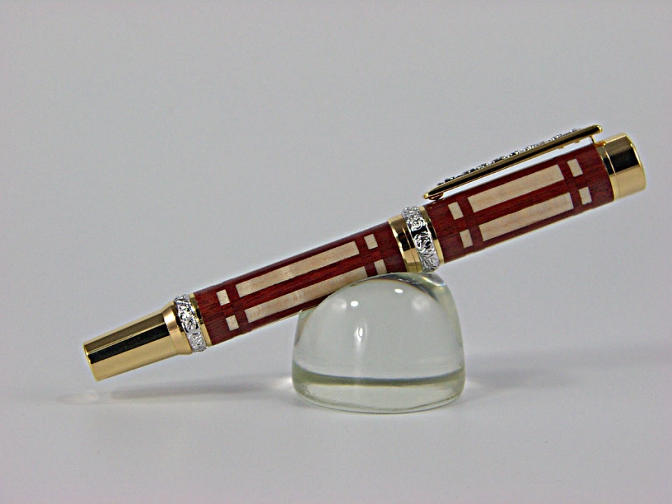

Grinding sanding dust into blanks is what drove me to learn how to use my skew chisel to finish with. My first red/white/blue spectraply ended up red/white/pinkish gray so I learned how to sharpen and use the skew for a finish cut. Rarely use sandpaper now, just micromesh after applying a finish.
As Ed mentioned, some woods will bleed into others even just gluing them together. The pic below was going to be bloodwood & curly maple, but I knew i'd get bleeding so I put a walnut veneer between them. If i'd sanded, i'd have still gotten the bloodwood color on the maple, but with the skew all the colors stayed where they belonged.

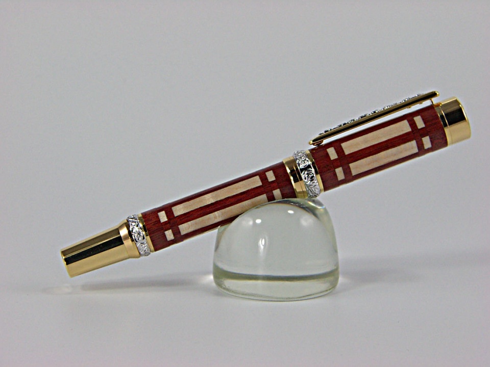

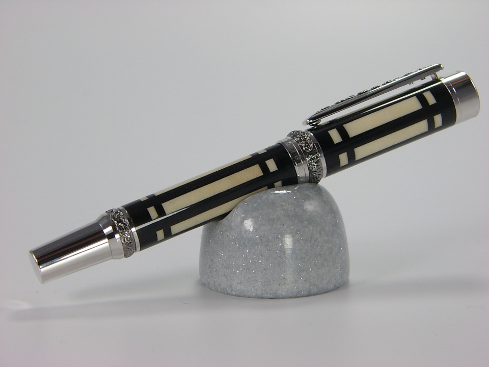

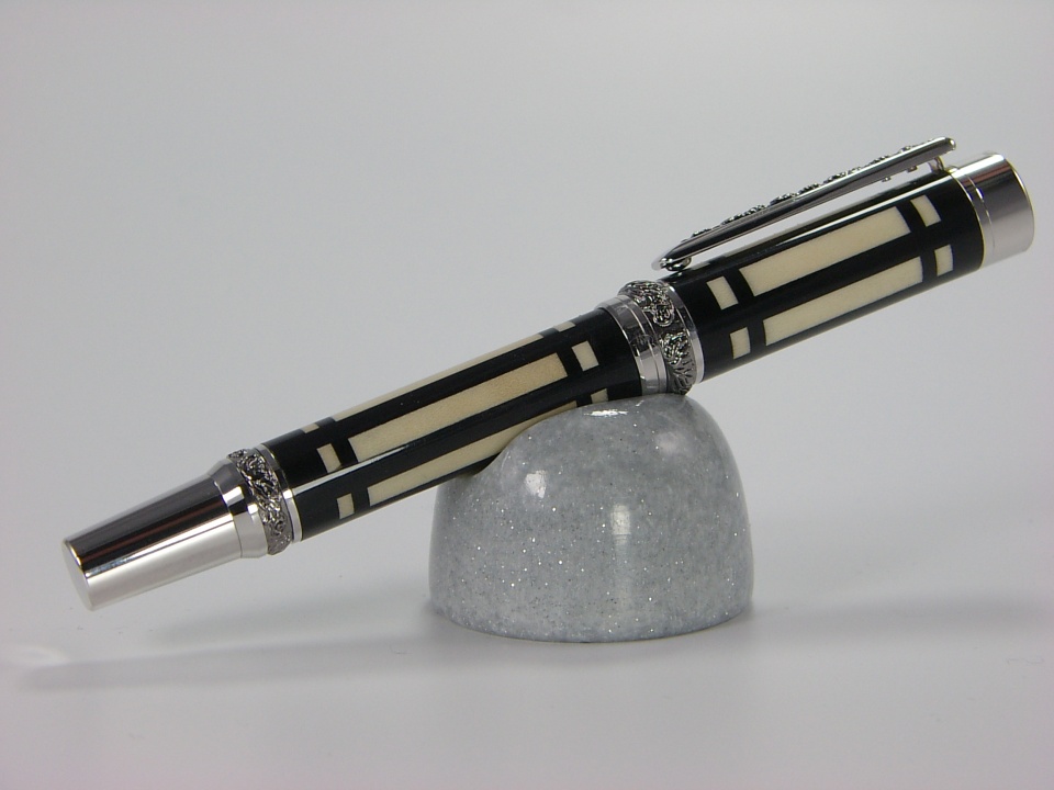

I will second what Earl said. I have said this here many times when this comes up and i continue to show these two photos because they are great examples of woods that can be murder next to each other if sanded. I preach many times to learn how to use the most efficient tool in a turners arsenal and that is the skew. It really is not that hard to learn to use. There are a ton of videos on the net that show sharpening and angles of sharpening and also the presentation of the tool to the work. Just google them and you will get a real education and learn the proper way to use this tool.
But the black and white woods are Gabon ebony and Holly and the red is Bloodwood and Maple. No they will not bleed when you glue them next to each other. I use titebondII wood glue when gluing wood to wood. What I will suggest is when you turn the woods of choice down to shape with the skew to very lightly make one pass with thin CA and do not press hard. Do not clean with acetone or alchol or mineral spirits before applying CA because then you will have runs. I segment with all kinds of woods acrylics and metals and have not had any problems. Good luck and learn the skew. Alan Lacer is a good person to learn from if you can find his videos. I shape all my skews after his design and eliminates catches.
