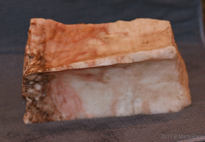

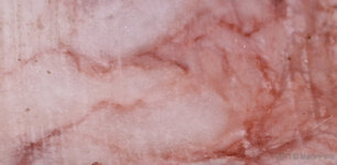

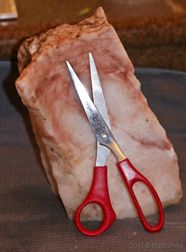

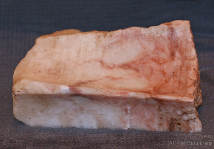

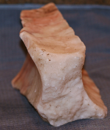

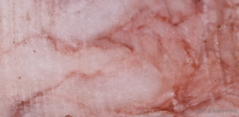

I have a 6.5 lb block of white Alibaster with some pink in it. It is basically 8 x 2 x 4 (removing the wings).
After reading about all it takes to turn one of these and get the grit out of everything, I'm not sure I'm up for it.
Any suggestions of someone whom I could send the block to and maybe get a round blank in return?
If you have worked with Alabaster, is this block figured enough (in your opinion) to even bother with? There is probably much nicer stuff out there. I may end up giving it away.

Well of you're just giving it away I would be happy to take it off your hands and give it a go. :-) I think its quite nice but then again I know nothing about alabaster so my opinion probably isn't worth much. :-)

By the way, that looks like a pretty piece of alabaster, well worth you giving it a try. Might want to look here:

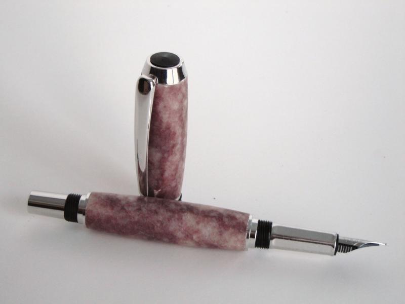

That is nice alabaster. I have done a few pens with alabaster and they take a little extra care, but the results are worth it. I taped the blank to drill it to keep it from shattering. Didn't help, but no one noticed the place that I glued it back together with ca. I turned it with a woodchuck using a older insert. The customer thought that it was great and will take any more fps that I turn from any other stone blanks I can find.
I posted a raspberry alabaster pen that I turned.
I also did a white alabaster but wasn't able to find a picture. I know, no picture, didn't happen, but I already cashed the check. If you would like to sell a few blanks, I would be interested.

Will likely post it for sale or trade tonight in the appropriate forum. I'm just not interested in messing with it. I have many other creative irons in the fire. Will have to see what this piece will go for.
Martin
