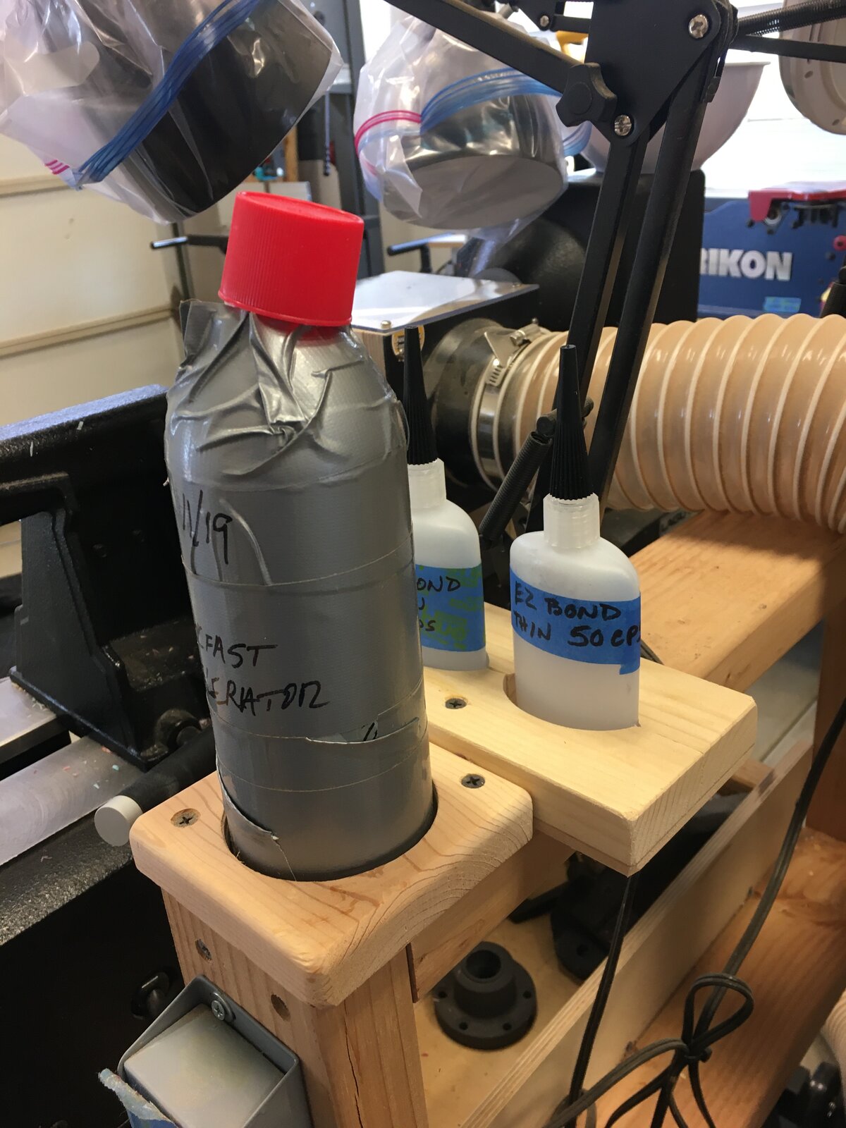

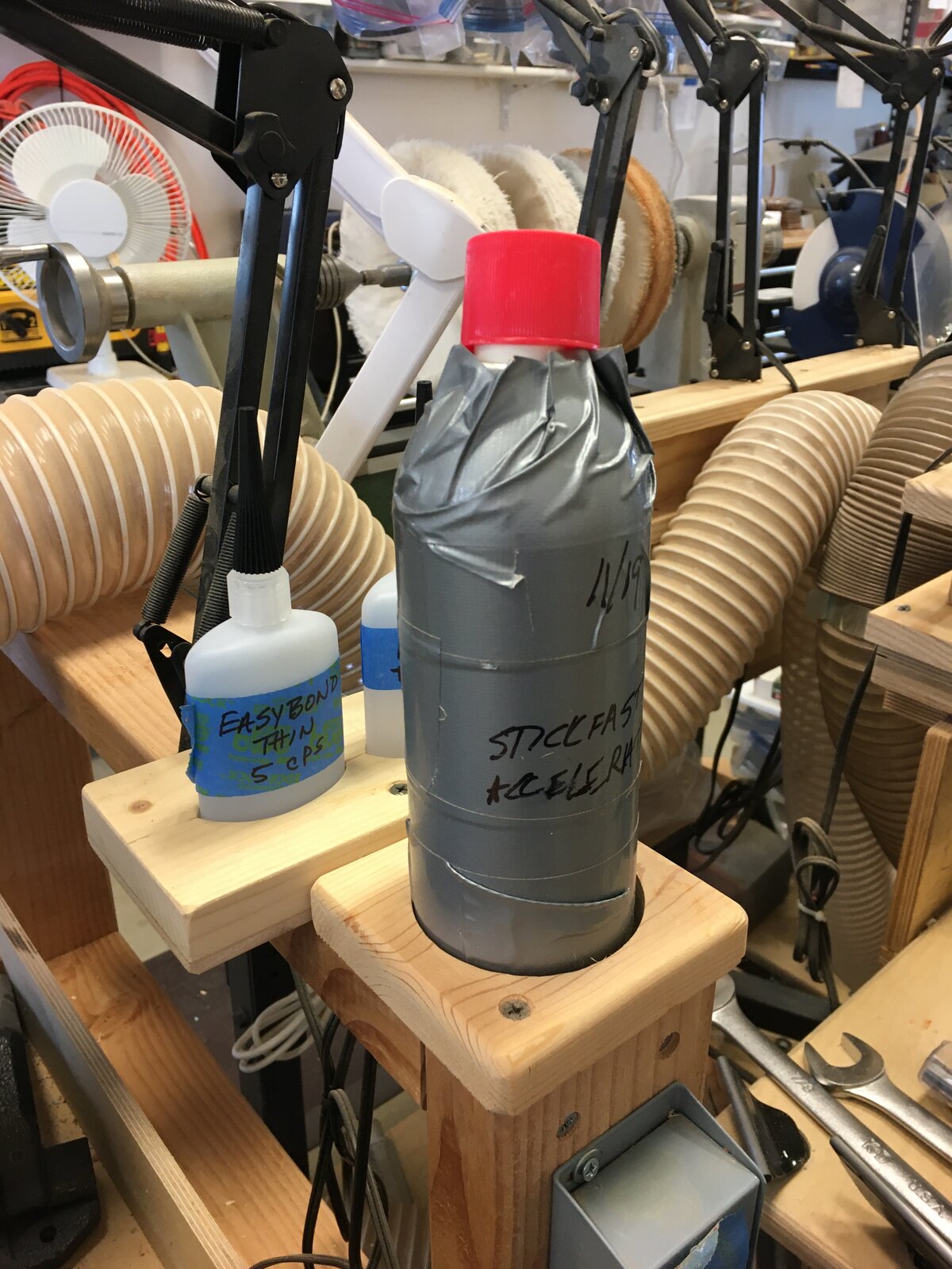

Thinking about your incident led me to cover my large StickFast accelerator can with duct tape; it is tougher than my flesh. Also note the stand I have for the accelerator and two bottles of CA near my finishing lathe. I buy 26 oz bottles and empty plastic containers and save a great deal of money.
Be well and stay safe.
