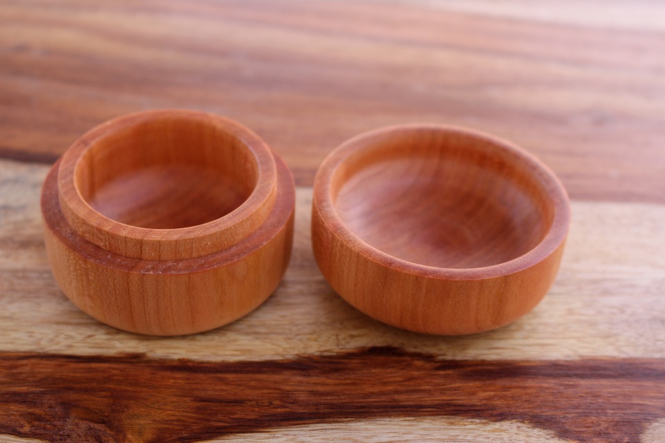

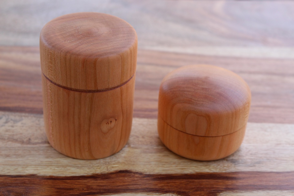

I recently started making these small lidded boxes. These are fun to make and you get to use a lot of turning techniques. Getting the correct friction fit was probably the most challenging part. I made these out of cherry. Walnut and maple are some other good choices. I also created a video for those who are interested:
Turning a Lidded Box Video
Please share any feedback on your experience with making these. Thanks!

This was excellent Steve. Thank you. I thought it was well-edited; excellent angles, resolution, instruction - I even liked the background music. It encouraged me to give it a try. What were the dimension of the unturned stock, please. Thank you.
Tony -- I'm almost positive it was 3 inch by 3 inch by 6 inch long. I probably should have put that in the video. Thanks for asking that question!

What gouge did you use for the inside of the lid and box? Bowl gouge? What exactly did you finish it with?
Excellent video. The camera work was outstanding! I have seen some on Youtube where the camera was used as a baton to conduct a symphony orchestra. The background music was pleasant but not distracting, to me, anyway. Thanks for posting it. BTW, I saved it as a Favorite. Trust that is OK with you?
I tried using my 3/8 bowl gouge but it was a little too big, so I used a small spindle gouge to hollow out the bowl area. Then a scraper to finish the bowl. The scraper is also used for the lid's inside to get that 90 degree fit with the bottom half. I'm glad you enjoyed the video! Feel free to share it or save it to your favorites.
