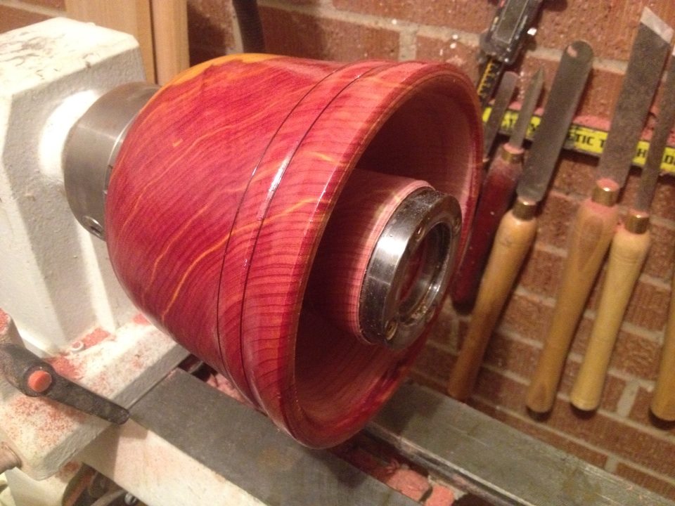

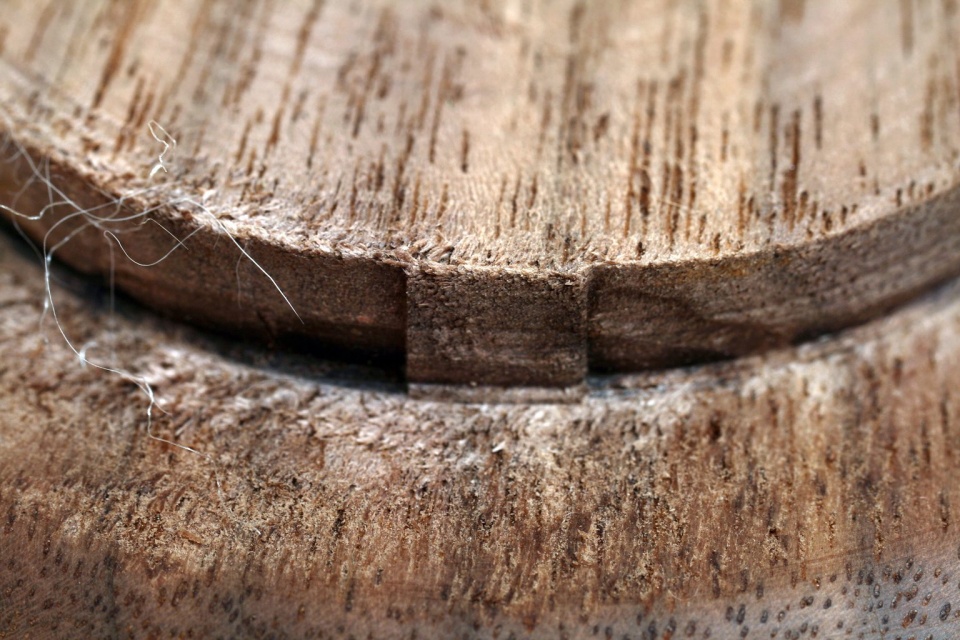

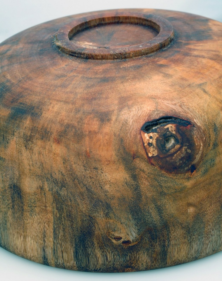

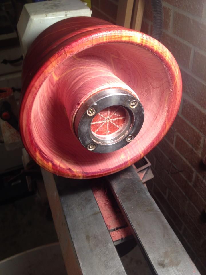

Innies.
attachment.php

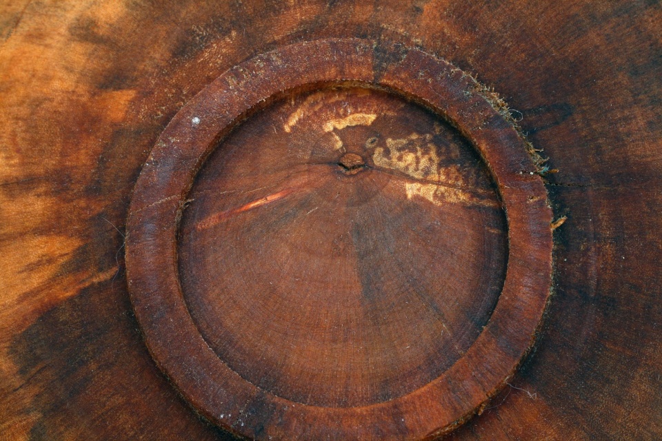

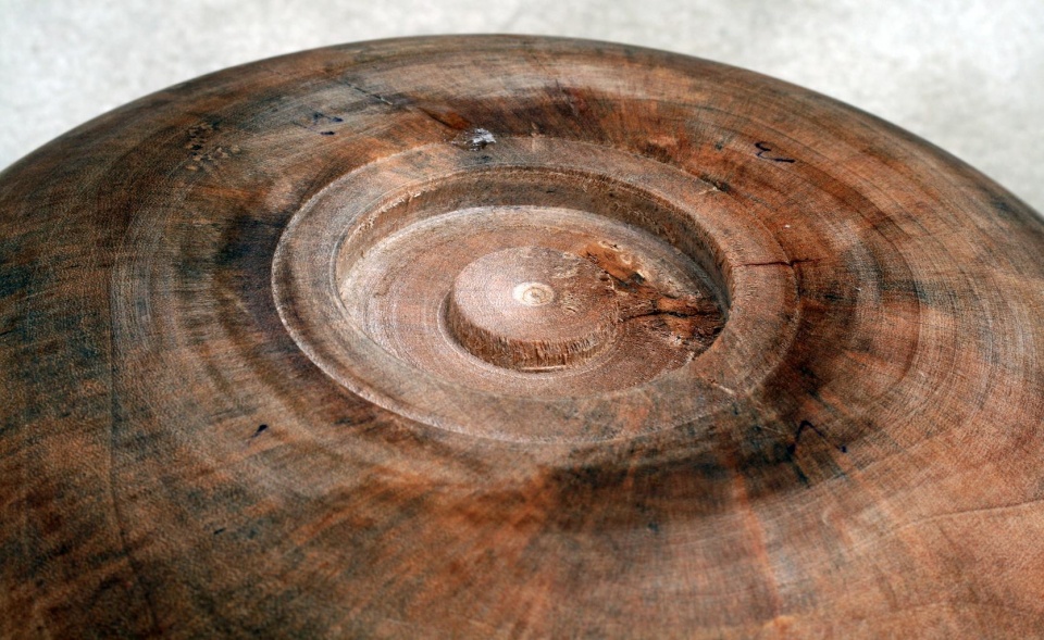

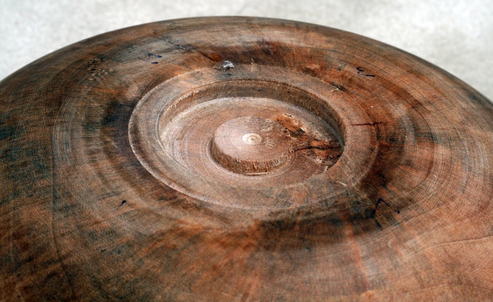

outies, just the right length.
attachment.php

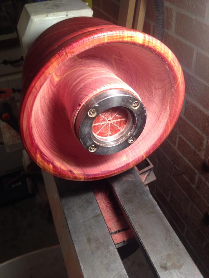

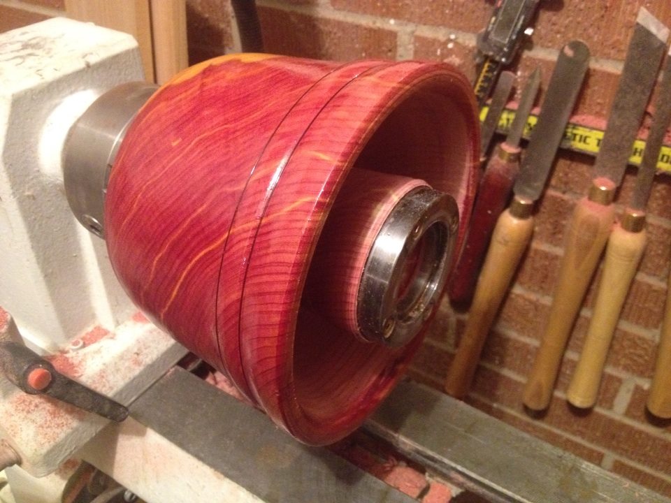

ring mounts (can be used on both sides fyi)
attachment.php

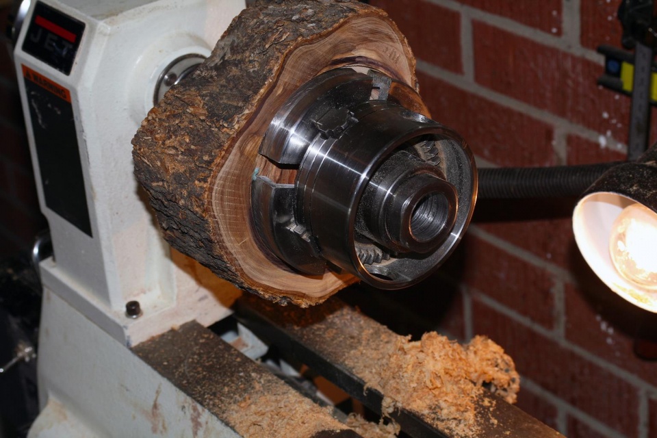

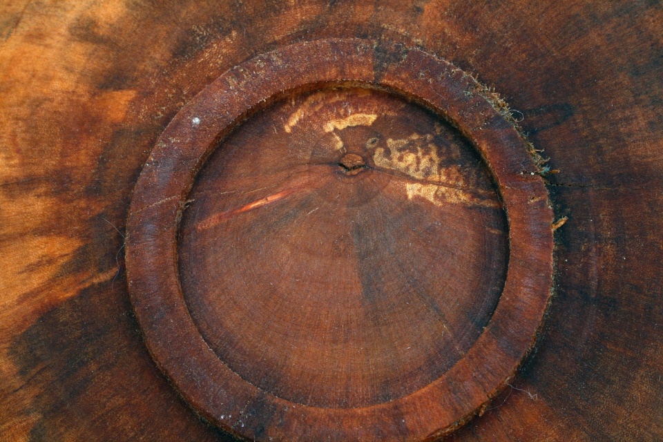

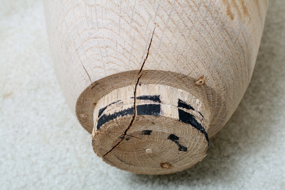

outties to thick on bad/problem areas.
attachment.php

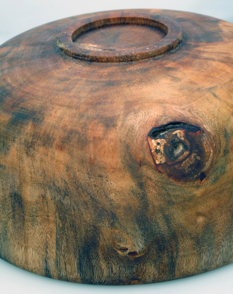

small outties in super good wood.
attachment.php
attachment.php

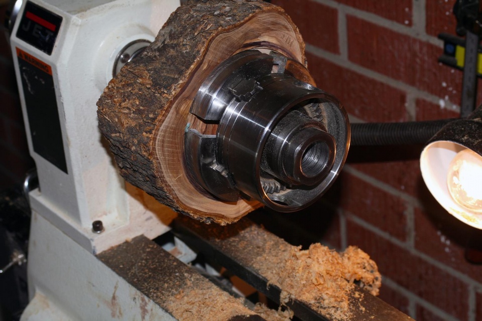

and lastly anywhere you can find room
attachment.php
