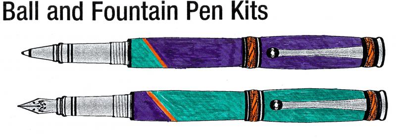

After gathering all my source materials I have started making my pens. Here is the concept for my pens. (Pretend that the orange is gold. It is the closest I could get with my marker set.) The green pen with purple highlight will be a Majestic and the purple pen with the green high light will be a Majestic Jr. Both kits are the 22k gold kits so that the brass between the two colors will tie in nicely with the pen. Neat idea or at least I think so. At least I thought so until I actually started to make them. The fact that I sketched these on an instruction sheet for the Majestic almost lead to a big error.

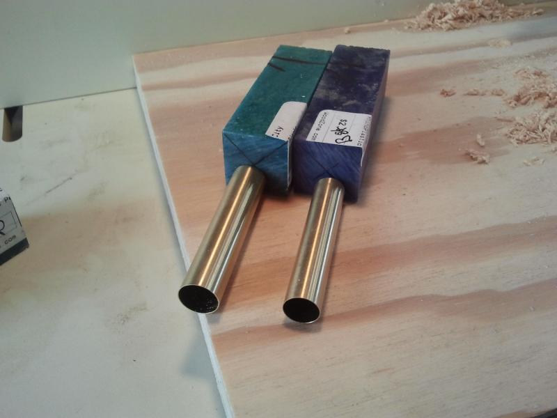

First Challenge

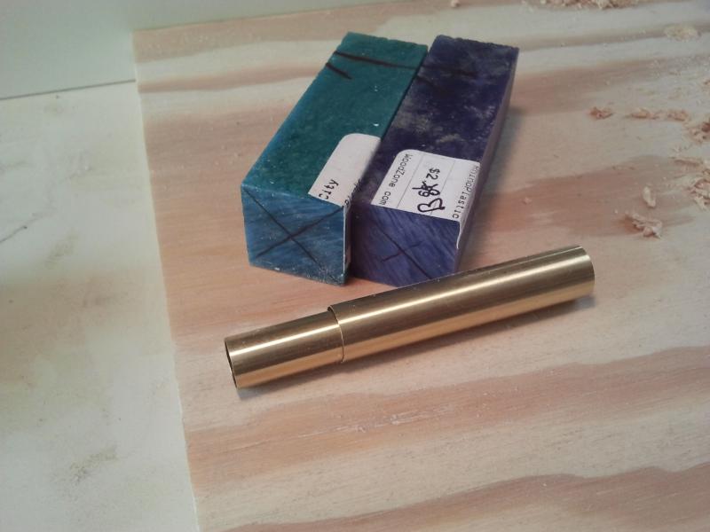

The first challenge came when I went to drill the bottom tubes. I was going to drill them and then cut the angles. I was then going to drill the brass separately and glue it all together on the pen tube. As I was setting up the drill press I got out the tubes to check to see how deep I needed to drill. At which point I noticed something that should have been painfully obvious from the get go - the tube diameters between the Majestic and the Majestic Jr. are not the same. Time to revise my drilling plan.

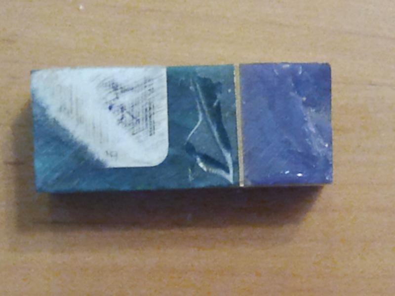

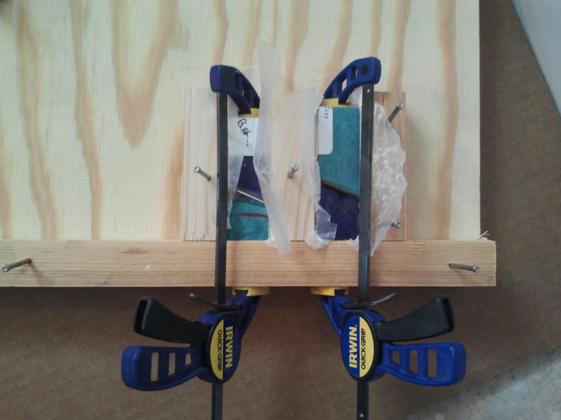

I decided that I would have to cut the blanks and the brass and glue them together and then drill. Based on the responses from a thread where I asked about drilling brass, this was not my preferred option but I didn't seem to have any choice. So I cut everything, sanded it a bit and got out the 5 min epoxy. Here are the blanks in a little jig I used to keep things aligned while the epoxy set.

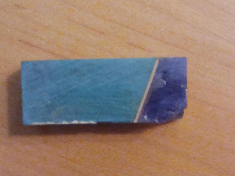

Second Challenge
The planks came out of the jig okay so off to the drill press. The Majestic Junior blank drilled perfectly - no problem at all. The Majestic blank blew out. Nuts. It split into three pieces so I got out the 5 minute epoxy again an glued everything back together. My plan at this point is to continue with these blanks. I will glue the tubes in and trim the blanks up flush and square and start turning. I will see if the epoxy joints hold and then shine the pens up on the buffing wheels. If things don't work out I will turn the blanks off of the tubes and start over but at least finishing these blanks will help me learn how to turn the brass insert and see how Rhino Plastic turns. Fortunately, I have spare blanks so if all goes bad I can start over with the hard earned knowledge that only failure seems to bring. Still, its a fun challenge for me so I am not complaining, just learning.

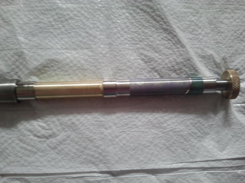

I finally started turning. We had a stretch of bad weather that kept me out of the shop. I started with the Majestic junior and all went well. I was cleaning up with my skew chisel and had a catch. I blew out the upper blank. Bummer. But I had anticipated a few problems so I had ordered a spare blank. A quick cut, drill and a touch of epoxy and I was ready to go again.

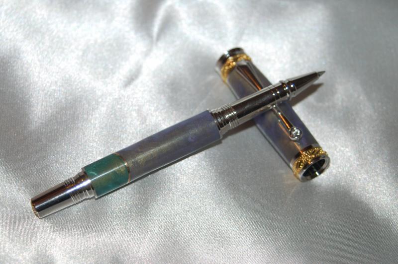

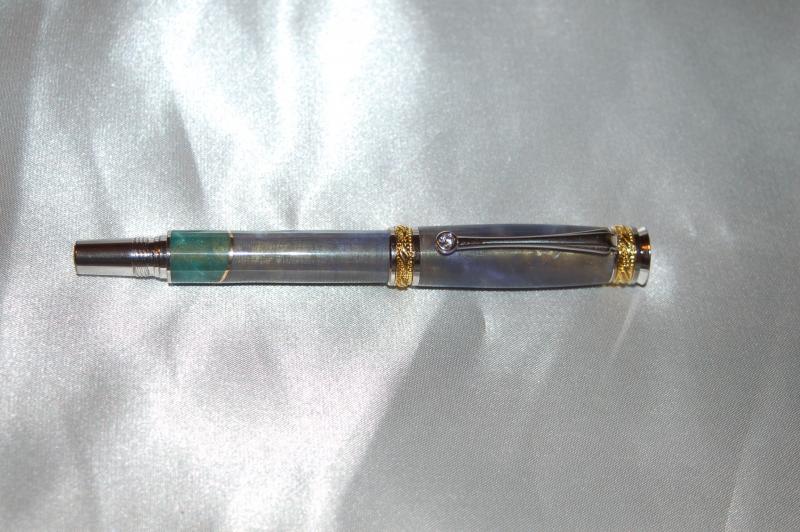

So here is the finished Majestic Junior. Since I was using a brass stripe I opted not to paint the barrels. I wont make that mistake again!
Comments and critique are welcome.

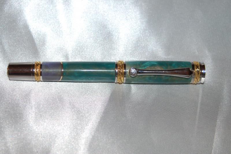

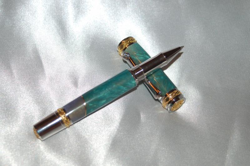

And here is how the Majestic turned out. I am also starting to learn a bit about photographing pens. Comments and critiques are welcome.

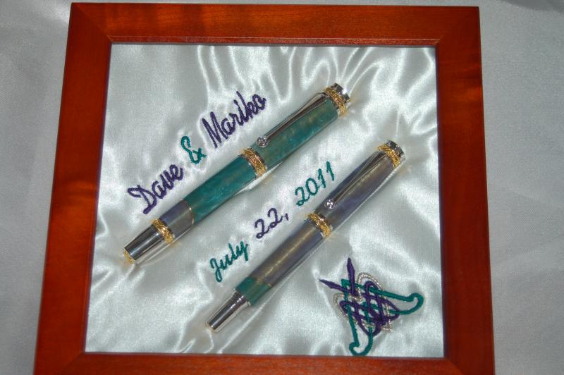

Finally, we needed a way to present the pens to the bride and groom. Since we did not engrave the pens, we came up with a nice presentation box. The box came from Penn State and the embroidery was accomplished by me lovely bride and my daughter. The colors of the wedding are amethyst purple and emerald green.
Overall, I am pleased with my very first attempt at a project of this scope. The pens are for my niece and her fiancee and they will love them (I hope). I learned a lot and still have a lot to learn.
