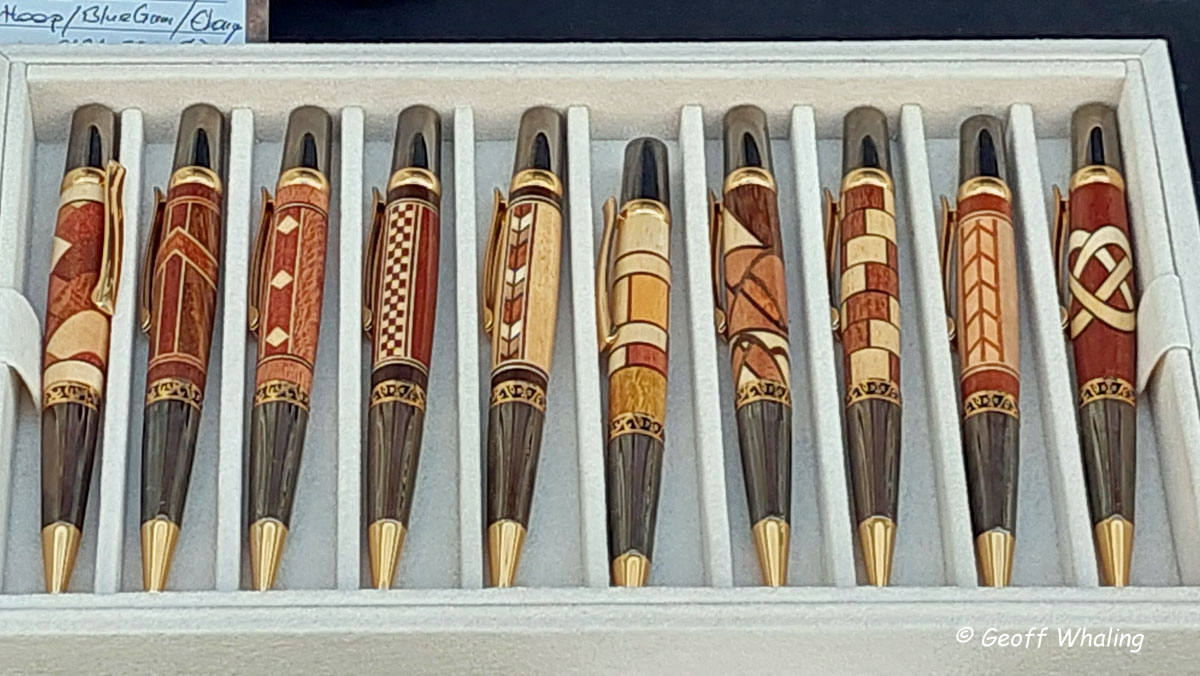

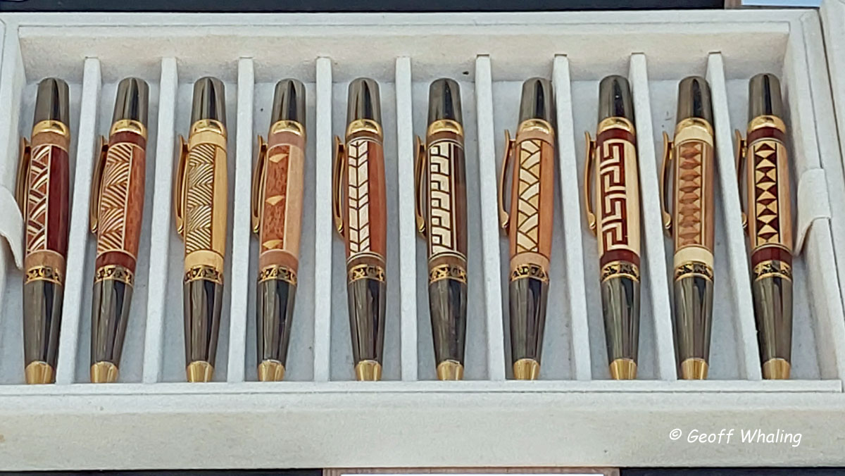

In Oz we have an annual symposium Turnfest, run by a private promoter, but due to COVID the 2020 -2022 events were cancelled. Whilst deciding what to place on the IG table I came to the realization of just how much my work had progressed in that four-year time span. I've literally made hundreds of short inlay banding blocks, and many more times that in blanks. Most are iterations of a design, with literally millions of possible combinations and permutations due to wood palette, material thickness, ..... It's a rabbit hole of black hole proportions.
After considered deliberation these are what I chose.
Very very nice segmenting. Precision on your designs. I like it better with just the 2 sides because you can spread the design out more and not have to cram into a 4 sided blank. When you do 4 sided it makes the pieces even smaller and then you get into danger of cutting yourself. Like what you are doing. May have to dip my toe into these type designs in the future. Thanks for showing and keep up the great work.
The success of 2 or 4 sided really is very dependent upon the canvas you have to play with. For the larger single and two tube pens it has potential.
I find for the typical Baron / Sedona etc and the Sierra / Gatsby or Elegant Beauty / Lucida style pens it becomes difficult to maintain sufficient precision centering the pattern on the tube/s. Even some 2-sided patterns do not look that great on the cap section of two tube pens and lose their impact. When you go to a 4-sided pattern blank any error in centering is accentuated and really stands out as a quite discernible taper in the "field" sections between the inlay.
