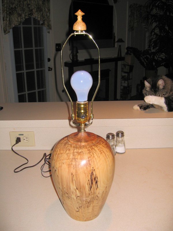

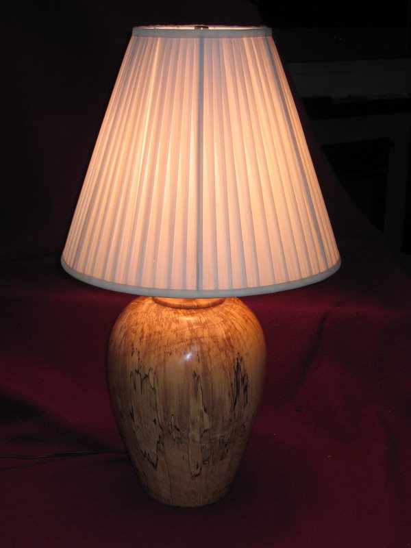

The lamp is completely hollowed out, then mounted with the hardware. I turned the base, then the lid from the same log.
I almost did not leave myself enough room to cut the lid. I was hitting the screws when parting it off!

The wood is spalted pecan, great ID job!
I still had a little left, so I am making a finial for the top from the same wood.
Dave, the tough part is getting the lid to fit correctly, and complement the shape of the hollowform.

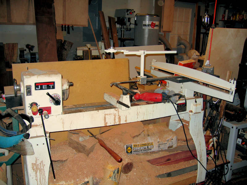

John, thats really nice. What is a good tool for hollowing the bulk of the wood? I've been playing with vases and things a little but I'm having a little trouble when I have to do kind of deep cuts.

Yes the shade is removable, and you can change it with others.
Xena is a little embarrassed by the lamp going topless!

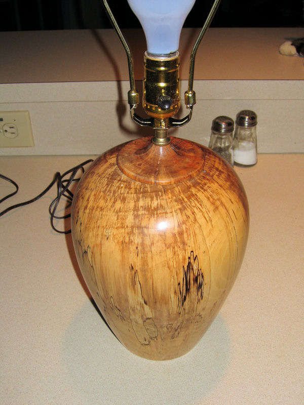

Gary. here is a closeup of the base.

Wayne & Dave, here is a picture of the one-off version of the hollowing tool I am working with. Dave, see the difference I am talking about?
<br />

Is that the Lyle Jamieson hollowing rig..?..or just a similiar?
If it is the Jamieson, how do you like it..?..I am in the process of purchasing one :)

No, this is a modified oneway rig. If you contact them, they will modify the 16" rig to fit a 14" lathe at no extra charge. The construction is extremely heavy, and comes with 4 heads. It is a breeze to use, once you have the rig level and set.
