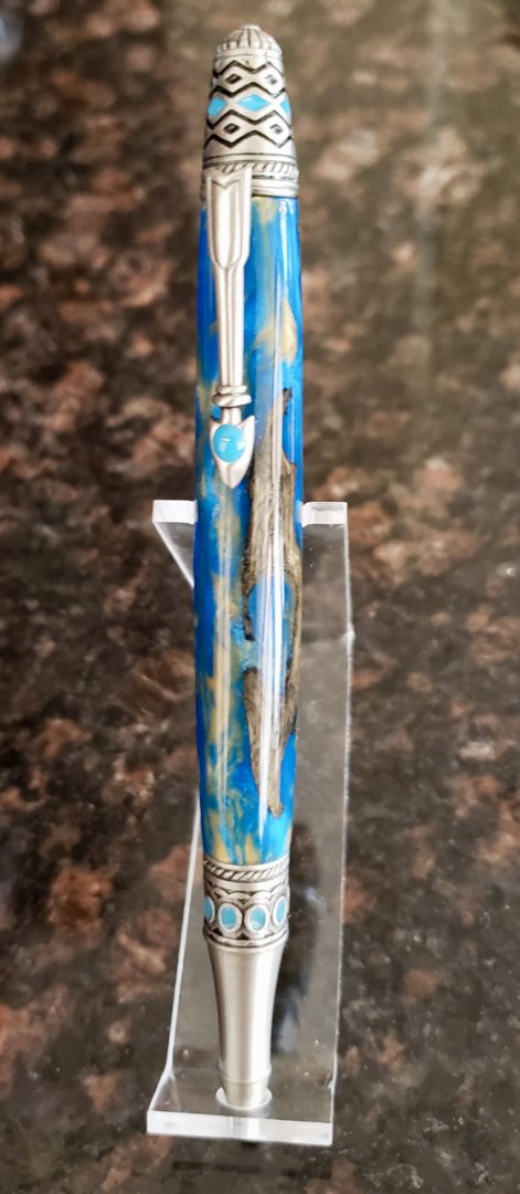

Turned a Pen using a Cholla cactus Blank
George883
Jan 22, 2019
294
Peoria, Arizona
I made several Cholla cactus and resin blanks and turned this Southwest Mesa kit this morning using one of my blanks.
TonyL
Mar 9, 2014
8,917
Georgia
Love both..have sold several SW Mesa kits. Do you mind if I ask you where you bought the blank?
George883
Jan 22, 2019
294
Peoria, Arizona
Hi Tony. I made the the blanks. I used Alumailte slow and added blue, gold and pewter to the Cholla and and had them in a pressure pot for 4 hours. I also stablized the Cholla before casting
