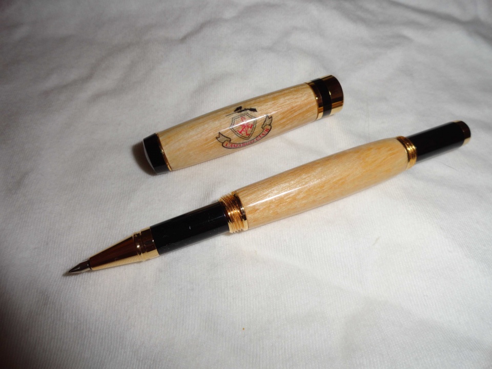

I just did a bunch of decals on Ash.
I cut out the decals very close to the border. I sanded to 12,000, put on my decal (printed with a color laser printer), hit it with a quick spray of shellac, and after it dried for a few minutes I added my CA finish. It looks like the decal was actually painted on the wood and there is no sign of the border.
Curious, did you spray the shellac with the lathe spinning?
