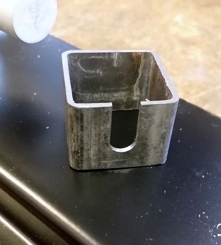

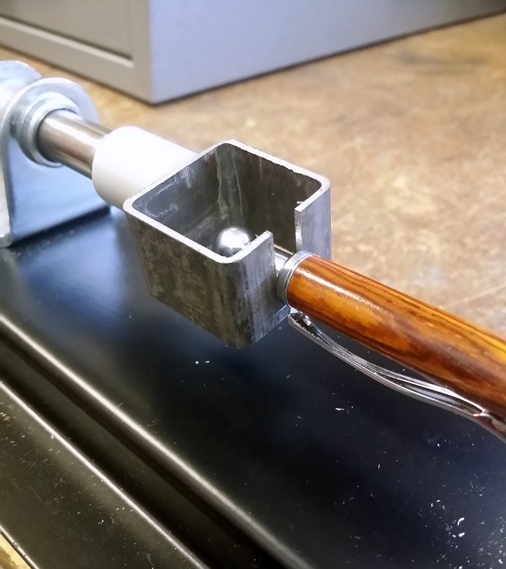

I purchased 5 Turbin pens from Berea. Being the type of individual who does not ask his wife for directions and does not read instructions I have a tendency to screw up frequently. The instructions specifically say not to press the transmission putting pressure on the push button. Soooo not paying attention to the caution I pressed in the tranny with pressure on the push button. Needless to say I ruined 2 pens. My Bad. I made a little jig to to circumvent the problem like the instructions say. The 3 remaining pens worked out fine. I really like the kit. It feels a little strange at first not seeing the refill nib extended but one overcomes that after using it a short while.

Pressure on the push button will jam the tranny and renders it useless. The instruction specifically warned about this but who read the instructions. It does not say what kind of jig or device can be made. It just says you have to make something to press on the shoulder below the button. Also the tranny assembly must be made first. Then the assembly must be pressed into the upper blank. The instructions must be followed precisely or it will not work. However upon finishing the pen it is very nice.

Your jig looks like a good solution. I made my first turbin pen this past week. Liked the "funkyness" of it. The click mechanism seems to be a little rough and the tip of the refill seems to get hung up on the rubber stylus. Hoping it works it's self out with a little use. Thanks for sharing.

Seems to me that the jig that Rockytime made and showed is an ideal tool to use when assembling the Turbin.
The metal assembly tube (jig) that comes with the Long Clicker has too big a bore (0.37") and would slip down too far, marring the top outer surface of the pen barrel and the clip of the Turbin. Good idea .. would require a smaller bore tube (jig) but see my next comment.
Making a hardwood sleeve would require sizing the hole extremely accurately and is probably not practical because, as Rockytime said, the bulb on the push button is only a few thousands smaller than the top shoulder (boss) of the pen. I say this even though the Turbin assembly instructions recommend this method (although they don't say how to make the "press block" or give necessary sizes).
