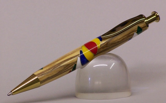

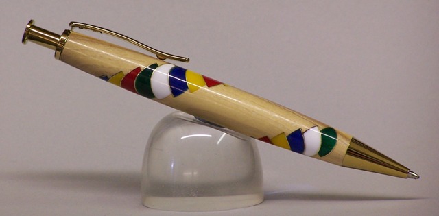

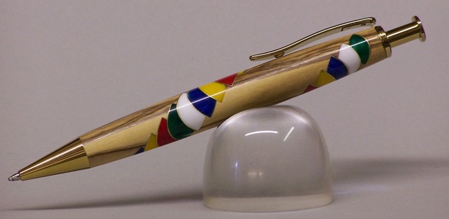

I was working in Tunisia ( North Africa ) last week and two things stood out......
The first was, like most African countries, is the use of very bright colours they use to decorate just about everything. The other thing that really amazed me was the incredible amount of Olive trees. The groves stretch for hundreds and hundreds of miles across the arid landscape. I took three flights and a 6 1/2 hr train journey while there. The groves just dissapear over the horizon. Anyway, I bought an olivewood board ( think it was for cheese ) and this is what I came up with. The scallops are edged with brass. I changed the direction from the middle. I'm pretty pleased how it turned out and SWMBO loves it:biggrin:

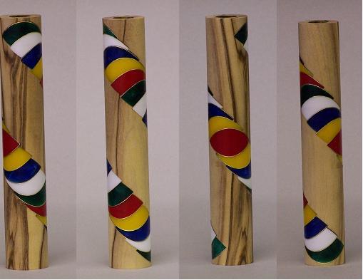

Very nice. Great effect, now you want to tell us how you did it?
Hans, it was actually easier than you might think. The only tricky part was changing the direction.
I used a compound table over the lathe bed. I mounted a router on the table so that the cutter would pass over the blank. The router was mounted at 45deg with a wide straight bit ( I just needed the 90 deg corner and pure point bits are too exspensive )
There are 19 scallops. 10 is the middle red one. From one end I just cut the first groove and glued in the piece of pr. Next just index the blank 1/12th rev. Advance the table for the next cut and so on until the first 9 were done. The brass was pre- glued to each piece before they were set in.
Then I carefully advanced the index on the lathe to cut the 19th groove and likewise advanced the compound table to suit. It was a simple case of working backwards until I ended up back in the middle to do the 10th cut.
Only the 10th one has brass on both edges. I did draw it out first and work out how much to index and move the table so that the pattern would fit in the blank.:biggrin: Easy huh??:biggrin:
