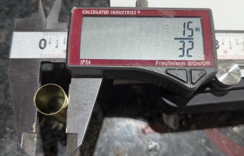

Measure the outer diameter of the tube itself. For example here's a 15/32 tube I had on top of the work pile.
