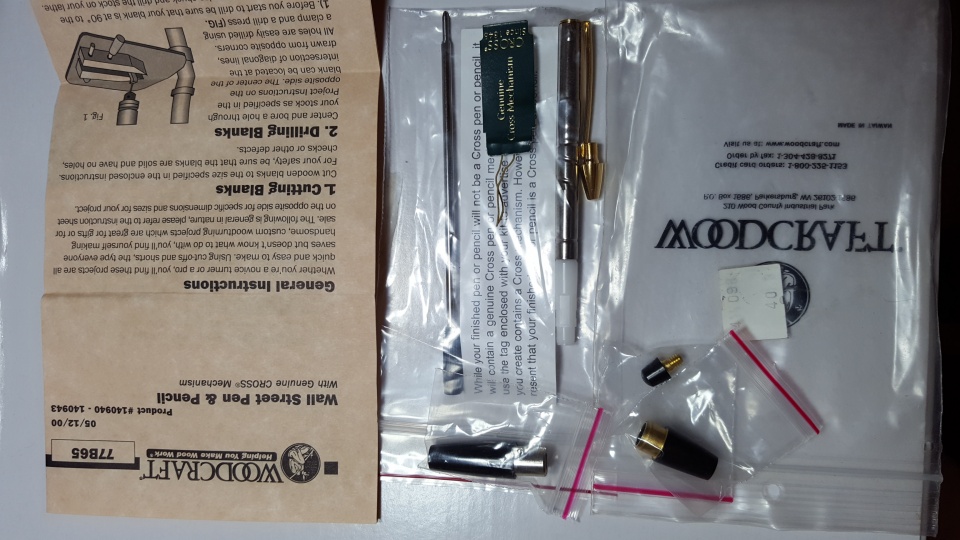

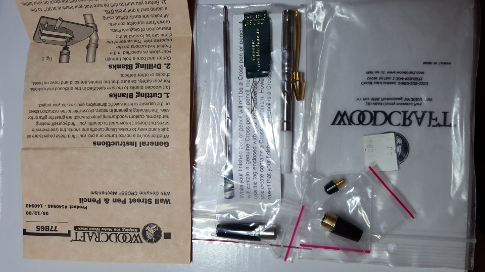

Thank you ed.
Here is a picture of the kit (I don't see any part number on it).
Thank you
Sammy

JP,
The instruction sheet with these pens/pencil kit are dated back to 2000 & 2011 (correction: 2000 & 2002). I guess they don't sell them or replacements parts for them.
Thanks for checking
Sammy
That is the original wall Street and it sported a genuine cross mechanism. I made lots of them in the early 2000's. I may have a tube. I will look tomorrow.
CSUSA had it later but called it the broker if I recall.
Do a good turn daily!
Don
Gentlemen,
This number is the instruction sheet to these Wall Street Pens/pencil kit. It is NOT the kit number as I stated in first post of this thread.
Thank you
Sammy
Not sure what you are saying but that is the kit number to those old style Wall street kits. That is what they went by when sold at Woodcraft. The very first link I provided is an older thread about those kits and in it there is the dimensions for the parts and bushings. You will probably have to turn between centers. As someone mentioned they were also sold under the name Broker kits at CSUSA and I supplied those instructions as well. I will do a further search for older threads for you.

Sammy, if you look just under- well since it is upside down :biggrin: Look just above the instruction number the product number is on there.:wink::wink:
JT,
As you can tell, I am a pre-beginner but I think JP is correct, the product number/s is just below the 77B65 in your 2nd link. May be I should be looking for these products numbers instead of the 77B65.
I will try to see what I get :)
thank you guys for taking the time to help me.
Sammy

Sammy that is why I tried to help. Maybe JP is right about that number. There maybe some members here that may still have a few of those kits. If you are just looking for the tubes maybe they can tell you the size. I was hoping that it was in the instructions too and that is why a linked both sources. Good luck.
According to the chart in the library the woodcraft wall street I twist pen uses a .358diam. by 3" length tube with a .335 diam. bushing. by .420 large diam. A drill bit "U"
