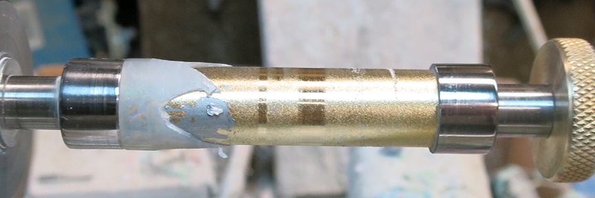

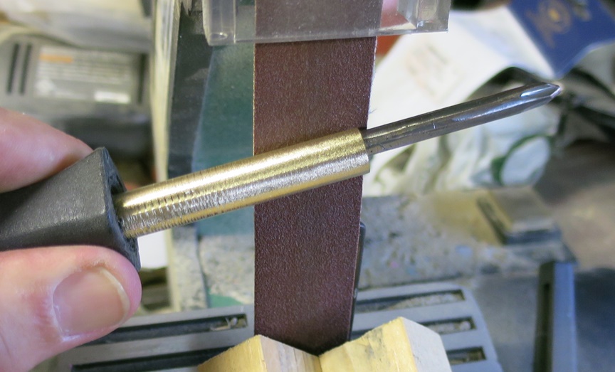

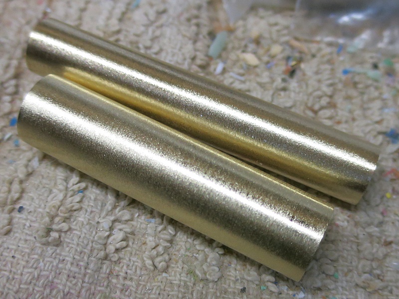

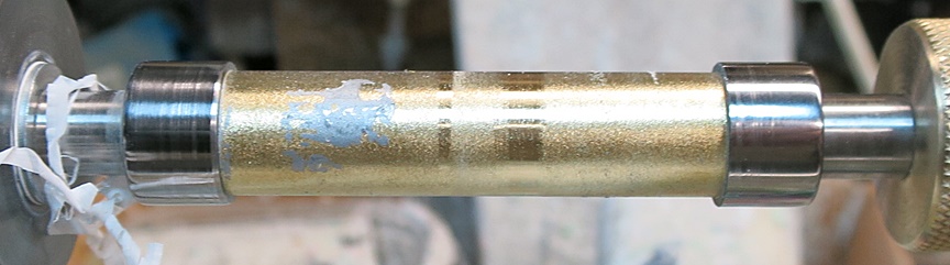

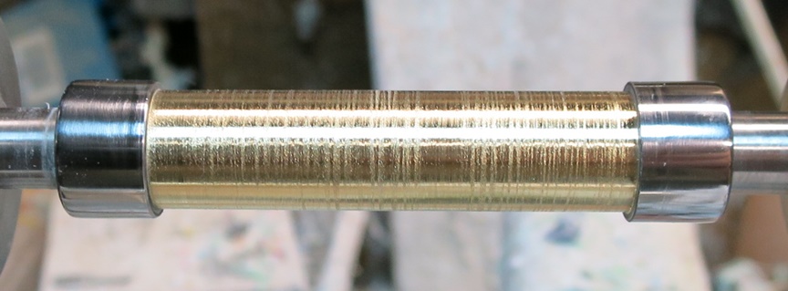

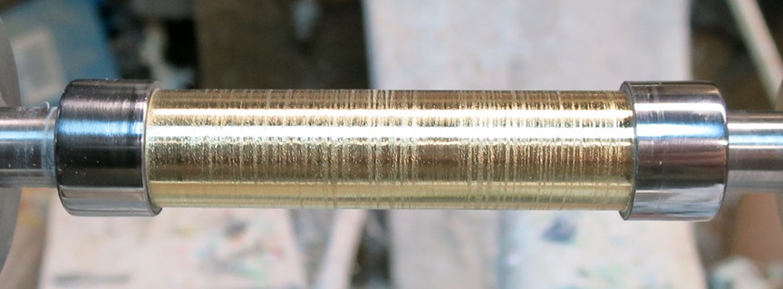

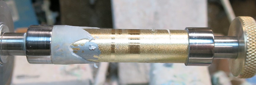

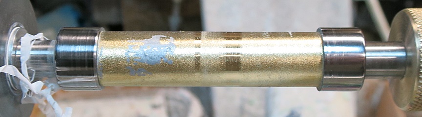

Well, I would have just turned off the offensive blank (yes, I've done it more often then I'd like to admit) and cleaned up the tube.
Since PSI sells the Gatsby, I would check them out.
Regards,
Michael
I believe the Gatsby uses the same tube as the Sierra (Berea kit, from many suppliers), and the same tube as the Mesa (from Woodturningz.com)
It is 0.41 inch diameter and 2.21 inch long for the twist version; about 0.2 inch longer for the click version.

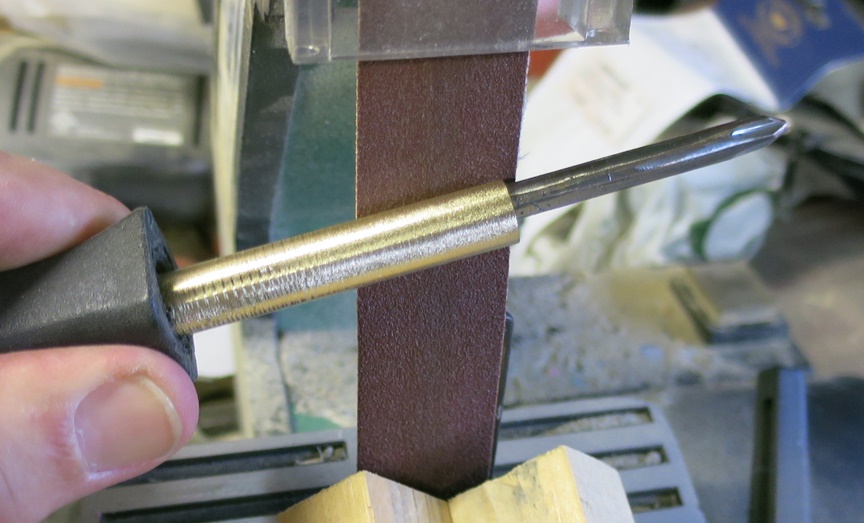

It's easy to do. Don't ask me how I know.
