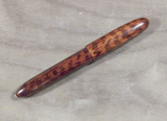

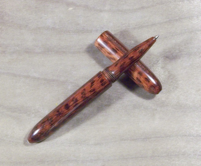

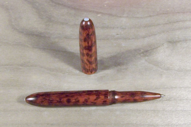

Hi all!
Somebody asked me to make a ballpoint pen in snakewood. I have not always been lucky with this wood, you know it loves to crack. I think he main reason is the tube and the metallic parts that expand with the heat of the hand. So I just made one without any snug-fit metal parts: no tube, no tranny, no finial, no CB. I only used the refill in fact, hard to do without... :wink:
I already made snakewood fountain pens this way, I had no crack after intesive use, so I have good confidence. :biggrin:

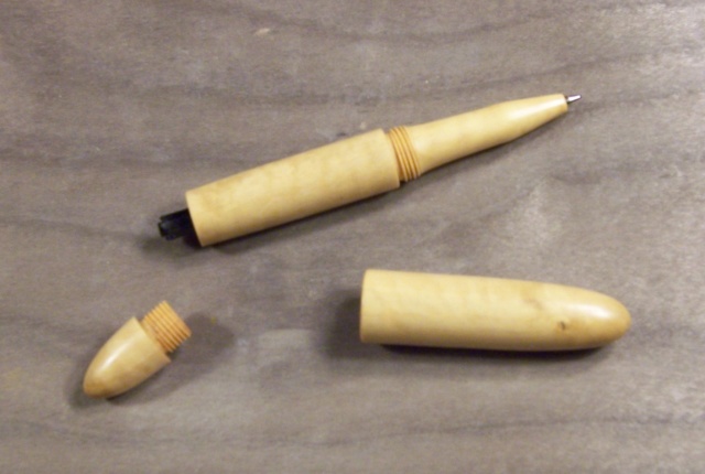

I made a prototype in boxwood with the Parker refill that could be put in and taken out from the upper part of the barrel. Some details were not to my taste,
so I made a second one that was better:

So I could go. Gosh, I love this timber: :rolleyes:
C&c's welcome!

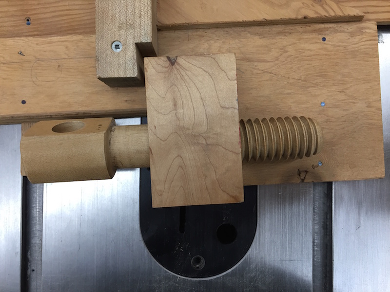

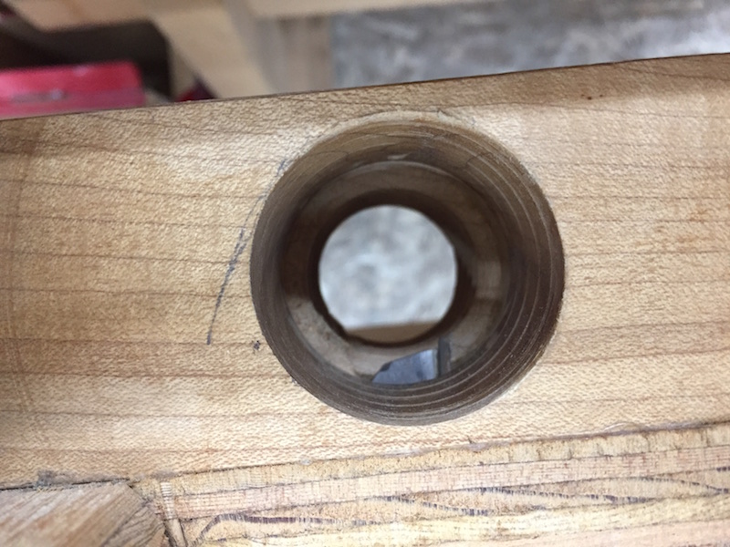

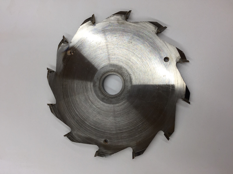

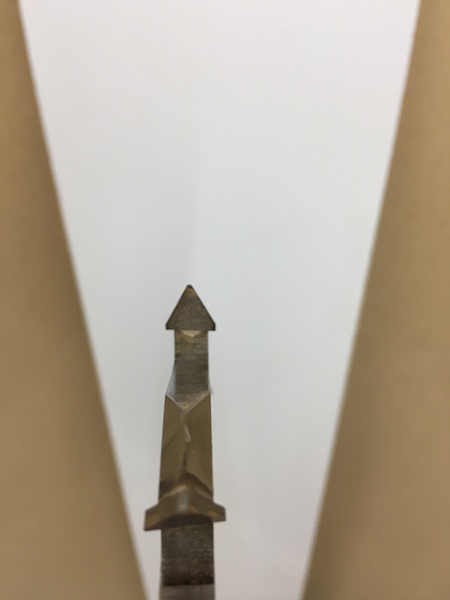

I've seen thread cutting done that way for lathe turned boxes for years but never thought of applying it to a pen. Sometimes it just takes another person to nudge us in a new direction to adapt something for our application. My father had the ability to see new ways to do things. He used to cut wood threads with a table saw and a special blade I had made for him. Used it for clamps and bench screws. He even cut a 4" diameter one once just to see if he could.
